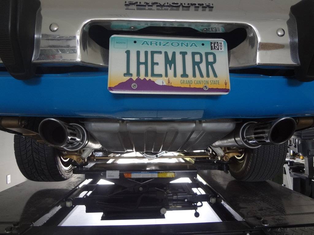

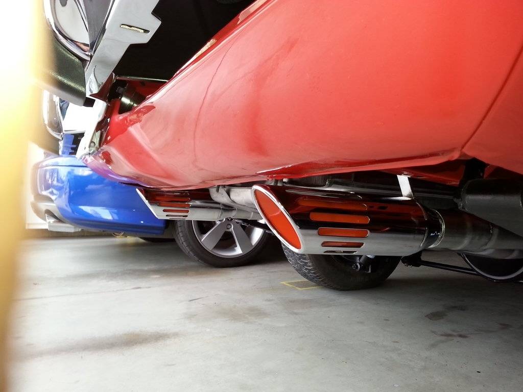

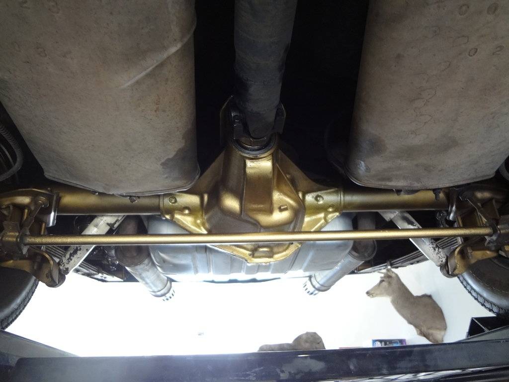

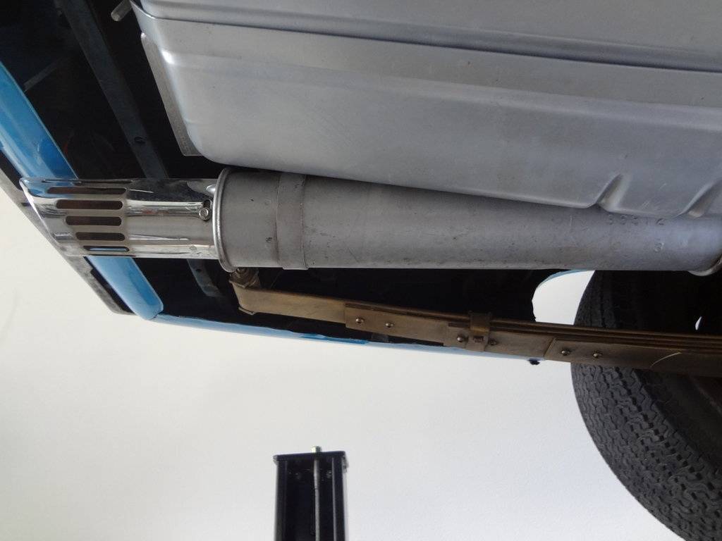

My 73 Roadrunner is 2.5inch TTI headers and exhaust, and I used the factory machine gun tips, but I had to have a step down on the end of the pipe to 2.25 for the tips.
Here is what it looks like.

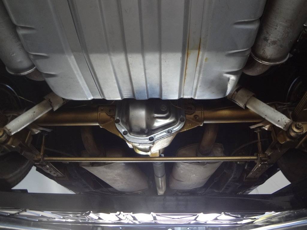

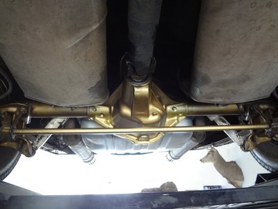

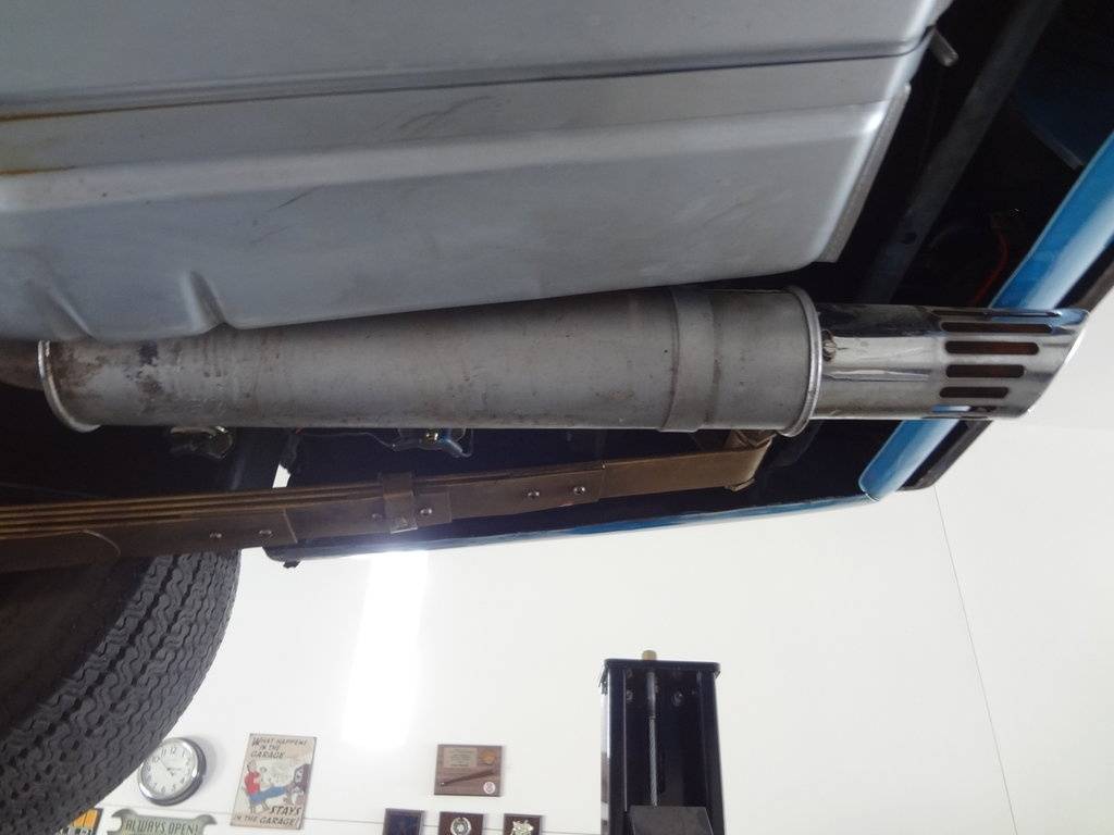

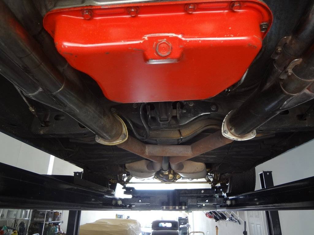

I have 2" tube headers with a 3.5" collector on the Hemi going to the original exhaust for my 73 RR GTX. I am running original pipes, mufflers, resonators and exhaust (machine gun) tips.
But since my exhaust system from the headers back is 44 years old its time to replace.
It's coincidental that you inquired in installing an Accurate Exhaust system. I just bought the complete 71 Hemi B-Body set to replace my original exhaust on my 73. So I guess in the near future I will be able to let you know how it goes. I received my exhaust kit last week. It has been so hot here in Laughlin (111-123 degrees) the last couple of weeks I can't get the motivation to get out in the garage to jockey cars around to get the RR on the lift to start on the exhaust.
Also I have not made up my mind if I'm going to use the repro resonators and exhaust tips or try to reuse my originals since they appear in such great shape. (No outside rust or damage.) The original chrome exhaust tips look brand new. (any opinions,)
