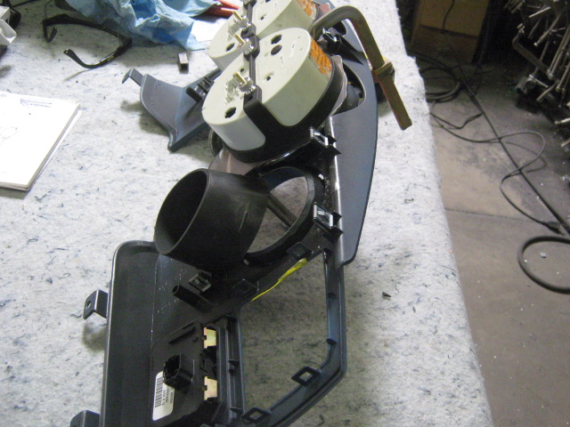

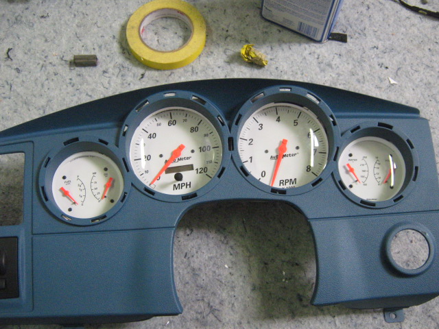

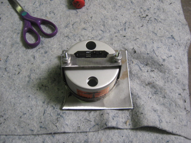

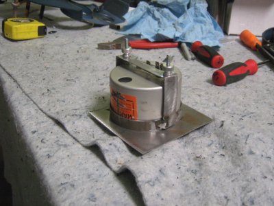

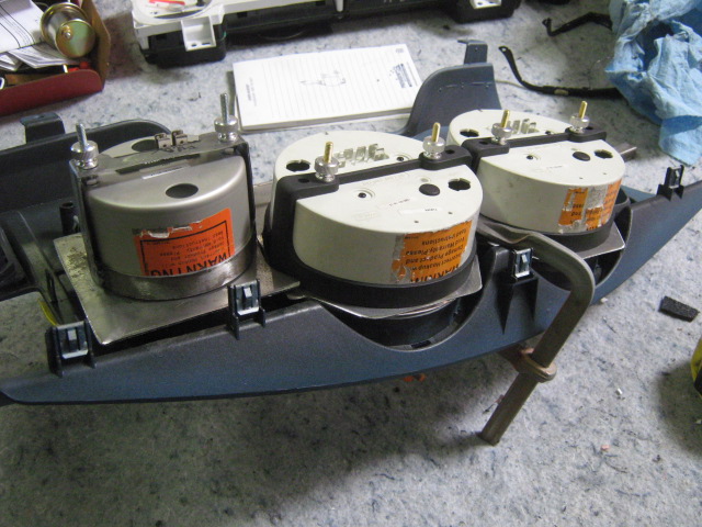

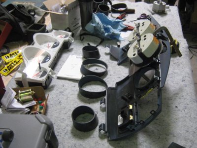

Well, I got all the stuff to redo the ECM. I also have to change the entire instrument panel so I bought a set of Autometer Arctic white gauges. Here is what I did this weekend. I had to make an attachment ring for each of the smaller gauges, trim the depth of the original "tubes" and make a mounting plate, then make some ABS spacers that I glued to the original ccover so I could use sheet metal screws to hold the new plate on. I still have to line them up but I need to repaint it first.So they value the assembled car at just above the price of parts and have little to no value for 2000 hours labor.... why not jut value it at $50,000 so it cost you 200k to build the car.... if there going to slap you in the face at least feel it... but assessing you're labor for a dollar is what they were aiming for... where's there reasoning ? And who is the governing sanction that regulates them? Or is that them also?Still have not added up all the costs but I did have the car appraised by Auto Appraisal Network and it came back a WHOPPING $152,500!! I am probably close to that but I don't believe I'm over it, unless you want to figure the cost of my time. I did not track my own hours but I have to have 1500-2000 hours over 6 years. If I was PAYING for that time I am sure it would exceed 100k just in that. Hagerty got a copy of that IMMEDIATELY with a request to increase agreed upon value!
