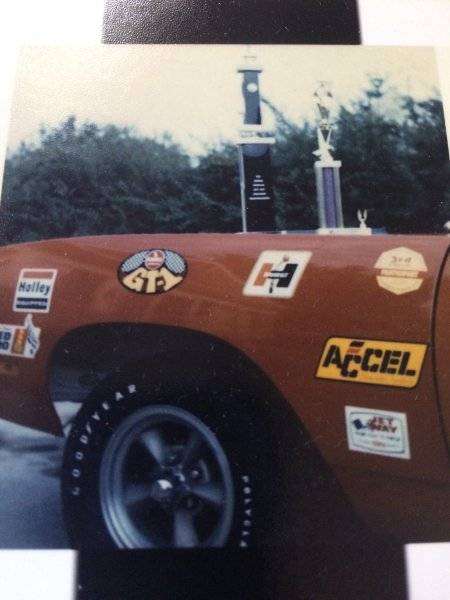

The year is 1970, you want to win races and you have a hot new Mopar. What’s a feller to do but raise the torsion bars all the way up to transfer weight to the rear wheels. Must’ve worked, this car was clicking off times in the 12:30, completely as delivered, except of course for Dads secret weapon. So, I believe this pic shows the maximum lift you can achieve, looks to be about 3”. Stock ride height also shown.
The higher you jack the front end, the less caster that you have. It actually goes negative about 2 inches over stock height with stock UCA bushings.
if you have good rubber and road surface having the front end stay put on launch is quickest!all that lifting and twisting is using horsepower! I have a video of Bella launching [but won't post it for legality}! it's a straight lurch forward, not up! I broke the torsion bars on my first 66 from hard launchs and severe loading on the 1-2 shift. the bumper was only an inch off the ground after the bars broke and I tried driving it like that and it was quicker to 50ft. but the bumper was abused on the 1-2 shift!never tried airing up the front tires more!

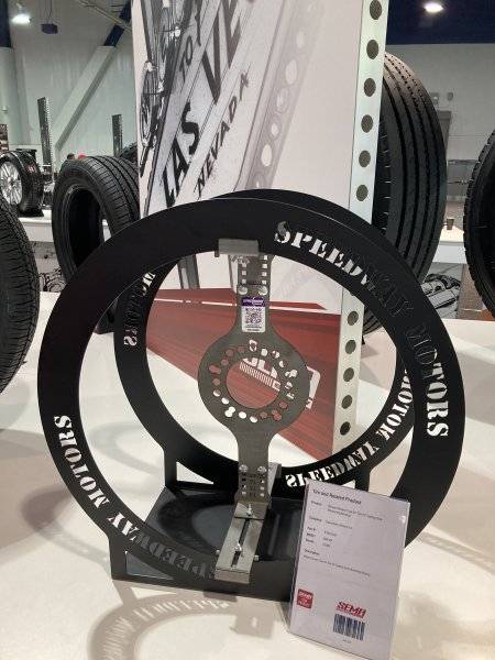

When I got the car it had 15x8 Welds and 265/50-15 Gatorbacks on all 4 corners. Lots of clearance. I put 275/60-16 rear and 235/60-15 front using Coopers. Still loads of clearance. I'm going to try for a 315/30 or 35 up front and 325-355 35 or 40 on the rears using 18's on all four corners, may have to do 19 on the back for tire sizing. I'm currently getting ready to cut the tubs to widen them after moving the springs inboard. I bought this tool from Speedway so I can mount up a tire, determine offset etc, check clearance etc before I plop down money on wheels and tires. My tire size finalizing will get determined by price, availability and a couple of other factors. Want the same brand and type on all four corners, don't want a tire thats only for one vehicle which makes it expensive and hard to find.
