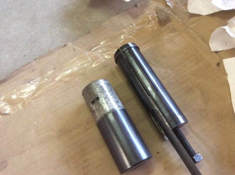

    Rebuild trans did they change tailshaft bushing? Driveshaft vibration started at 3000 rpm. Removed bushing .013 clearance. tb1.jpg

      Nope. I'm going to build another trans and see if that fixes it. A few years ago, well many years. I did a burnout and cracked the tail shaft. It may have bent the output shaft.
      I'll see when it comes apart.
      Doug

      Tolerance on pinion angle is 1/2 degree. Look at the tailshaft bushing again. I have written extensively on this through another member on moparts. If you have any perceptible up and down motion it will grumble (make that sound). I made my own tail shaft bushings that proved successful.
