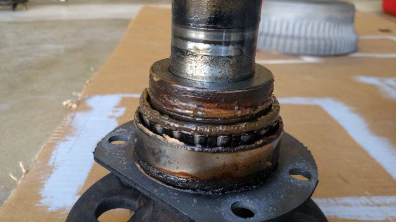

I would pull the axles anyway and just check things out. I decided to pull mine just to check them and found this.
Fortunately I have already replaced both my outer wheel bearings in the rear axle awhile back. The axle isn't coming apart any time soon. If it ain't broken don't fix it. Exploratory surgery even in his case would likely just be a waste of money because this thing isn't bad.
