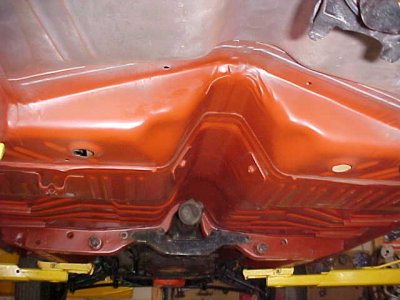

Ok first please know I am NOT a Body man. I can put panils in and have always painted our race cars but thats it.
Now I want to paint the under side and trunk on my 69 runner and it is mostly Bair metal . The floor pans from the rear forward are painted with an orange prime sealer ?
Do I need to by the expensive primer ? I was told by an old guy to use the paint fro Tracor supply store ?
Its like Rustolium ?? Single stage enamel. I used it for years on our dirt cars but that a diferent story.
Any help would be good as I am on a tight budget as with most of us !
But I am looking to you guys for the best input. I have both the older style Binks guns and a new HPLV .
Well, if it were my car, I'd be more concerned with what works rather than cost. Yes, I know, we all have to watch our coin but skimping on the underside is guaranteed to bite you.
Id scuff up the bare steel with 80 grit paper and give it three good coats of epoxy primer. SPI makes and excellent product and it's reasonable as well.
http://www.southernpolyurethanes.com/
Be sure to clean the surface with a wax and grease remover first and pay close attention to the re-coat window. From there you can paint it if you like or just leave it in epoxy.
As far as the orange/red primer goes - do you know what it is ? Removing it is the only way to be assured of success, however, I realize it's quite the task. You could tempt fate and scuff it up and epoxy over it and see what happens.
Thank you for the info. I am thinking it is an sealer/primer. I understand the cost verse's quality deal . I was just throwing it out there to get input . I will look into there products . Thank you for the help.
Not being a paint guy by trade what would be or would I need ? Thay list a couple diferent primers .
Thanks Eric ! I was thinking I needid a gallon ? I also wanted to do the inside of the trunk so 2 quarts ?
Ok looks like we have a winner !
Now it needs to get warm out so I can roll with it.
Thanks guy !!!
