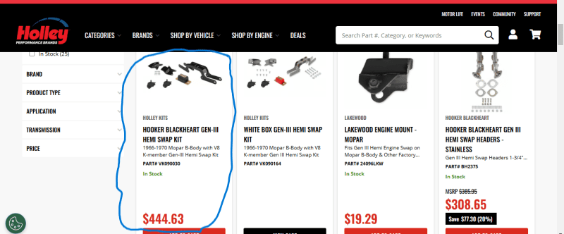

The engine mount brackets and transmission crossmember from Holley....

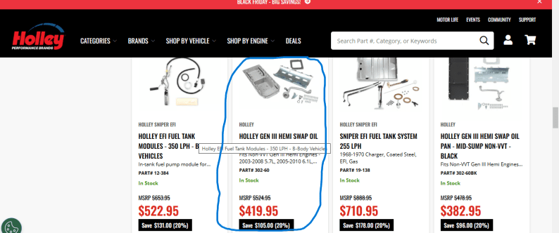

and so is the front end accessory drive...add in the costs for those:
That alone makes it a deal breaker. NO way I'd pay $3400 + for all of this stuff. I'm at $4300 just to get the engine in place and I still don't have a computer to run it or a fuel system to feed it and the engine internals have not been touched. No wonder people go BIG when they do this swap....They must figure that if they're spending $6000 before ever touching the inside of the engine, they might as well go all the way and use a new crate engine.

Oil pan is rear sump. That won't work with stock based suspension.
