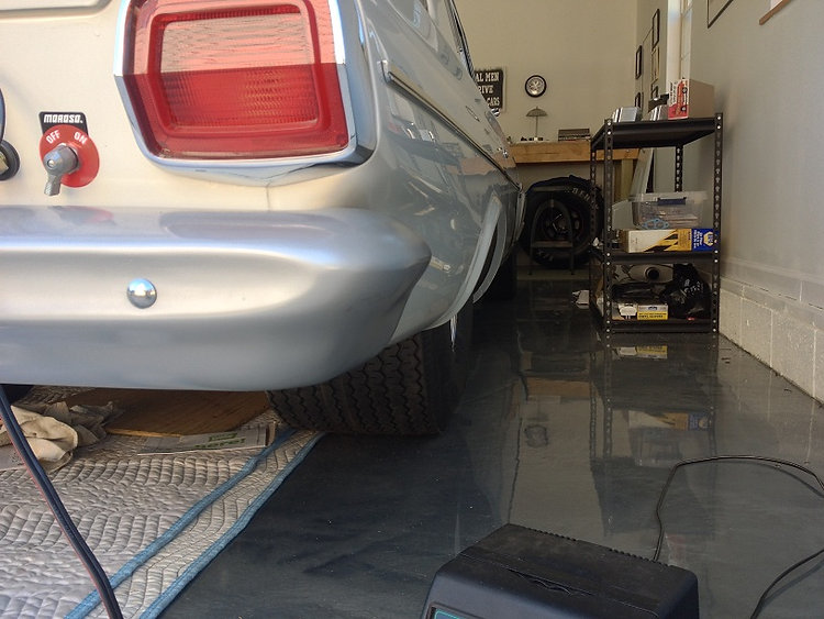

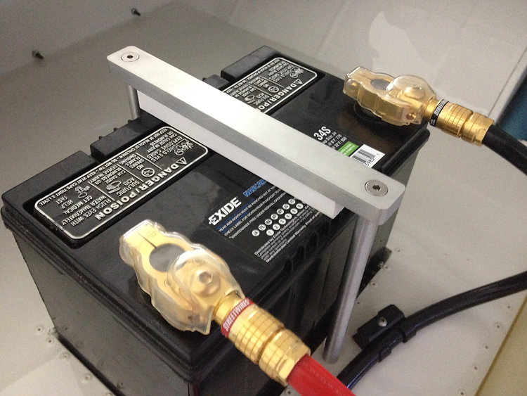

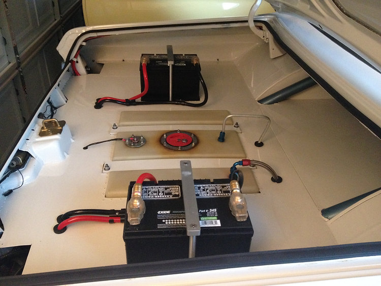

That looks great, nice work!View attachment 361863 View attachment 361864 View attachment 361865 View attachment 361866 This is my partially wired trunk. The 1/0 positive cable runs up the left side under the wiring chase cover over the rocker panel and is inside a length of wire loom for extra protection. I am using the body for a ground also. It has worked in 2 of my other cars. My battery switch as you can see is behind the license plate. The large terminal module is a Powercell for the Infinity Box wiring system. The small box below that is the freq drive for the A-1000 in the fuel cell.
