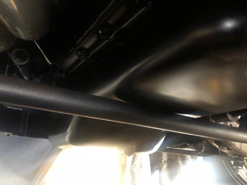

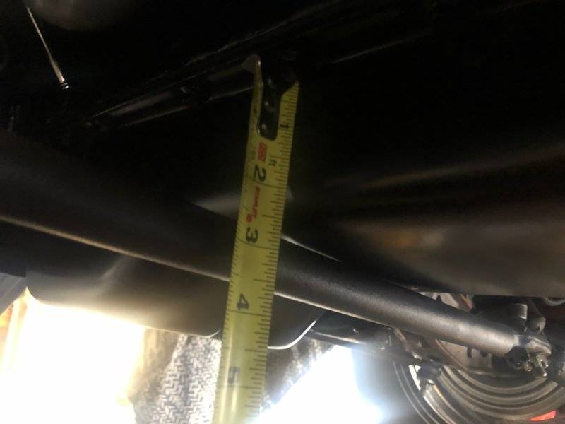

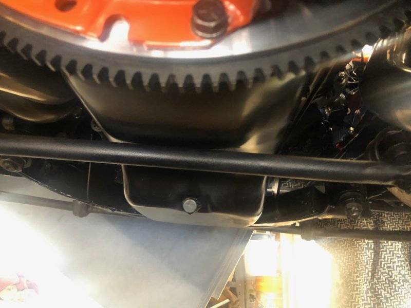

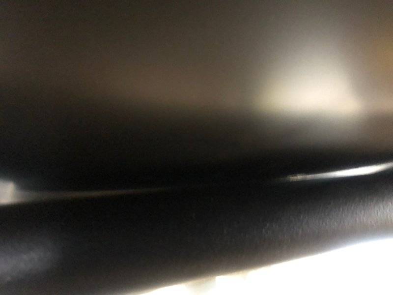

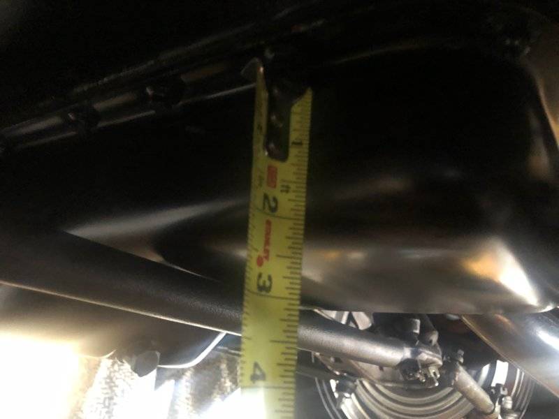

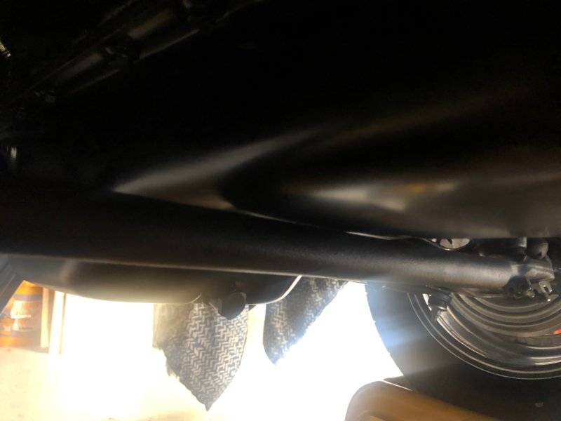

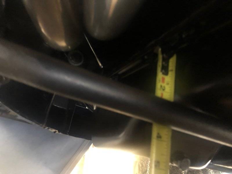

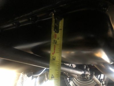

Hey you all, hope you are still watching this tread....I have some photos of the issue. Ive attempted to show the depth of the pan, it is shallower at the back and deepens as it moves forward. At about the 1/2 way point the steering bar rubs. I need to adjust this but not sure how. Do I need to replace the pan? thanks for your input.

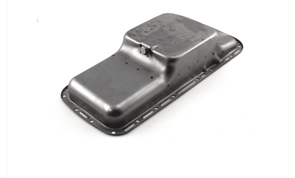

I'm not sure what that pan is for, definitely an aftermarket one but yeah, I would swap it out. You'll need to find an oil pan like this one. Notice how yours has a tapered part that slopes down as it moves rearward, vs the flat style like the factory is?
I guess you could always clearance your existing pan by dimpling it around the steering link and I doubt itd cause an issue but you're best bet is the correct pan.
I would rather do it right the have to re-do it! I'm going to replace the pan. I worked on the car some today...man what a project. I have Doug's headers and the LH side of the engine compartment is very tight. I have clearance issues just about every where. I have to change the plug wires from a straight on to a 90 degree to clear the steering box. I always for get to take photos....but once I am done, I will post a few. thank you for the great advice.
