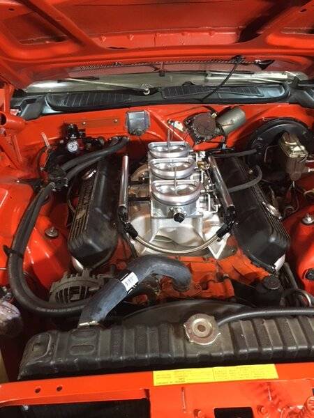

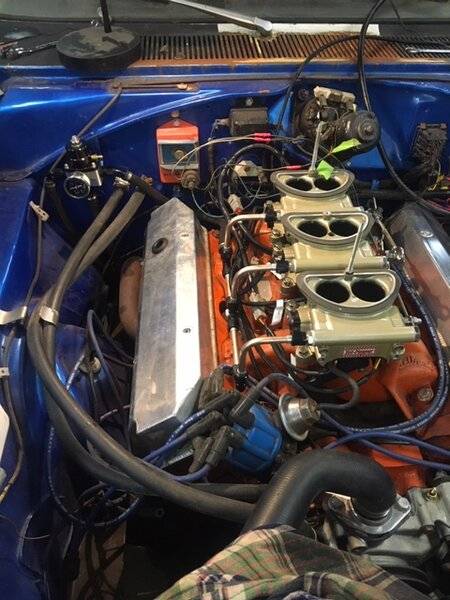

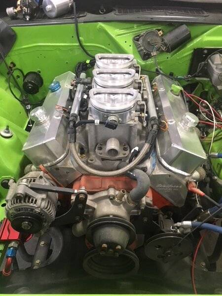

my 346 EFI 6 BBL
:xscuseless:
:lowdown:EFI 6BBL?!! FiTech??
If FiTech, I have held their EFI 6bbl setup in my hands and it felt well made, substantial! The only other 6bbl EFI I can think of is the F&B DPI/TB setup.
PLEASE, a bit more info, or PM me!
No, its an F&B system with a FAST EX 1.0 controller system. I also have a 440 EFI 6 Pack using a F&B system with a Holley HP controller system. I recently installed a Fitech 6 Tri-power on a 69 Ply Wagon with a 440 but have not got it running yet.

THANKS! It's kinda funny that the "horsepower limited" FiTech is on the big block, and the far more flexible F&B systems are on small blocks. I asked FiTech if the HP limit could be increased by changing injection components etc and they said "NO" but I know the F&B system is fairly easily upgraded.
