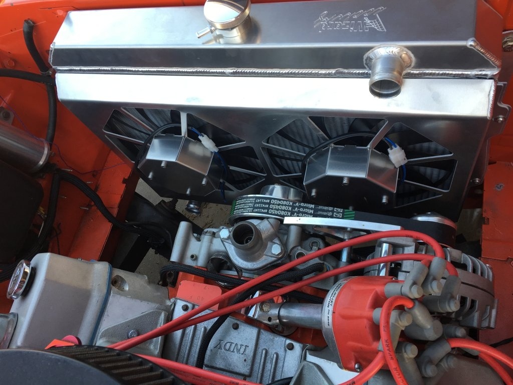

Thanks for the reply Mike! I'm going to hold off for at least a few weeks while I get everything else dialed in. I have the 1000hp rated BeCool radiator with twin 13" Spal electric fans that for the first few drives with the new motor was not cooling it adequately. I drained all coolant and went to distilled water and water wetter only which put me 185-190 cruising and 195-200 at traffic lights. Having two other small problems with belt throwing at 7k rpms and new powermaster one wire alternator not fully charging Optima battery. Real excited to get to the track see what she will run, its a handful on the street but a perma smile every time I get to drive her. Thanks for all the suggestions!
I talked to the tech and Griffin Radiator and he said that the 1000HP Be Cool radiator would NOT adequately cool your (and other peoples) high horsepower motors). It only has 1" tubes running thru the radiator but the Griffin Radiator has 1 1/4" tubes and he said that was the root of your cooling problems. Call Griffin and find out for yourself. BeCool will tell you their radiator is adequate but it is NOT.
Thanks for your posts Mike! I spoke to both Griffin, Wizard and a few others who all said the same thing, the BeCool will not be able to cool my motor. I went with Wizard because I liked all the positive feedback on their radiators, plus I really liked their integrated shroud and I also went with the 1 1/4 tubes. The serpentine belt I have in my most recent pick is an 8 rib belt. The old photo you were looking at was upside down that is when I was trying to get the car to stop throwing belts at 7k rmp. No longer a problem with the serpentine system. The Wizzard is really a nice piece but it has been 110+ degrees here and the new radiator is much better just still not enough! The only thing I can think of is to place the twin 13 spal fans I have from the BeCool on the front of the radiator for extra airflow, just not sure it will help.
Here is my current set up with the 8 rib serpentine belt system from CVF Racing.
Plum....I had the exact same cooling problem when I drove my car on the street....210 to 220 degrees and climbing up. I have a BeCool 1000HP radiator with twin fans. I thought they were 13" but when I was talking with Griffin Radiator tech he told me to measure them. Come to find out they were only 11" fans when I measured them. He said I needed their 1 1/4 tube radiator with their widest core and their 13" fans and he guaranteed me that would cool my motor.
