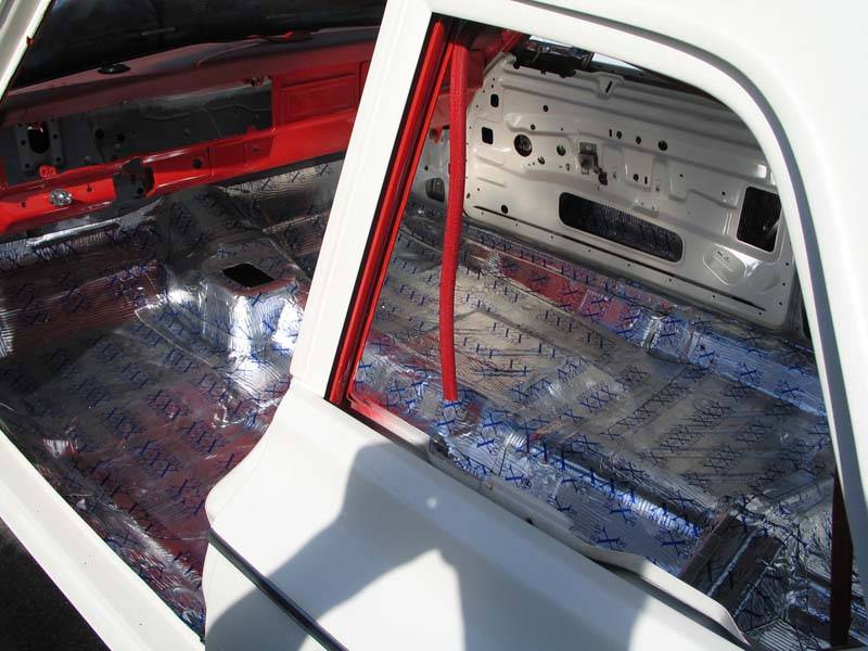

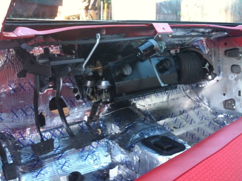

I'd definitely recommend FatMat. It's way less expensive than dynamat and seems to be as good if not better quality.
I used a 100sq ft roll and did my entire floor, cowl, kick panels, package tray and inner doors and quarters under the side windows (not in trunk). That pretty much used it all up. The FatMat sticks like crazy which from what I heard is really the sign of a quality material.
