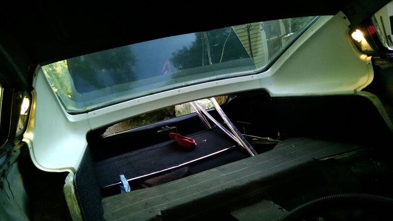

I built a dual cone subwoofer box (but you could buy one) and I have a pair of small enclosed speakers. I used to have pyles mounted with brackets to the side panels where the carpeting is but now I just have them loose. Hopefully I never get hit by one.
I'm not saying it's the best setup but it's how I avoided cutting any holes in the original stuff.

I see those rear panels -- does your car have a Citron Gold interior? If so, did you paint those rear panels?
Pearl white, just a crappy picture sorry.
They are original, I've done the carpet twice now.
