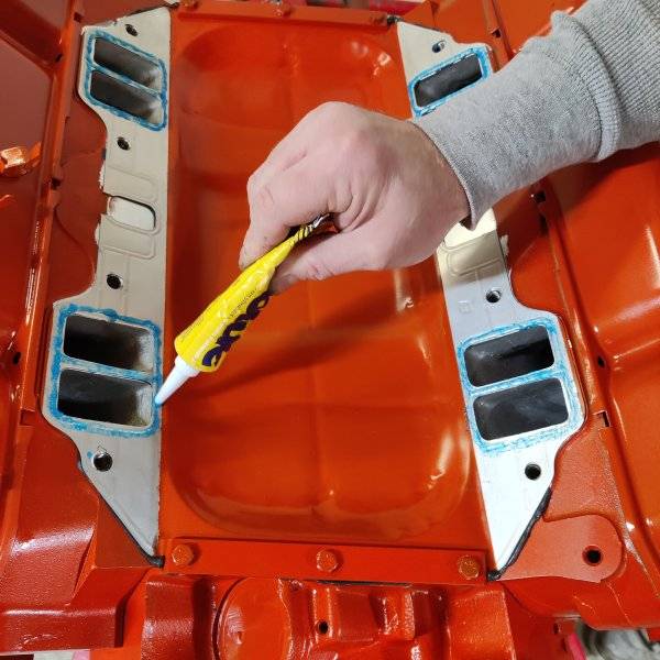

I use Hylomar blue around ports of the valley tin and rtv black in corners
No paper gaskets between the valley pan and intake? None zero nada just like the pic hylomar bothe side around the ports and rtv black up the corner and china walls. Check engine vacuum with a 228 cam it idles like a kitten at 14 in vacuum. 13.5 AF . Seems ok to me.
