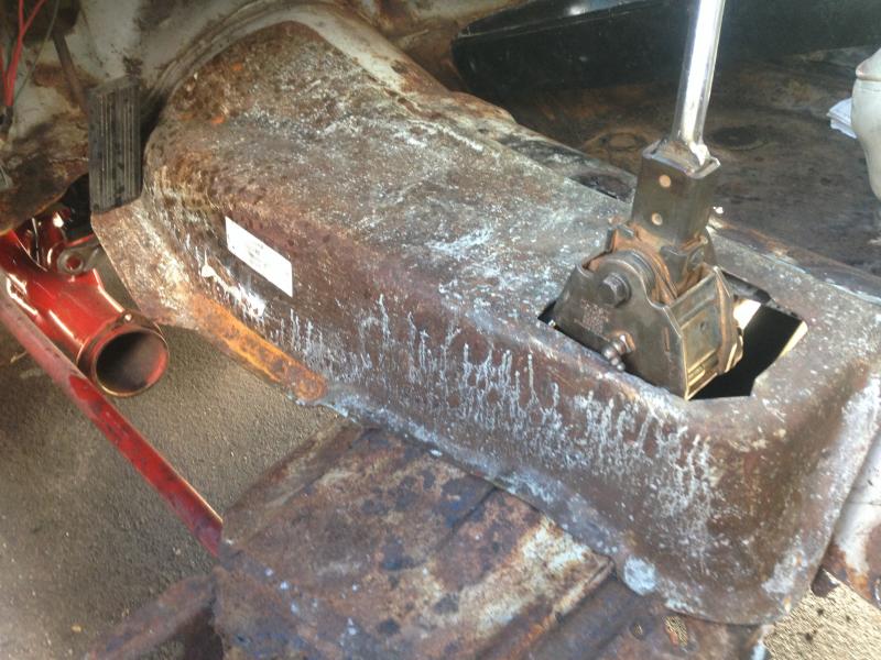

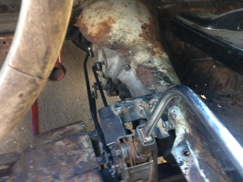

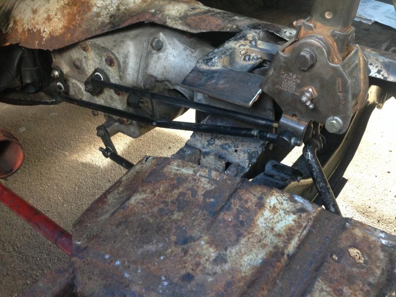

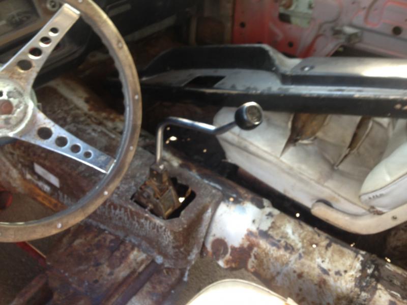

Problem will be solved tomorrow. the shitfer relocator bracket puts the shifter right where it would be on a long shaft 833 no problem. and we got the hood on today.
Shifter problem solved today. So Can an A-body 833 fit in a B-body? ...Yes...would I reccomend it...no. it involves cutting the subframe crossmember, a special relocating bracket, beating the hell out of pushrods to make them fit, makiing a new section for the subframe, and welding it all up.
Don't do it unless you have NO other option....Not for the faint of heart. .

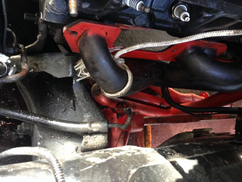

The engine started today....and it was freaking loud with just headers OMG!!
That's awesome!!! I remember when I first fired mine, with just headers, shook stuff off my shelves in the garage, it was fun!!!! LOL

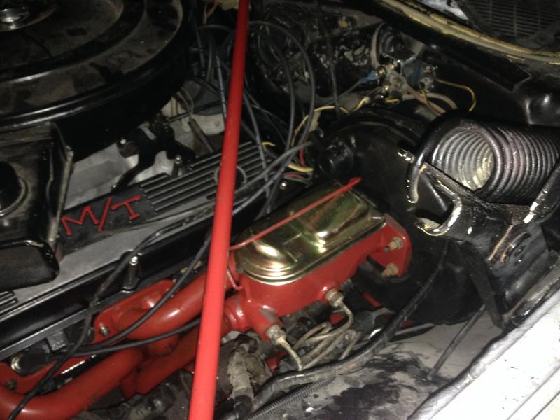

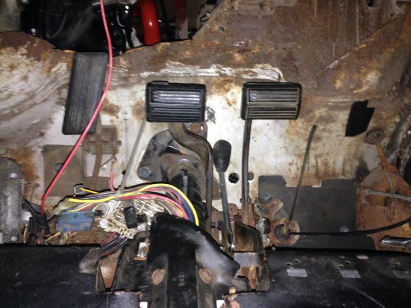

Finished the manual conversion today and installed the power booster and master cylinder...

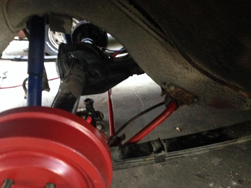

The rear sway bar is on. Got it off of a Cordoba...LOL its in a much better place now...
Agreed.... I took the 6 way power seat adjuster from a 78 Córdoba back when you could still find them.... Works great...

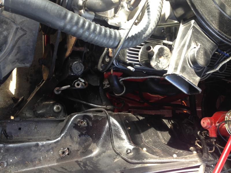

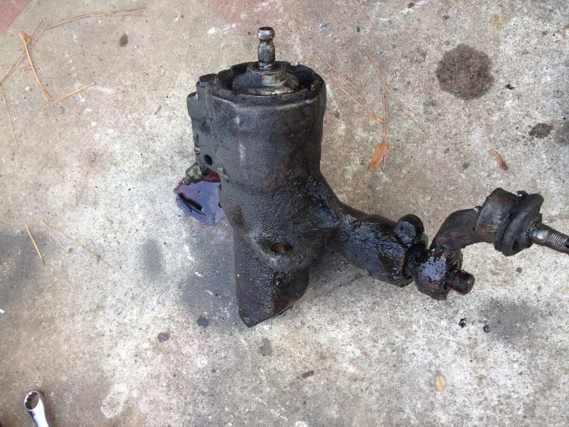

Got everything hooked up and ran the engine for a minute and the power steering box leaked all the fluid out...and its not coming from the pump for sure....:thatswck:
I hope it can be replaced without taking the engine out....
Got the Steering gear out. I was able to swap it out with another one we had on hand. not even newarly as hard as I thought it would be. I nearly have the floorboards finished tomorrow I am filling some seams and then Bed-lining it.
