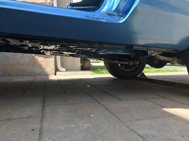

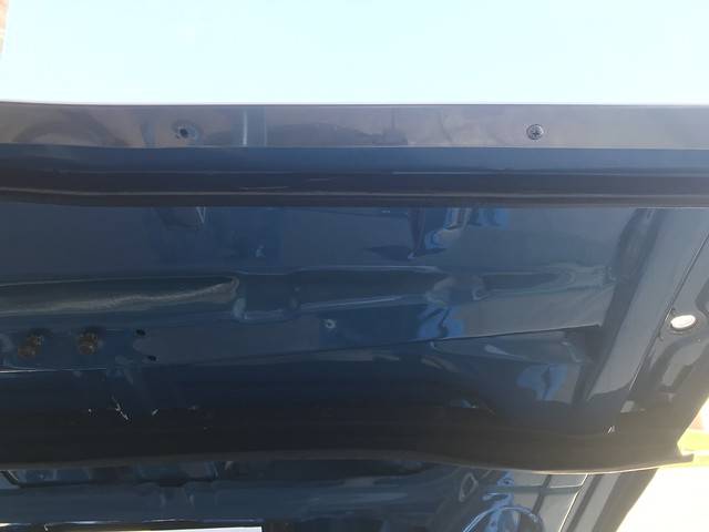

On my project cars, the black out looks sprayed. No trace of brush marks. and the front hood lip blackout seems to have a nice straight edge along the hood skin, so it appears to have been masked when done, but not certain
My original on my 72 looked brushed on, but I used spray paint when re-doing.
Front edge of the hood.
