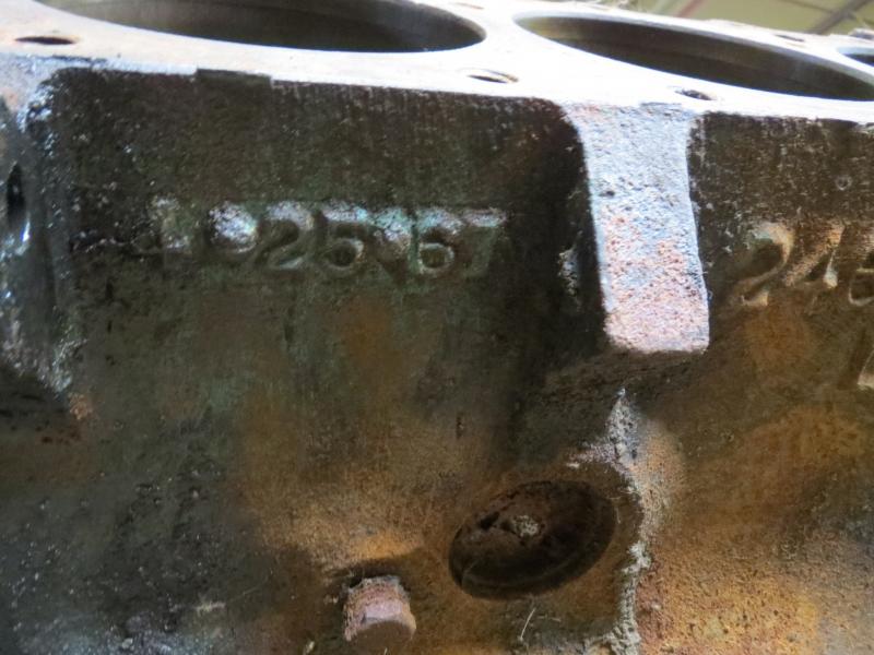

The casting date on the 383 will be just behind the motor mount on the driver side.

That's the date the engine was assembled so depending on the casting number.....

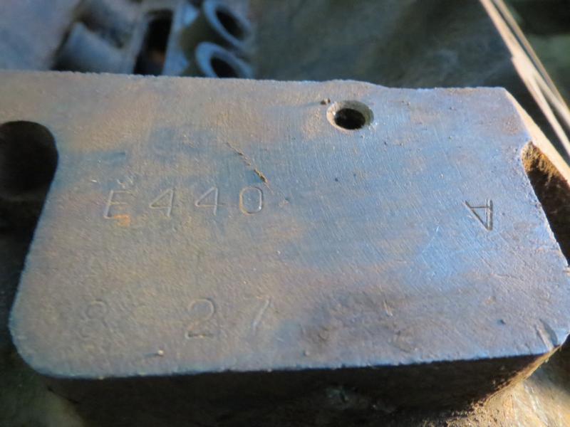

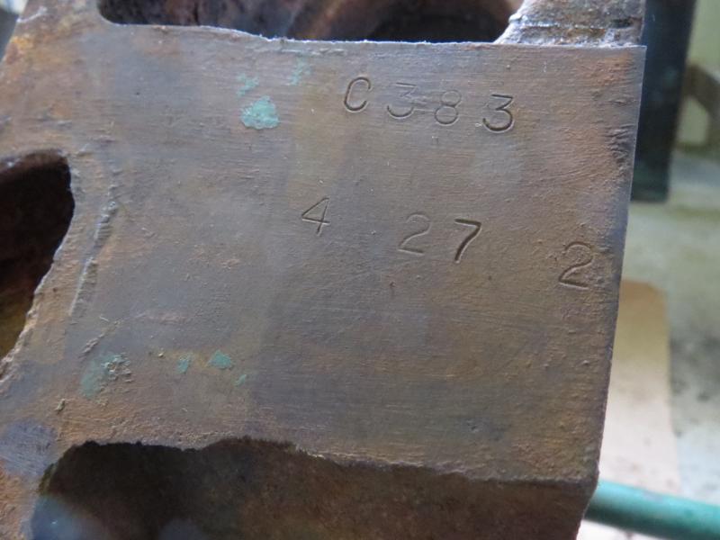

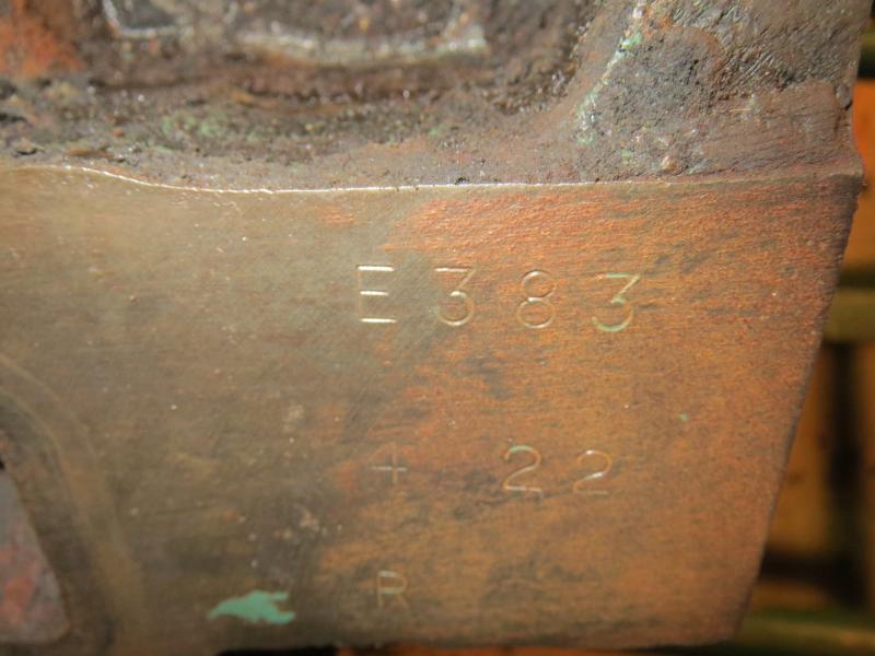

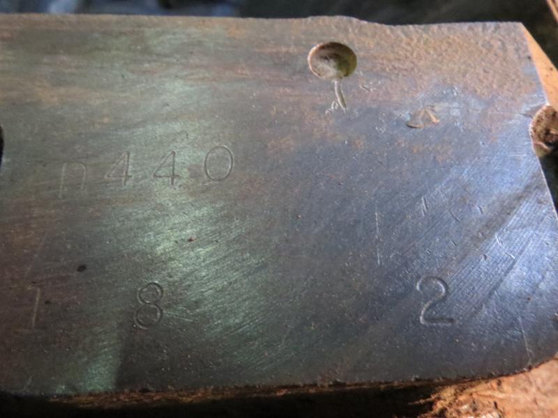

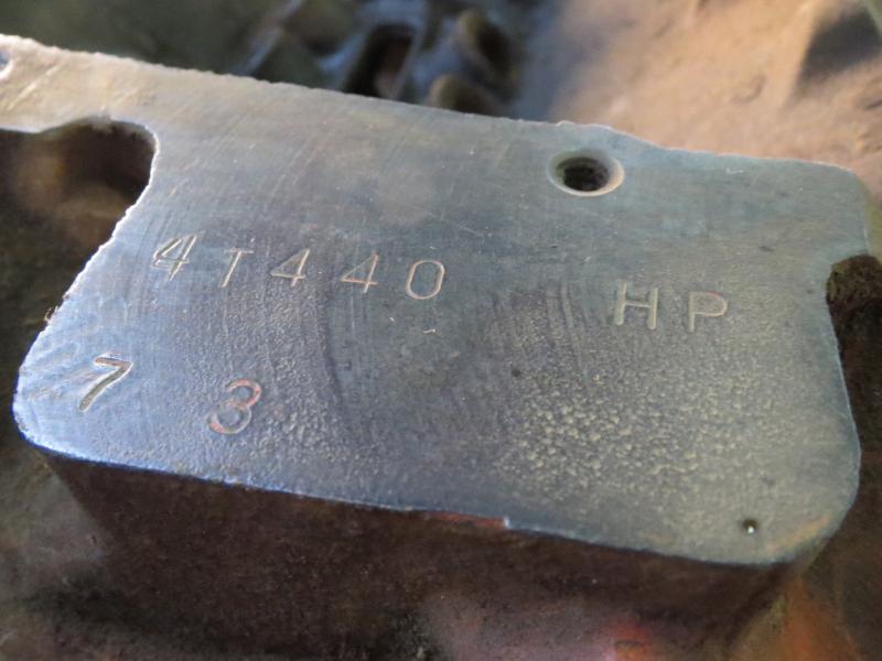

The pad should have 383 on it too preceded by a capital letter, for example C='67, D='68 etc.
Here are a couple of examples and a 383 casting date.

The raised deck engines have the size stamped on a pad on right front of engine just in front of the intake pan gasket rails. As in the 440 pictured above. 383 is front of the distributor. Or you can give us the block casting # and date, and we can tell you all about when built, and size.
