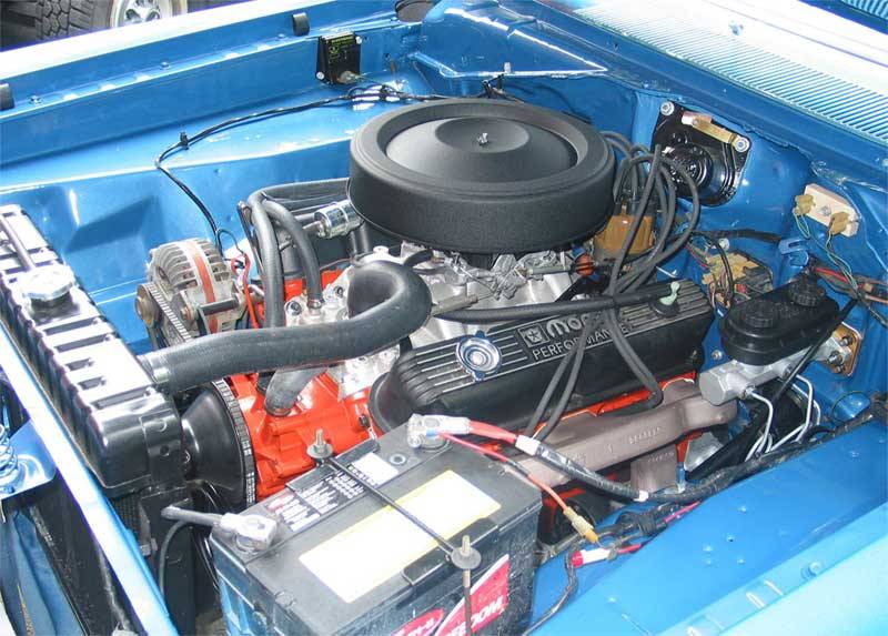

On my last 318 In my 76 Feather Duster
Stock long block
small Summit Cam
Weiand Action Plus, A factory TQ intake would work too.
Thermoquad
340 exhaust manifolds, 2-1/4 duals
Double roller timing chain
Was a little screamer, 4-speed and 3.55's helped a lot.
