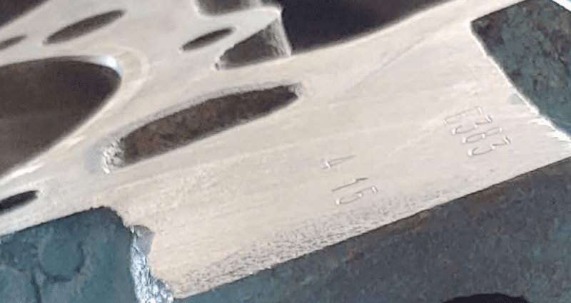

Should have a stamp in the pad near the distributor like A383, B383, C383 etc with a date below that too. I think 66 should be B383
Look at the flat area by your distributor. If a 66 383 then will be stamped B 383 and if a true 4bbl engine an HP towards the bottom like in the above post.

So the upper pad will say F383 and side cast date 69, or 70

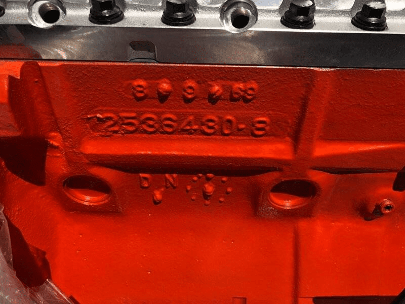

What do you mean by "etc"? There should be a date and part # cast right into the side of the block that will give you information.
Pretty sure my 66 did not have an HP stamp. I don't think they designated them as such in 66.
