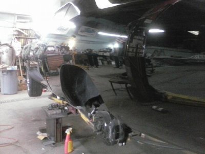

what driveshaft material would you guys go with on this build? guy at the driveshaft shop around here says he would just go with a mild steel 3" if its not going to the track every weekend with slicks on it, do you think spending the extra $150 on a 3.5" chromoly would be worth it?
Are you talking to "THEDRIVESHAFTSHOP.com" in Long Island or just a local drive shaft shop? I'd stay away from a local shop and go with a National Performance Vendor. I twisted the yoke on the first one I had in the car ('64) when it was just a Dual Quad Cross Ram Hemi. (came from a local Implement/Heavy Equip. drive line supplier) I went with the "4130" Mark Williams piece... As stated, "peace of mind".
http://markwilliams.com/driveshafts.aspx
