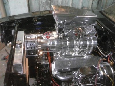

blown 70 charger progress
here is some eye candy for ya, and a video link to the dyno run, it will make you smile!

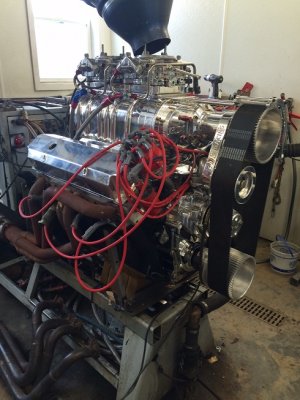

got the old girl put on the dyno today. 7.9 pounds of boost. started with initial timming at 32 and had the 6btm hooked up and set to take out 2 degrees per pound of boost so total timming was running at 16. made 800 hp "6000 rpm" and 825 lb ft "3800 rpm". set timming to 20 degrees and made 840 hp and 890lb ft, with it up at 12 psi it made 1091hp but only wanted to do 1 run like that with stock block, got her all set back to 8psi and underdriven quite a bit so she should live for a pretty long while
She is HEALTHY!!! Bit of a stout ol' girl you have there! lol
Gotta' love the sounds, squeals of a blown motor
Sweet, sounded great too, healthy #'s for damn sure...
:headbang: Congrats :headbang:

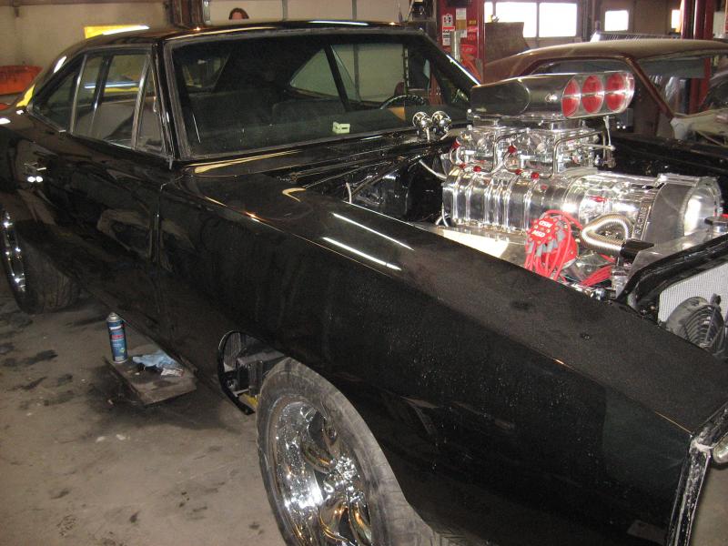

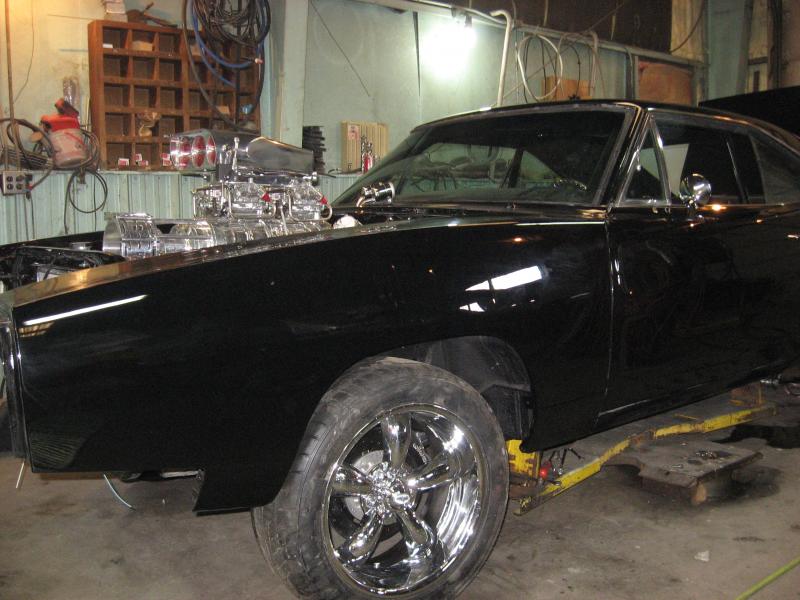

well boys and girls, we are about a week away from the beast being complete!!!!!!!!!!!!!!!!!!!!!!!
going to shoot for pickin' her up next week and stopping at the winter fest of wheels car show in Sioux falls SD. hopefully everything works out and gets done on time, only thing I will be missing maby is exhaust, wonder what they will think when its drivin into the convention center with open headers lol !?!? engine is in, tranny is in, driveshaft will be done on Monday and all that's left then is bolting in the center counsel and cleaning up some wiring and the car itself.
ps. look at the huge 1/2" gap between the blower and radiator! sure hope nothing ever taps the front end!

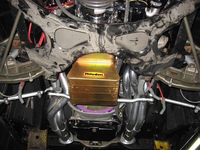

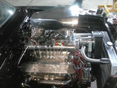

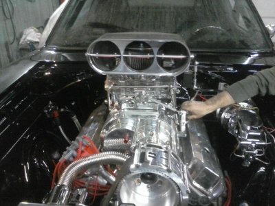

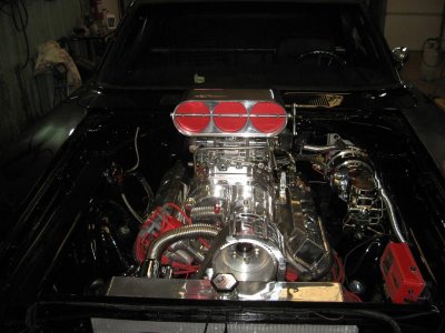

here is a few more pics as she is coming together. one question I do have for all you mopar nuts is should the engine look like its tilted a little one way? I asked them and was told this is normal that they do not sit perfectly straight in the k member but if you look at the one picture here it sure looks to be off a bit, when looking form the front of the car the left side of the motor looks to be lower than other side
my favorite pic of all
Yep engines definitely a little tilted which means the whole thing has gone bad. Only thing you can do is get rid of the car as fast as possible. Just sign the title over and ship it to me and I'll dispose of it adasap
X2!
The engine is supposed to favor the pass. side, looks a tad cocked, but that could be the angle of the pic.
Should be level and offset to the passenger side. If yours is tilted than something isn't right ,check the engine mounts.

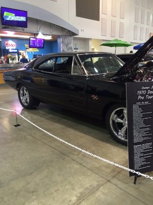

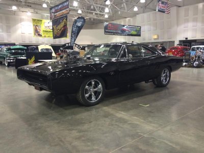

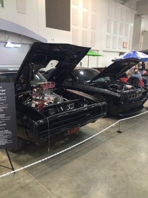

will post some shortly here, show was good and car got a ton of attention, sitting next to a mr norms cuda and not much attention was payed to the cuda lol. got to take her around the block and WOW is that thing wild, got a few issues to sort out, sticky throttle linkage "stick 3/4 open on me" luckly I could kill the ingition and get her shut down, gotta rebuild the headlight motor and sort out the tranny linkage
here is a youtube video of the sound of it at idle with open headers, video quality sucks but atleast you can hear it lol, you can see by my reverse lights the linkage issues I gotta work out
