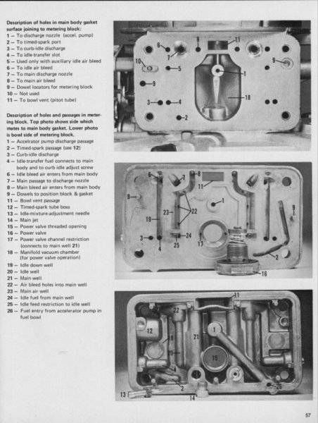

No. If that's yours in the picture, it's a vacuum secondary.For a little background, the carb is a Holley 750 cfm with mechanical secondary

I wonder if you had the correct stack of gaskets for the secondary metering plate. For a vacuum secondary 3310 by the looks of itAs for the gaskets, they came from a kit provided by Holley, not an aftermarket no-name set of gaskets. However, how would incorrect gaskets create this situation?
Yes, you are correct. It is a vacuum secondary. I am somewhat of a novice, and used the wrong terminology. Which gasket exactly are you describing? The one between the metering block and the main body of the carb?No. If that's yours in the picture, it's a vacuum secondary.
