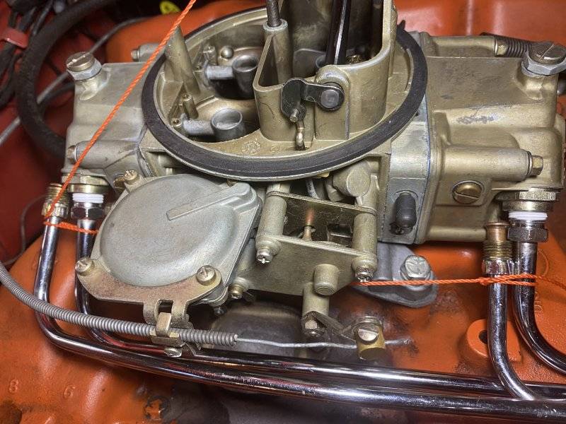

Would changing the dual feed fuel line have any effect on the volume of fuel getting into the engine? I imagine the carburetor is a metering device regardless of how much fuel is being provided to it. The new fuel line has a 3/8" diameter compared to a 5/16" diameter, and the connection at the fuel bowls had to be changed to bigger nuts to accommodate the larger connections on the new fuel line(see picture)
