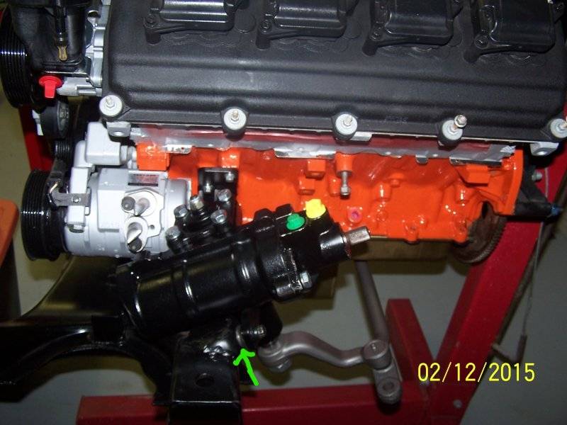

I think you will be happy with it once you get over the sticker shock. They are spendy for sure. I don't know if they altered the single tab they welded on but mine seemed to not be in line with the column and was angled out some. I spoke with Peter about it back in 2014 and he said it should be fine and the coupler would be able to handle the angle difference but I added a 1/4" washer to put everything in line. Here is a pic, green arrow showing the shim.
KD - did you need to shim yours like Sixpactogo shows above?
