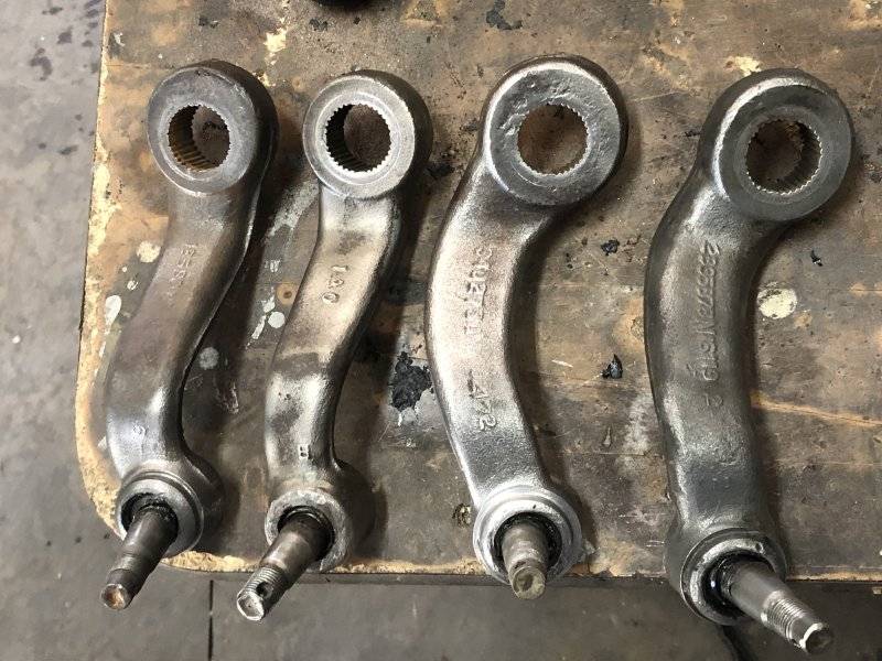

I re-installed the pitman arm today and the steering wheel seems way off from center. The bottom spoke is at somewheer between 4 and 5 o'clock to have the wheels pointing straight. It should be at 6 o'clock. Is this close enough that the wheel can be centered with the tie rod ends or do I have to remove the coupler from the input shaft and re-position it better?
I would pull it back up and move it at least two teeth to the right and try it again. Once you get it right, mark it with a center punch so you don't have to guess again next time.
The Pitman arm has 4 notches to it, meaning it fits 4 different ways on the steering box (out of the car) but only works one way with the steering box bolted in.
You can't just clock it a few degrees.
There have been instances where the steering box had to be shimmed to get the proper angle. The steering wheel itself can be removed and clocked, right? I have an aftermarket wheel so it is a LOT easier.
I think we are talking about the Borgeson coupler. That and the spine on the gear is the only thing not clocked. I had to move mine a couple times to get it right. A stock steering wheel and the shaft are clocked also.
I have a stock woodgrain steering wheel with three spokes. The last time I took it off was many years ago, and I think Sixpack is right, it is clocked. The pitman arm is mounted correctly(I'm 99% sure of that). The way it's indexed, if I tried to change it, it would be waaaay off. My thought is to hopefully slip the Bergman coupler off the input shaft, make sure the wheels are straight, turn the steering wheel so the bottom spoke is as close to 6 o'clock as possible and re-attach the coupler to the input shaft on the steering box. Neither the Bergman coupler nor the steering gear are indexed so you can rotate the coupler any amount of splines in either direction. I followed the directions, and I thought I had the gear centered, but it obviously off, probably two splines. I'm hoping I can do that without the coupler coming apart again. That damn metal cover is a bitch to put back on.
It's not the angle, it's just not centered. My pitman has no numbers, so I don't know exactly which one I have, but it's worked fine for the time it's been there. Peter Bergman was very insistent that I did not shim the box, he claims his coupler is specifically designed to handle any offset. From center, the wheel turns almost exactly the same amount in either direction. It's off by essentially the amount it's off from the spoke centering at 6 o'clock.
