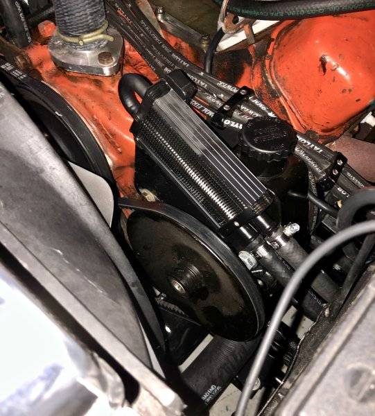

I used the full Borgeson kit with their pump. I burned my hand on the pump and thought I brushed against a header tube. If I recall, the infrared gun indicated close to 240 degrees Fahrenheit. I got this cooler from Summit and machined a small bracket, currently the pump body shows 175 degrees on a warm day and a long drive.IMG_0040.jpg
