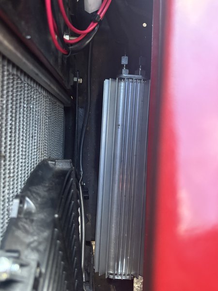

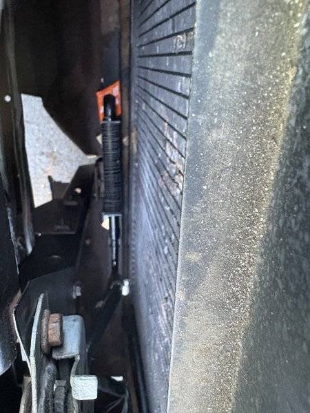

The filter shown by Icetech is the same one I'm using too. Along with the cooler. The filter is specifically for either power steering, on the return side, or automatic transmission, also on the return side. Units have magnets in them too. Some of the oe's used these filters on trans applications when there were destructive issues. I remember Subaru using them in the early 90's on Legacy's. Factory service bulletin. My cooler is behind the grille so it gets better airflow. Also for those not knowing, p/s return hose is not the same as fuel hose. Different psi and fluid ratings.
