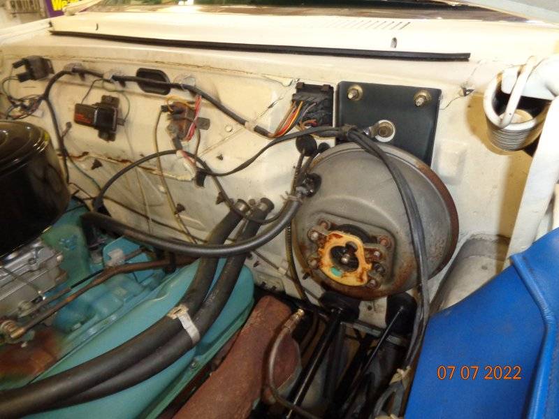

This is the factory Midland booster on my 64 Plymouth with power brakes>
