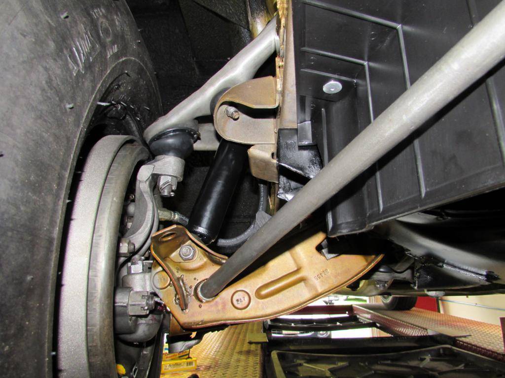

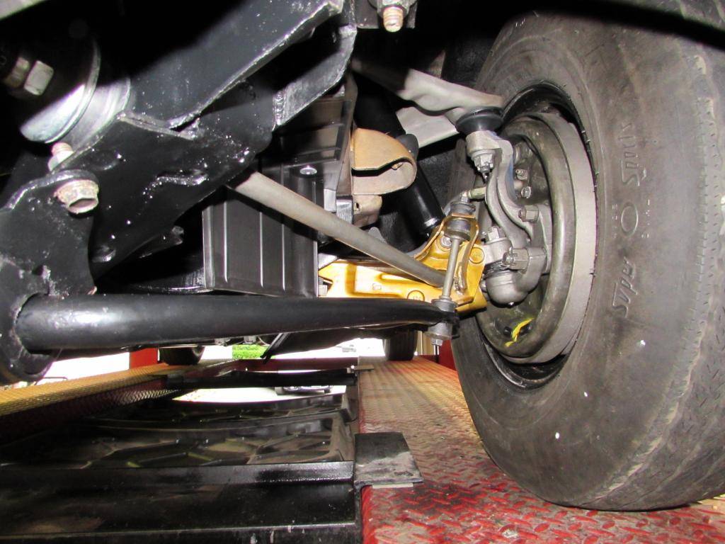

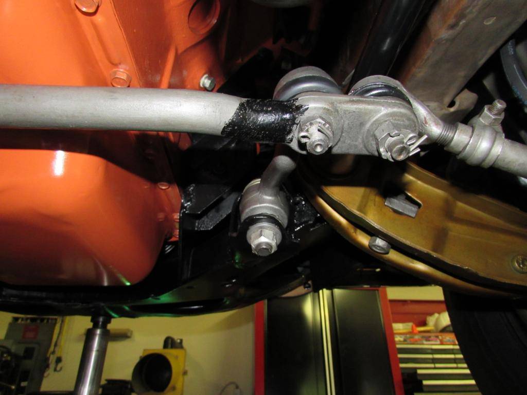

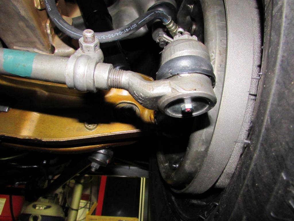

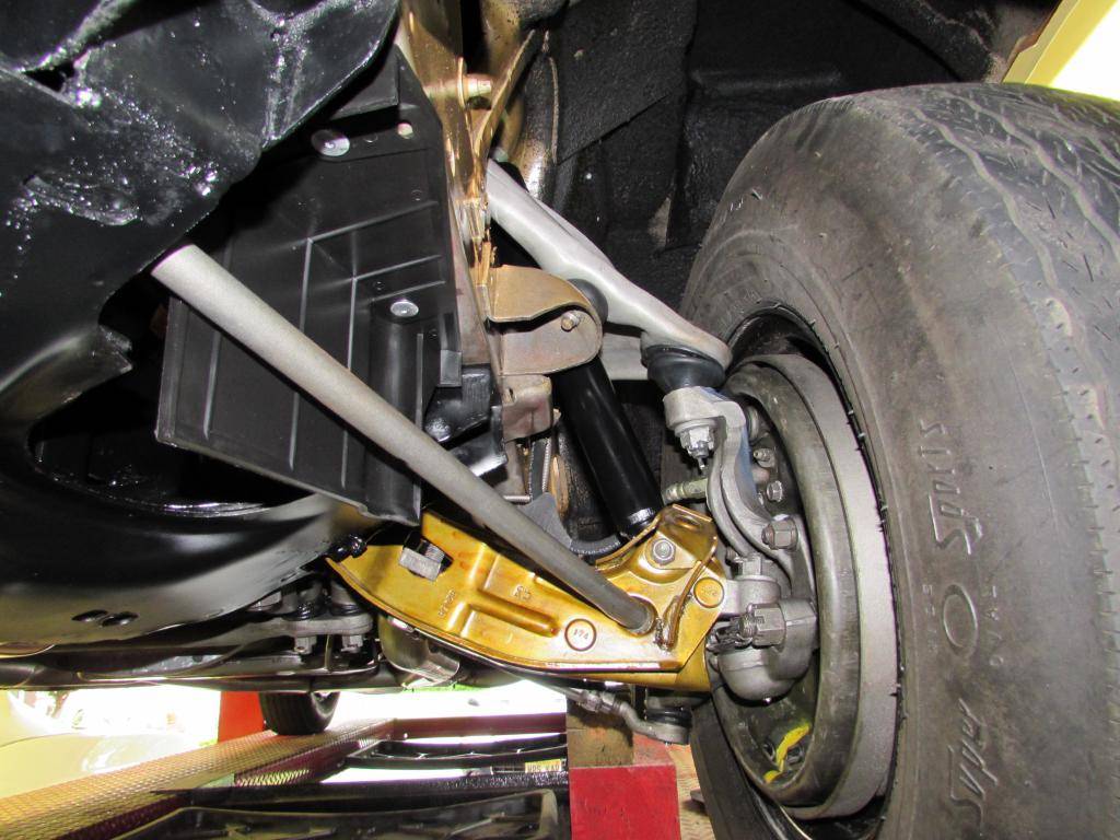

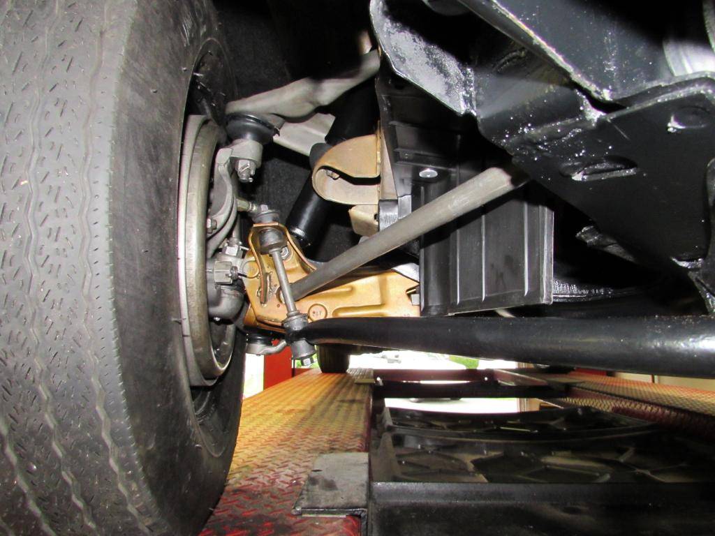

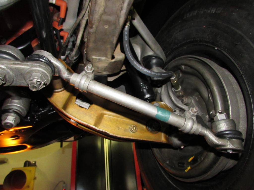

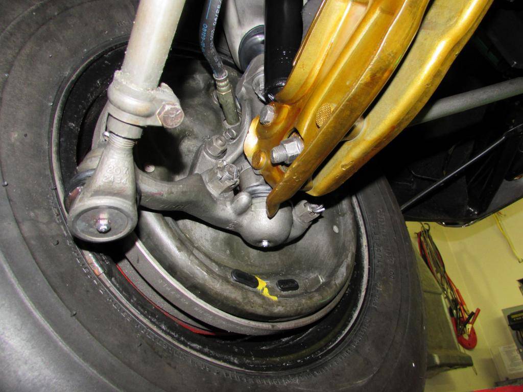

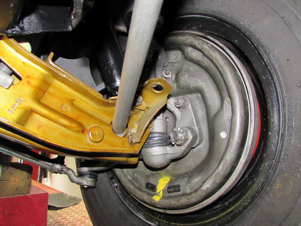

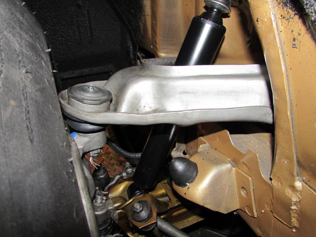

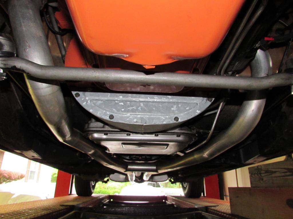

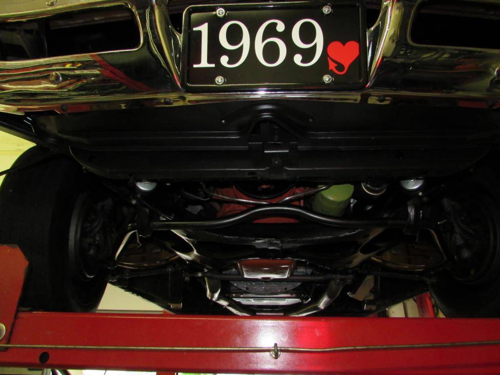

Well, the front end is officially finished! Dad had the car aligned yesterday and ran into a brake issue which ended up just being some air in the rear brake lines which I apparently did not bleed out enough with the pressure bleeder. Anyway, here are the finished pics. Also take special note of the zerk fittings. They are the factory correct break off style which I picked up from Frank Badalson. A nice touch for that OE look. (some pics do not have the sway bar installed, since those pics, it has been reinstalled.)
Also came across a nicer inspection cover which I installed.

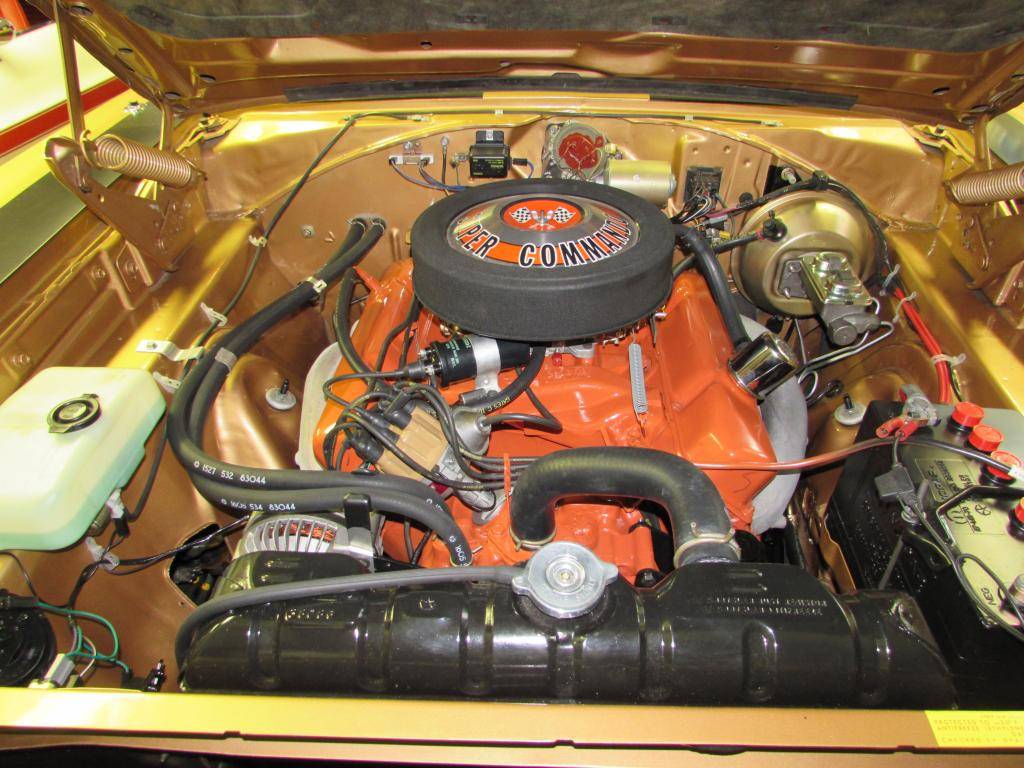

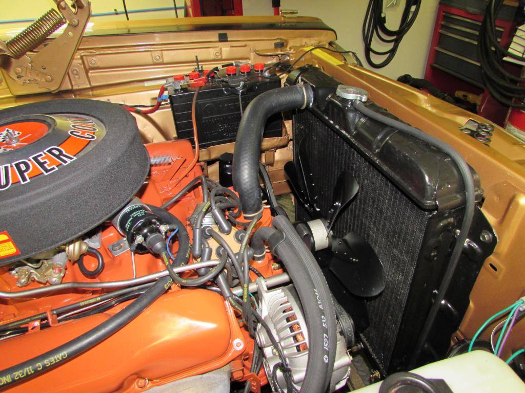

Engine compartment all finished too!

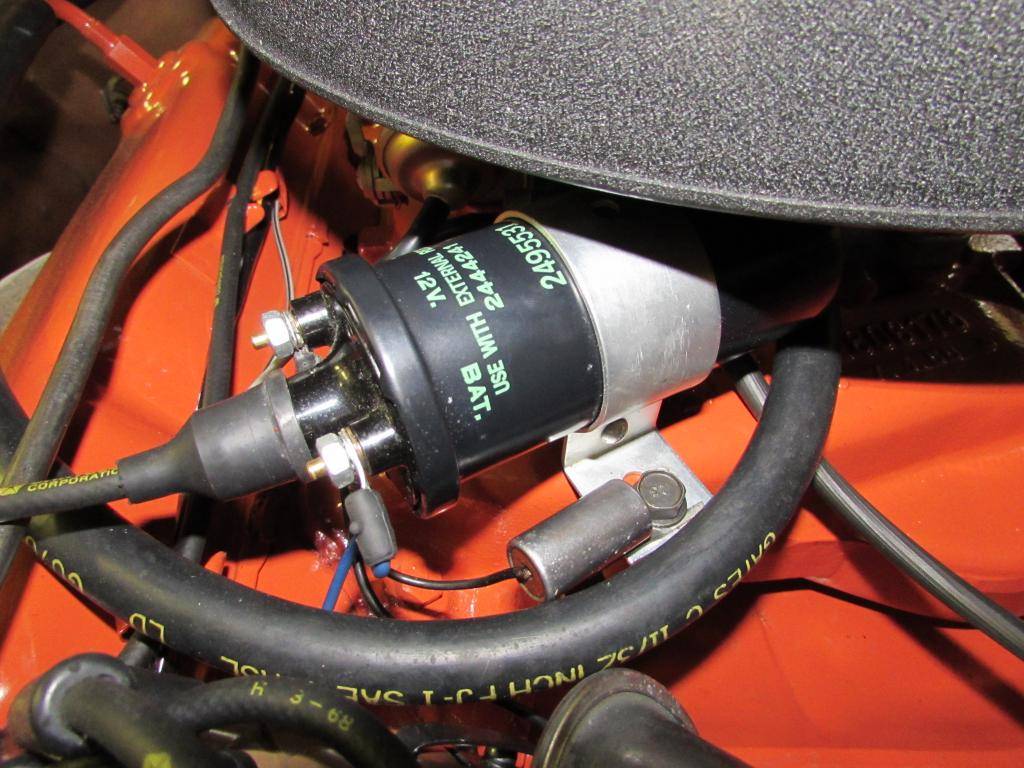

Original condensor and new correct green letter ignition coil.

Glad you like it. We still have the rear axle and suspension to do and also noticed I need to repaint the lower part of the steering column as someone over the years had painted it black where it should be the interior tan color. Weird thing is they only painted it from the firewall out to the steering shaft. Easy enough to fix though.

Believe it or not, the stuff I used for the Cosmoline (which is exactly the same stuff in a can) is the Eastwood Heavy Duty Anti-Rust in a spray can. I hung the control arms from the lower ball joint hole like they would have been from the factory and loosely put tape around the area where the "dip line" would have been. I then sprayed on the "Cosmoline" in heavy coats which would allow it to flow and in some instances run like the factory process would have allowed.
I purchased two cans but had plenty left over so you may be able to get away with one can. Two would definitely be enough though.
