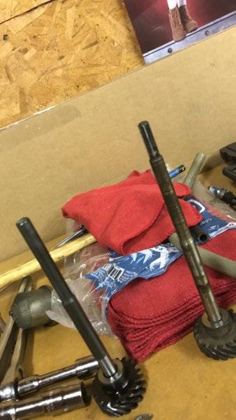

Okay, so it's a 71 SSP with a 904 and new 72 340. Sitting on the 340 is a RPM Performer Manifold and AVS2 carb. Stock 360 heads. Comp HE 268 cam. HV oil pump. Everything else is stock. Broke everything in great and had great oil pressure. On first road run being easy on everything I lost oil pressure. Brought it back and pulled dizzy to find a broken oil pump driveshaft. What would cause this?
Broken one on the left. An old one for comparison on the right.
Milodon I believe sells ones with harden tips. High volume pump can break them.
Not supposed to use the stock style intermediate shaft with high volume or high pressure oil pumps. Get the Mopar version with hardened shaft and it should be fine.
I'd pull the pump apart and have a look. Cant tell how many times we've found small pieces of valve seal retaining rings in the pump. The better shafts have the shaft flared into the hex, not cut square.

Neither of the shafts you show in your photo have the taper, they are the "old" style that tend to break.
Okay I'm hoping its just that then. I ordered a mopar performance one and I'm also hoping I didn't hurt the new motor any. Thanks for the help guys.
