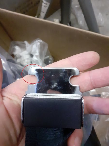

I got 3 point belts for my 68 coronet from seatbelt solutions. I noticed by looking at the design of the buckles (pictures) that they are not form fitting. The anchor is just held by a spring loaded ramp. Under tension, this ramp is pushed up and the buckle opens. I tried it.
I contacted my dealer, who contacted seatbelt solutions. They said this is normal. I'm no seatbelt expert, but I cant imagine a situation where a seatbelt buckle should open, other than you want to unfasten it. So why dont they just design them form-fitting, like the original ones? They dont open under tension, because they cant due to their design.
Any opinions, suggestions....?
Makes zero sense. If what you say is true I do not see how they can sell them. Send them back and buy something that works.
I suggest YOU call them What you are claiming does not sound right.

Look at the pics. Its totally obvious that they open under tension and they do. So what is you explanation for this design?
I cant say anything as I do not have the part in my hand. So I do not see or can duplicate what you are saying. Reading what they claim you would be mistaking. Again I suggest YOU call them. No way would a company be selling a product like that. The liability would of put them out of business in multiple ways.

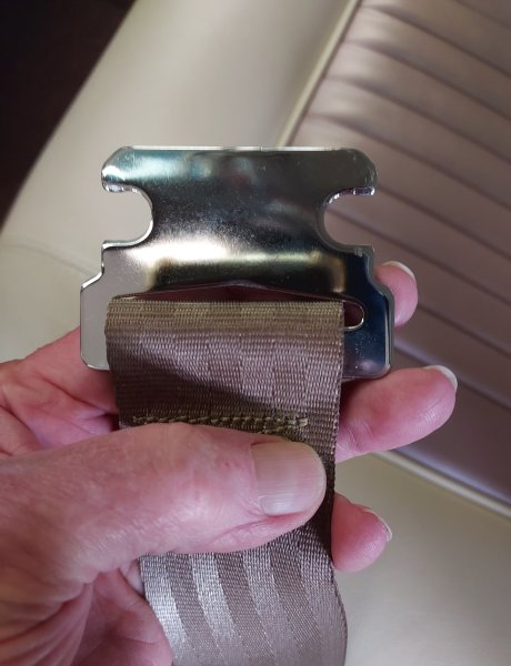

After reading this I had to go out and check the ones I bought from Seat Belts Plus.
Here's yours...
Seat Belts Plus...
It appears to me when they deburred and polished them before chrome plating they went a little overboard and rounded the edges too much.
Here's yours...
Seat Belts Plus...
The reason why they release under tension is the design of the buckle. Please take a closer look at my second picture. I marked the spot on the buckle, that engages with the anchor, with a red circle. It is a ramp that is spring loaded. If you pull anchor and buckle apart, the pressure on this ramp pushes it up and releases the buckle. It would be the same thing with your anchor.
I have the aviator style. In comparison it's about the same mechanism. This is in the open position. Believe me I placed all the weight I could on it and it held.
I cant tell 100% from this perspective, but Im pretty sure its the same design as mine. You have to pull really hard. Try it with a jerk. If you pm me your email adress, i can send you the video how i pull them apart.
