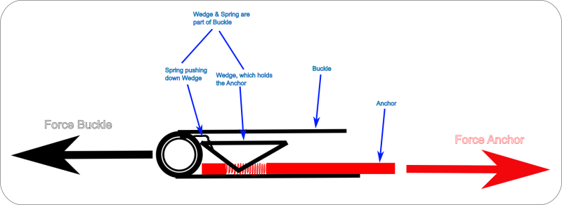

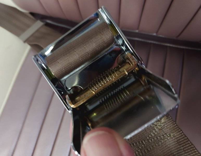

I cant tell 100% from this perspective, but Im pretty sure its the same design as mine. You have to pull really hard. Try it with a jerk. If you pm me your email adress, i can send you the video how i pull them apart.
