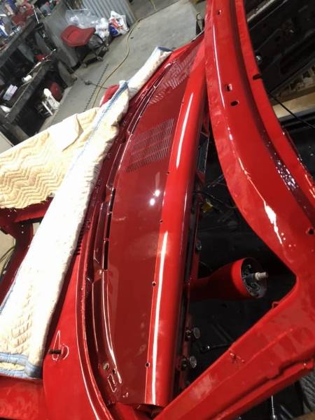

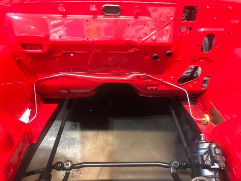

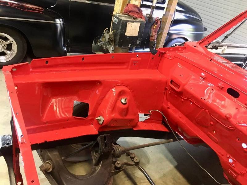

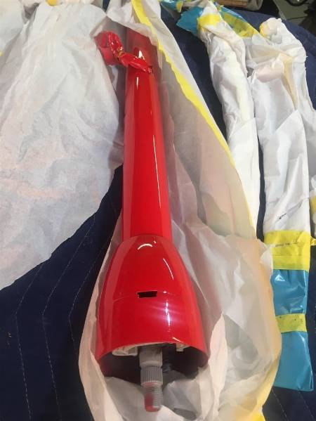

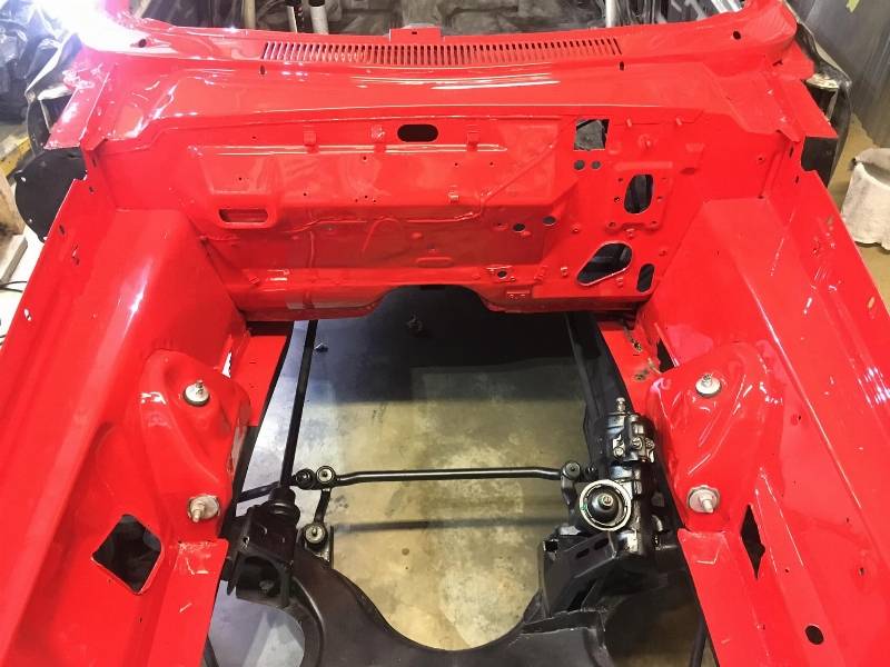

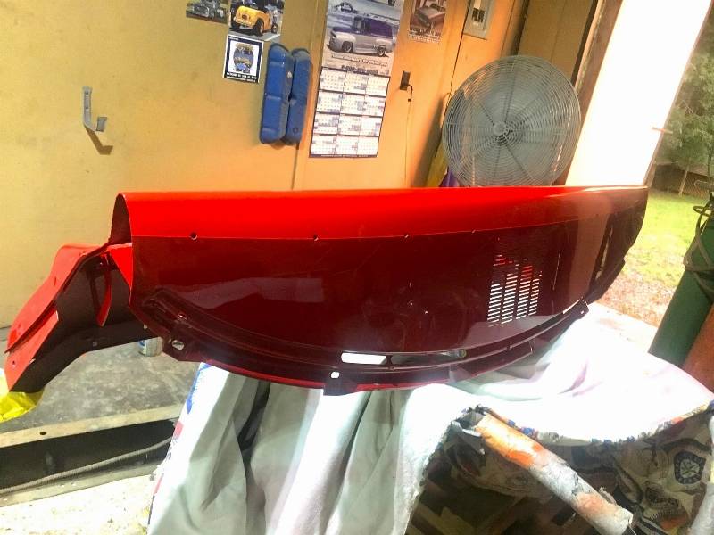

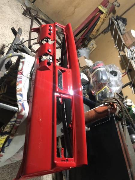

Well, 17 weeks later, I got the vert back from the Body shop with the engine bay, Dash, & Column painted.... It looks good. He did a good job on the Apron tops etc ....It was supposed to take 3 weeks from when he got it when he said he was ready for it. This is a new Body shop for me. My old one hasn't been doing restoration work anymore... I wasn't impressed with his inability or unwillingness to mask off areas that were already painted....So, I'm not certain I can trust him to Bag the motor and entire dash area and keep it clean during the final body paint....

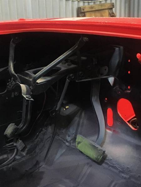

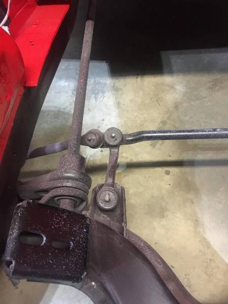

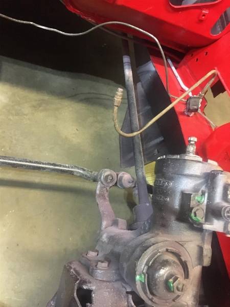

Working on the 64, Spent most of the day cleaning and repainting the Brake pedal and brackets, Parking brake and brackets, Sterring gear, K member, Torsion Bars etc etc…. They were all clean and painted already, but the body shop didn’t mask anything off and everything was covered with Primer and Overspray…. Everything is back to where it was before…. Now we can move forward with inside under dash reassembly. I just love doing work twice because other folks are careless

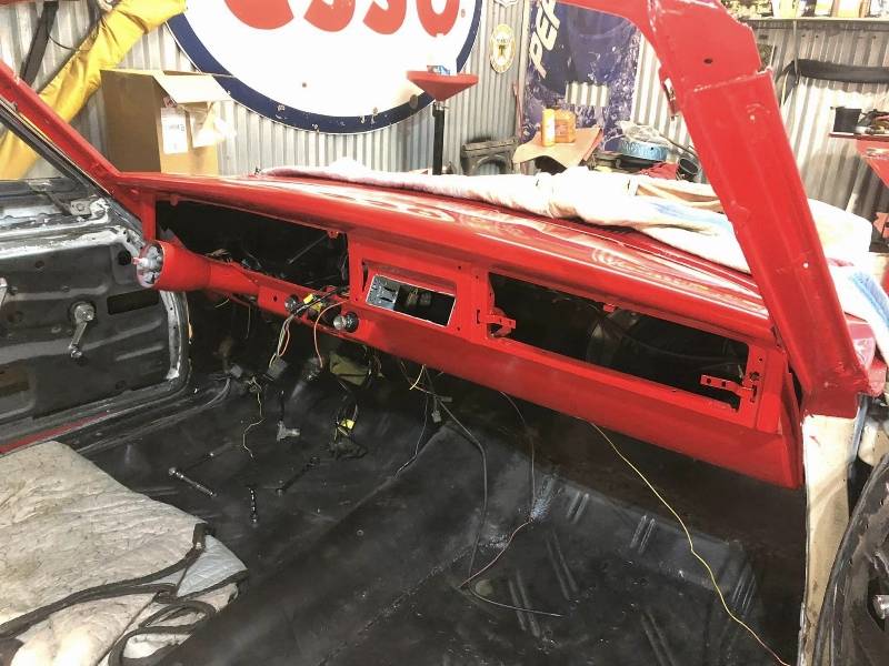

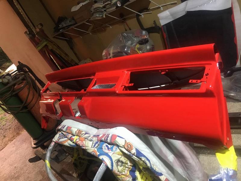

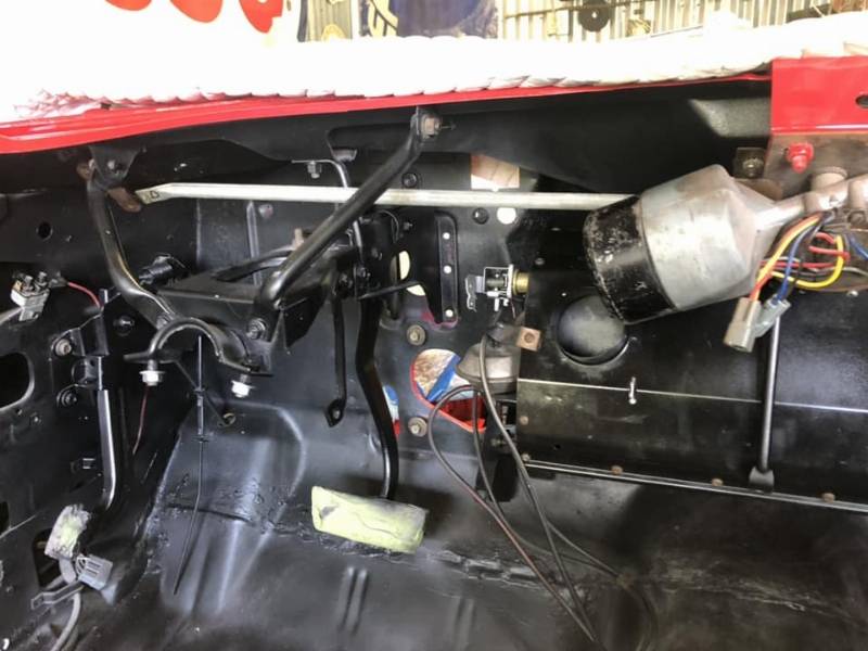

Preparing to reassemble Underdash.....I know folks are wondering why I didn't paint the whole car before finishing the running gear. Well, We are going to start to build my Buddies A Model roadster in his shop and he needs the bays.... I cant get in his shop to do the mechanical in a year or two when the body is done, so were doing running works now, and it will come back to my shop for final reassembly...
Preparing to reassemble Underdash.....I know folks are wondering why I didn't paint the whole car before finishing the running gear. Well, We are going to start to build my Buddies A Model roadster in his shop and he needs the bays.... I cant get in his shop to do the mechanical in a year or two when the body is done, so were doing running works now, and it will come back to my shop for final reassembly...View attachment 1317402View attachment 1317403View attachment 1317404View attachment 1317405View attachment 1317406View attachment 1317407
careless? you are way to kind....... that **** is totally unacceptable

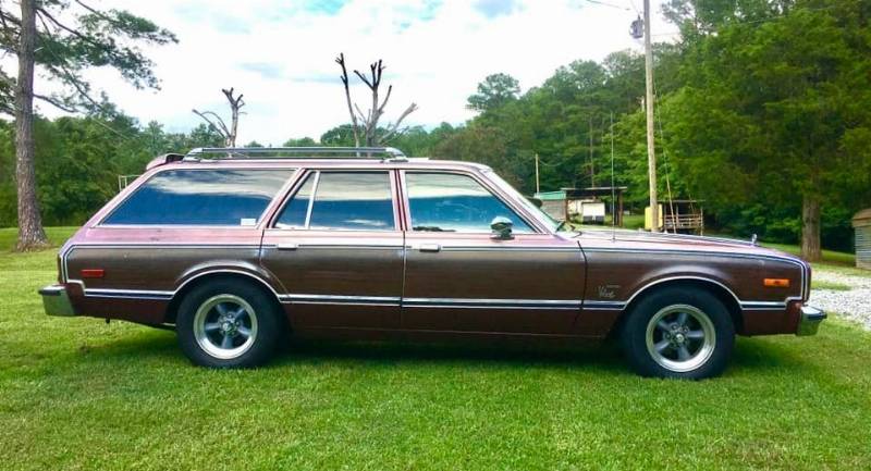

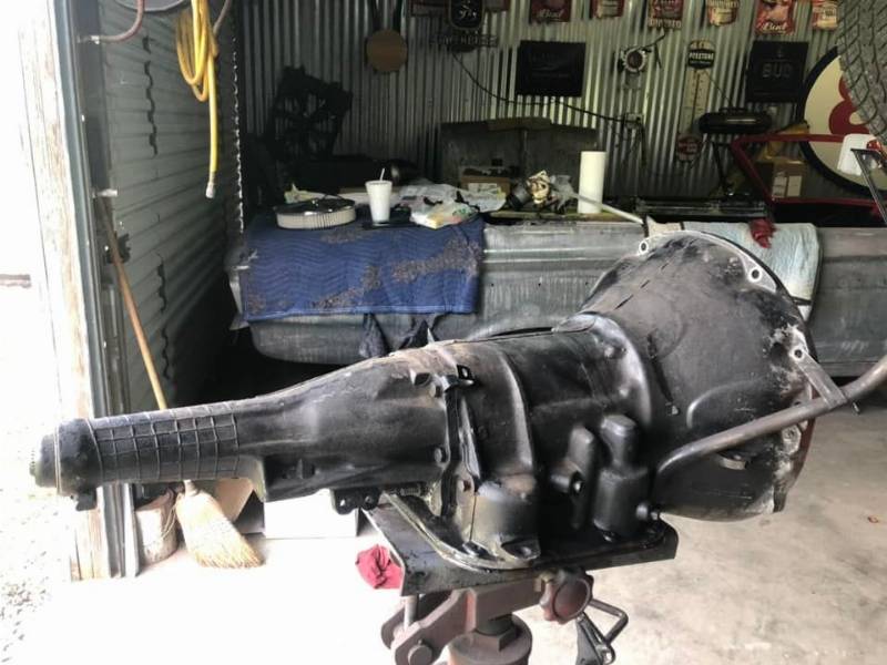

Working on the 64 again..... Had another bout of Covid, and My wagons Tranny took a dump..... Fortunately, I had a spare 904 from the parts car I got my suspension off of !! we took a chance on it and stuck it in...Fluid looked great etc etc.... so far, Its doing great !!!

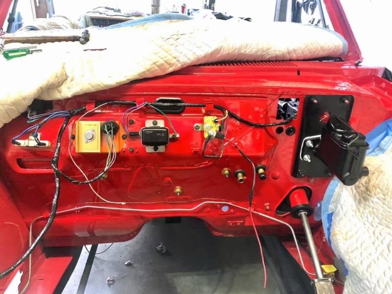

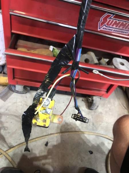

slow but steady wins the race..... Dash Wiring harness has been rewrapped, and installed in dash, along with swiches. Dash is back in the car. Steering column is in the car....

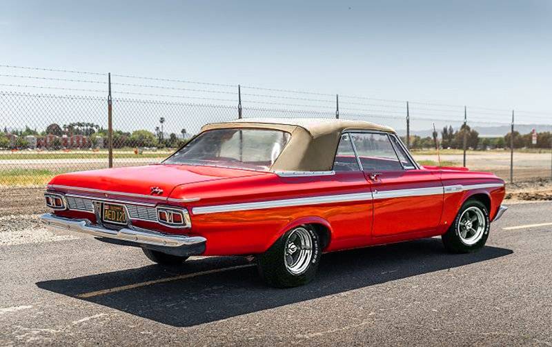

This car was Chestnut Brown from the factory...It was white when I got it.... It is now going to Be Viper Red with two tone red interior, and a Tan top.

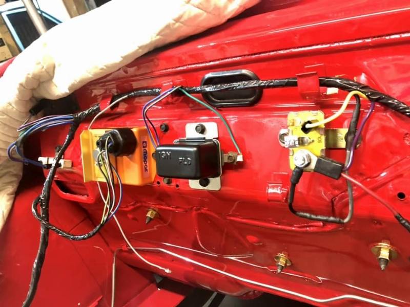

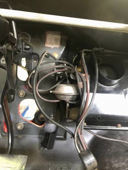

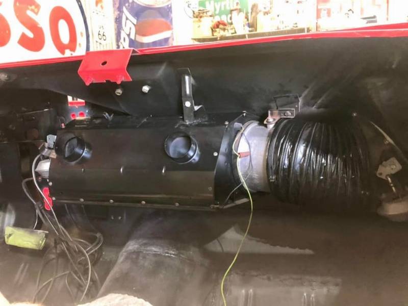

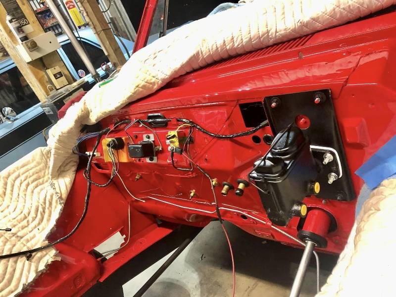

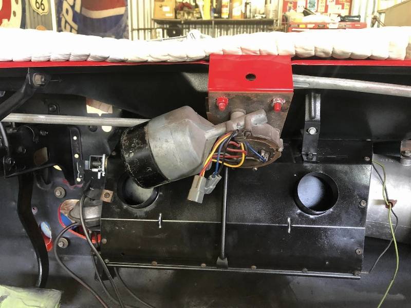

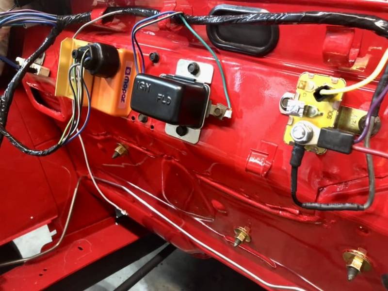

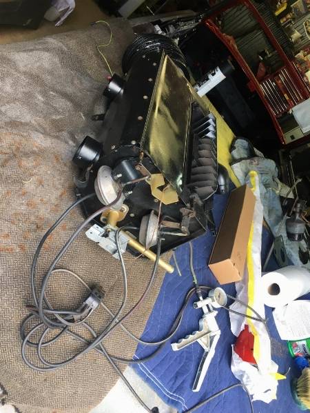

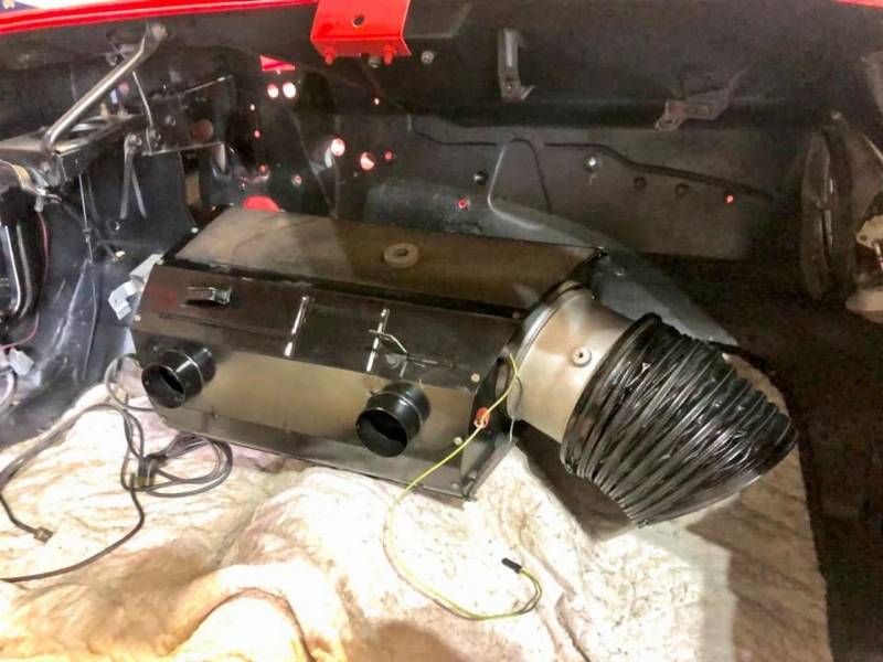

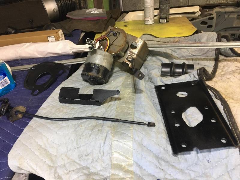

More on the 64... Got the Master Cyl. in. Mancini Racing with a disc/Drum preset design. Finished hooking up Heater Box, Windshield wiper motor, basically ready to put in the Instrument cluster now. Also got the firewall wiring harness and electronic ignition stuff on Firewall. We are adding Fuseable link wires and bringing Alt wire back to Starter relay post, drilling & Bypassing the old terminals in the Junction Box with new 10 guage wire (they were toast) and doing the Ammmeter Bypass.... I am using a NEW engine harness for electronic ign. under hood, and Factory existing under dash harness with the Ammeter bypass under dash.
