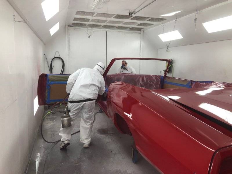

Well, it's Saturday.....
Monday I'll get it out of the booth unwrap it & bring it home.....
But it was a great day!!!

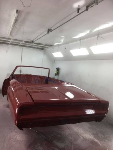

Looks fantastic!

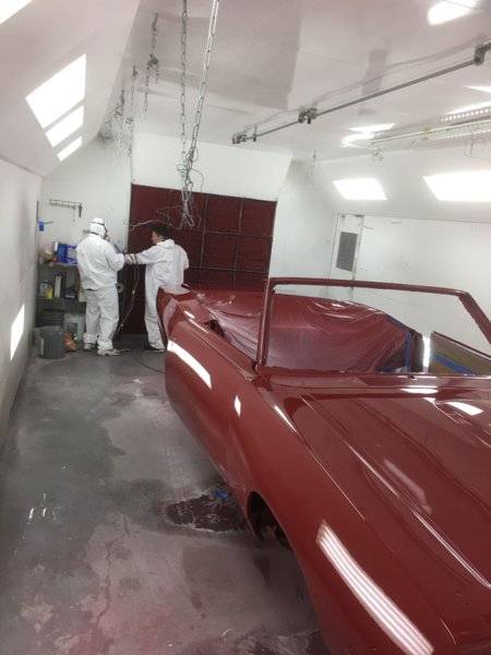

I think it has potential... I see something in the fourth photo that I didn't see in person... I think it must be a weird reflection, I know the hood is super straight so it can't have that big of a flaw...
I know I have a run in the tail panel but it is easily fixable.. The whole car is gonna get color sanded & buffed...
Waiting till Monday to get a good look at it's gonna drive me nuts....
Beautiful color and the car does look fantastic......The 4th pic is a reflection.....
Thanks! Yeah, it doesn't show in the seventh photo which shows the same area pretty well... Has to be a reflection...

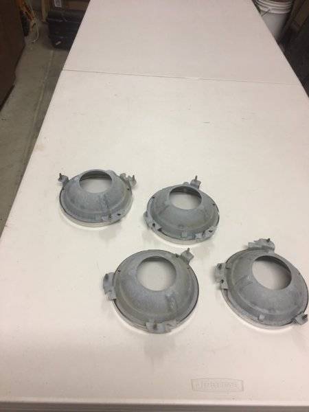

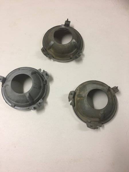

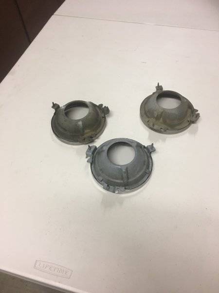

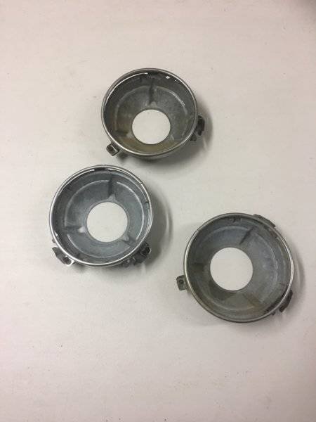

Ok, not much going on, but I'm cleaning up lots of parts that will be going back on the car & amongst them is the headlight buckets.... I've scrubbed them in the past with marginal results, I've had them re-plated but they never look right.... Not saying they look right this time either but considering how easy what I did was I'm pretty happy....
I tossed them in my ultrasonic carb tank with a mixture of water & Simple Green.....
Only one at a time so the missing one is in the tank.... And I'll post a photo when they are all done...
Looks good.
Years back when I had the Charger apart for paint, I took my headlight buckets to the bench grinder with the wire wheel. After cleaning them I developed a mean headache. I read later that the galvanizing treatment has some dangerous chemicals. I must have breathed in some airborne crap and momentarily melted my brain.
They look great. When I did mine I used the same method as the late Dave Walden used on one of his restorations. It was basically using 0000 wool and mothers polish. It took a long time but the results are very similar to yours with a lot more work. Keep up the great work, really enjoying your thread.
