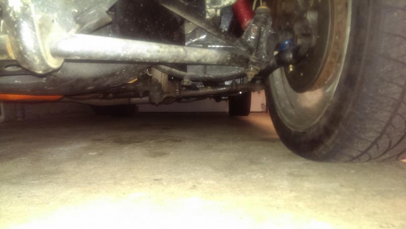

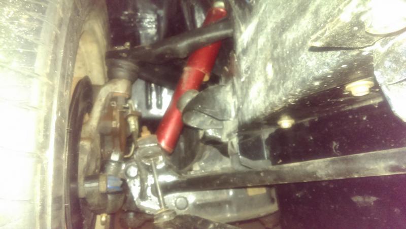

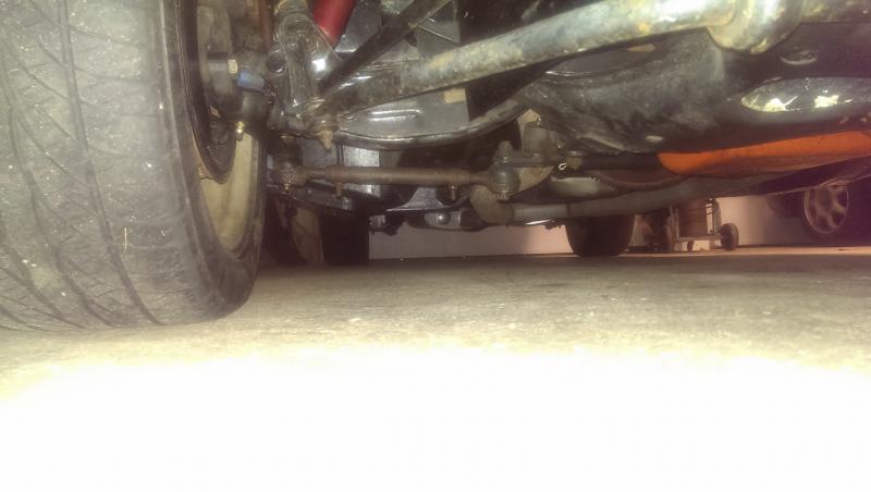

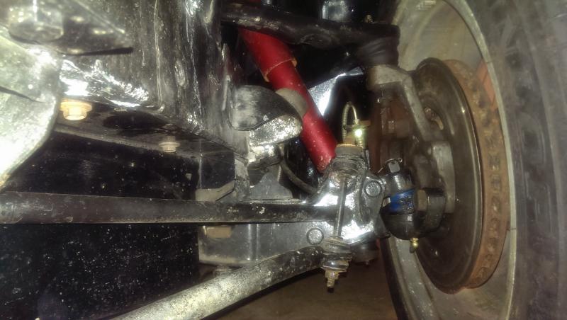

the center link & inner tie rods are all wrong
the center link looks to be in backwards ,it needs to be flipped around
i am trying to find some pictures
All the holes for the center link, pitman, idler, and tie rods are tapered and if things are put together wrong and tightened up good, there's bound to be damage either the fits or the joints or both. Inspect things closely.
Glad you found it out; I just saw your pix and the 3rd one told the story.
I still am concnered for you and your car: I would disassemble the center link joints again and REMOVE the center link completely and inspect all of the center link tapered holes VERY closely. I am sure you saw the tapered holes in the link ends. If any of the parts were installed inverted, then you need to check the small end of the tapered holes in the center link. If they are wallowed out too much from the tapered bolts being pulled in too tightly form the wrong side like they were, they will never hold for any length of time. The tapers will loosen up and then things will wear in a hurry. No need to take chance with something so critical on a valuable car. Replace the center link and any idler/pitman/tie rod end with a damaged/tapered bolts. Slight damage can be fixed with reaming or filing but only minor damage.
Whoever installed this wrong could have done more bad stuff than you have seen without full disassembly of the center link; it has been known for some rubes to grind/file the tapers when they get the worng parts or assemble it wrong. IMO, you won't be done until you have removed the center link and inspected all holes and tapers.
