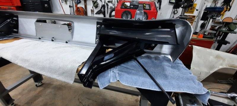

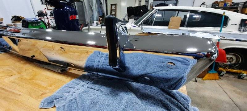

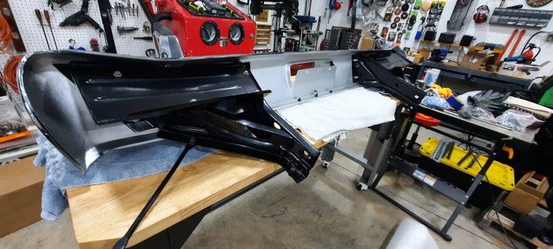

Hi diesel_lv,
The '66 bumper guards attach to the bumper itself, independent of the bumper brackets. They can remain installed during bumper removal.
Cheers! Tom
Actually, after looking at the location on a '67 Coronet, it looks like the inner bumper bracket holes are shared by the guards.
Either way, once the bracket-to-frame bolts are removed, fender support arms and turn signals are disconnected, it should come out.
