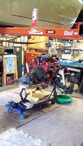

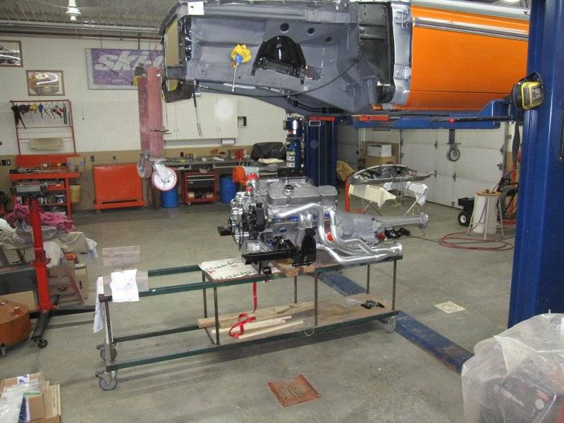

I used a cherry picker-engine hoist ....
I'll gladly post more pictures if you'd like. This setup was fairly low to the ground and easy to move.

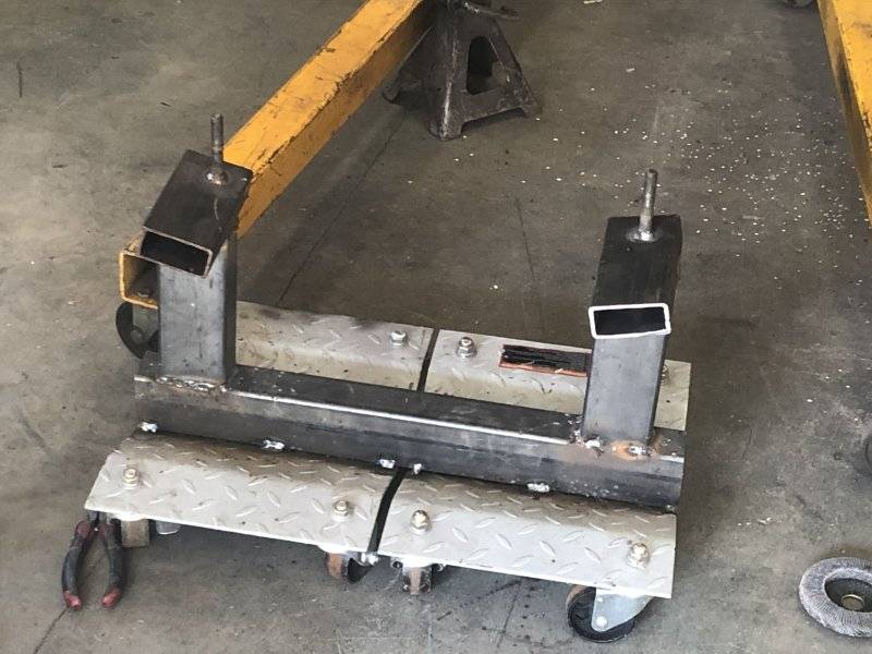

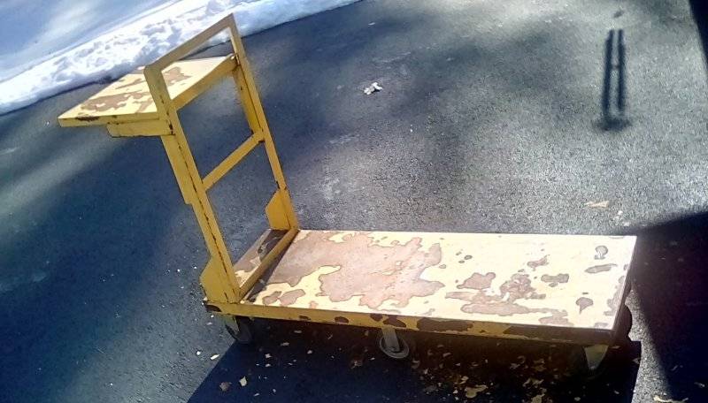

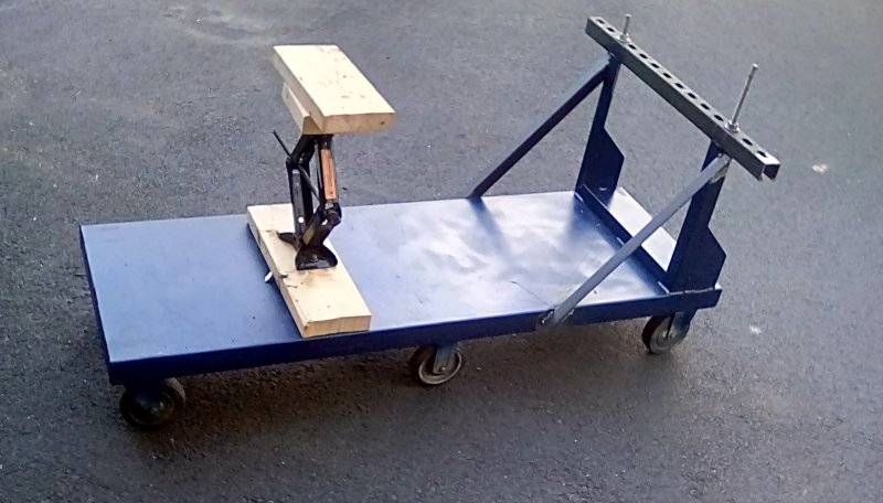

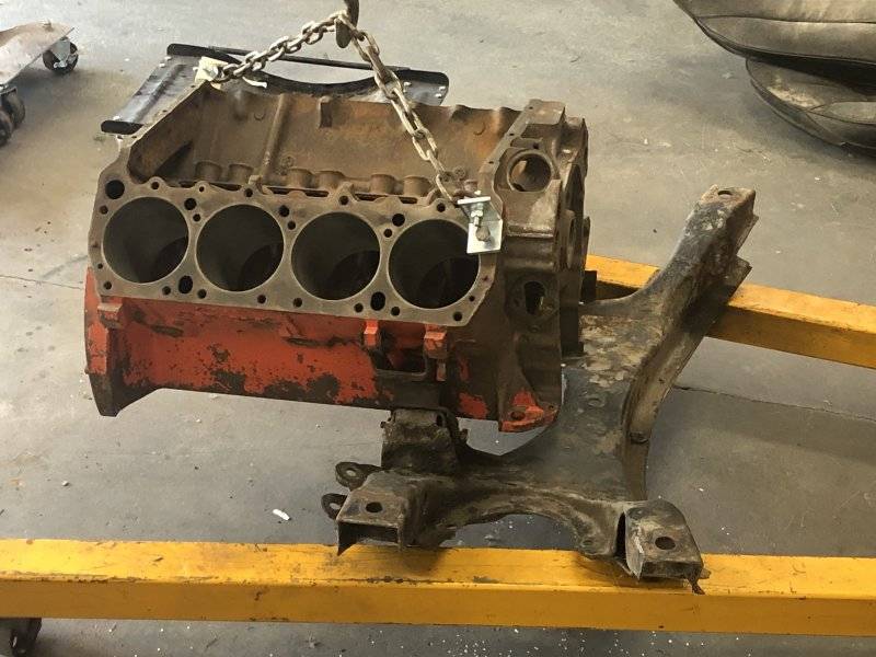

I made this but I have a lift. The cart is like one of the box store rollers that I found on CList.
I cut it down and used threaded rod to guide into the k frame holes. You could cut it lower.
just an idea.

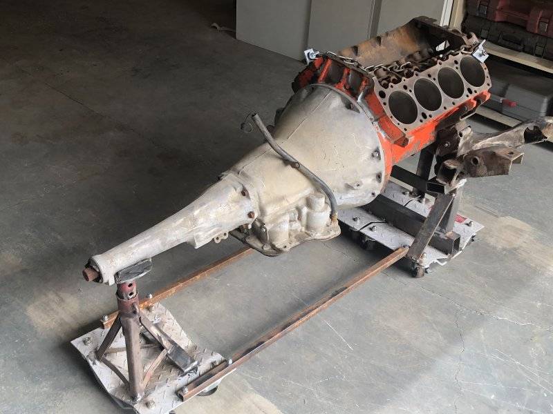

There is plenty of room to lay underneath the car with the engine and trans in place on the cart.

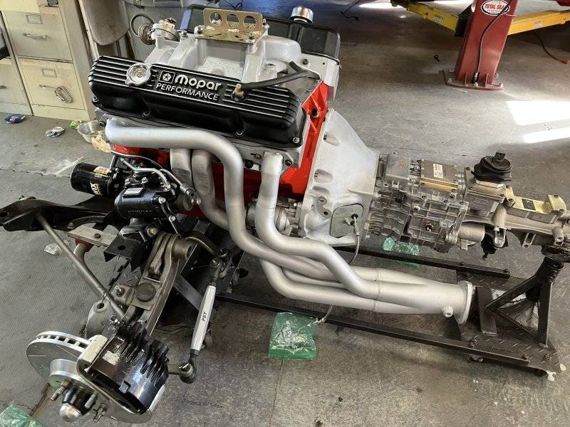

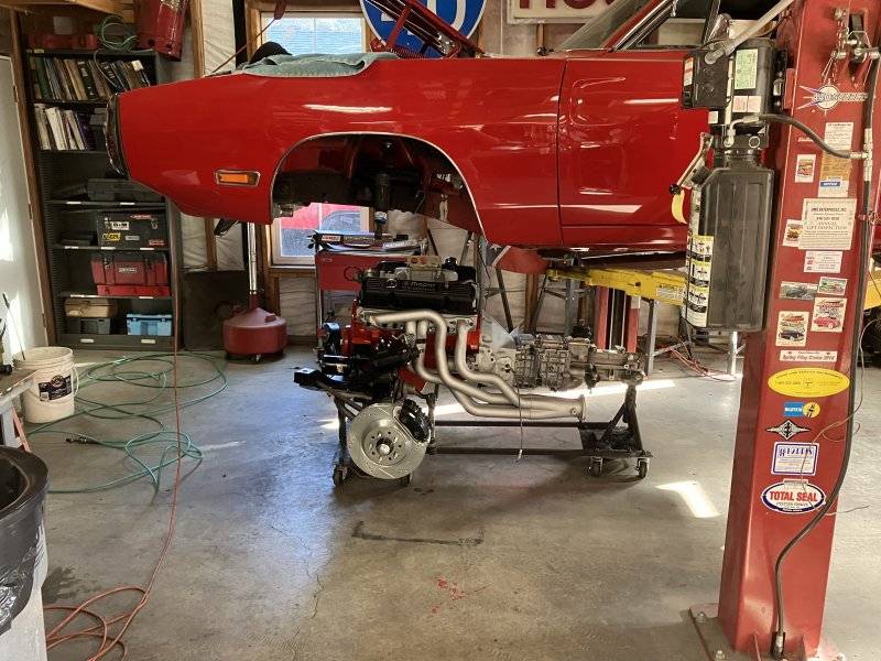

I didn't measure but I fit under the car well enough to start the K member bolts and to install the trans crossmember. I'm 5'10" and about 200 lbs.

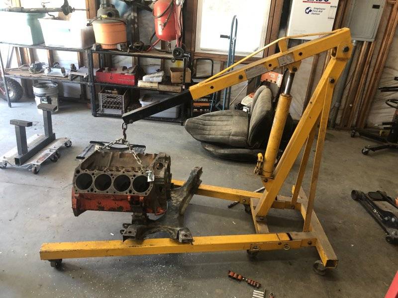

I've never done a complete 'assembly' removal before but seen it done. I'm thinking pulling the engine and trans as a unit then dropping the K frame by itself isn't any harder to do and have done it that way many times. No lift here but have plenty of helpful tools to do it the way I've been doing it for years and I'm a one man band. One of the most helpful items is something with wheels to 'catch' the transmission tailshaft on assembly when going in then jack up the trans to get the cross member in. I started out using an old creeper but a furniture dolly works well too. Just didn't have a dolly early on.
My cart was just a pair of car wheel dollies and some scrap steel.

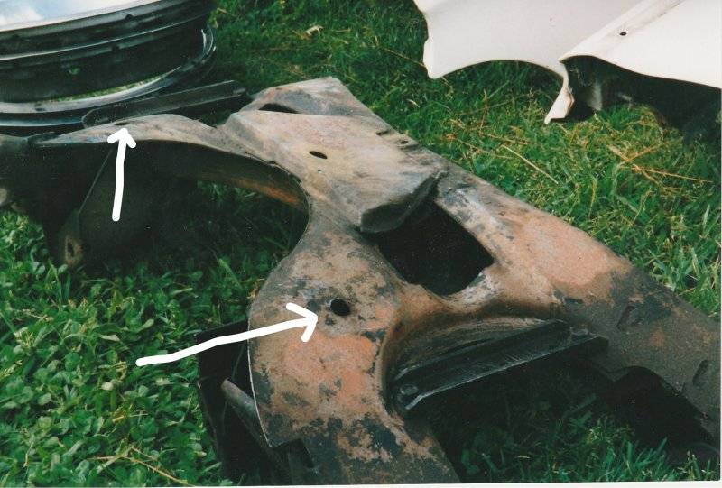

The pegs were to slide up into the holes in the bottom of the K member to keep it from sliding off.

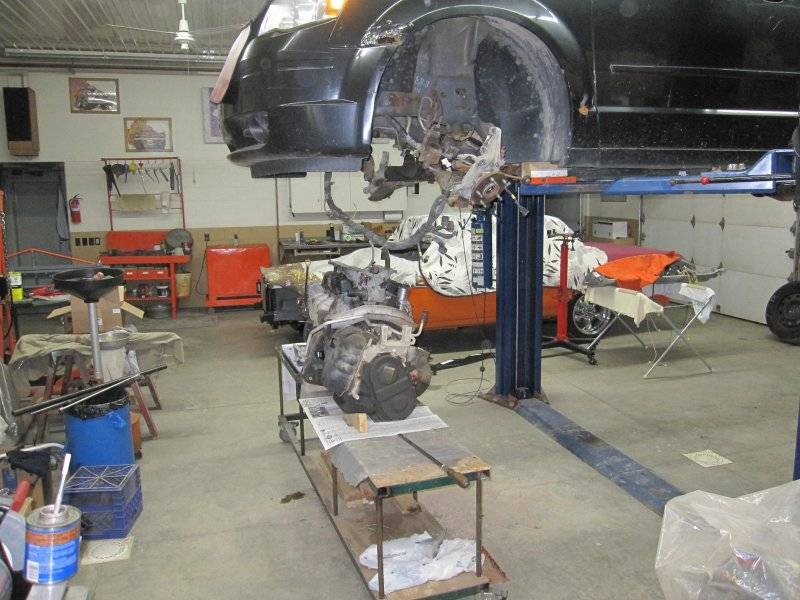

I built a cart with hospital bed castors to get my snowmobiles up to work on them comfortably. I pick the sled up with the hoist and roll the cart under. So, I used it for the install on my 65 and also on my 2008 Chrysler T&C engine rebuild. Hoists are still great (been using them since 1971)!
