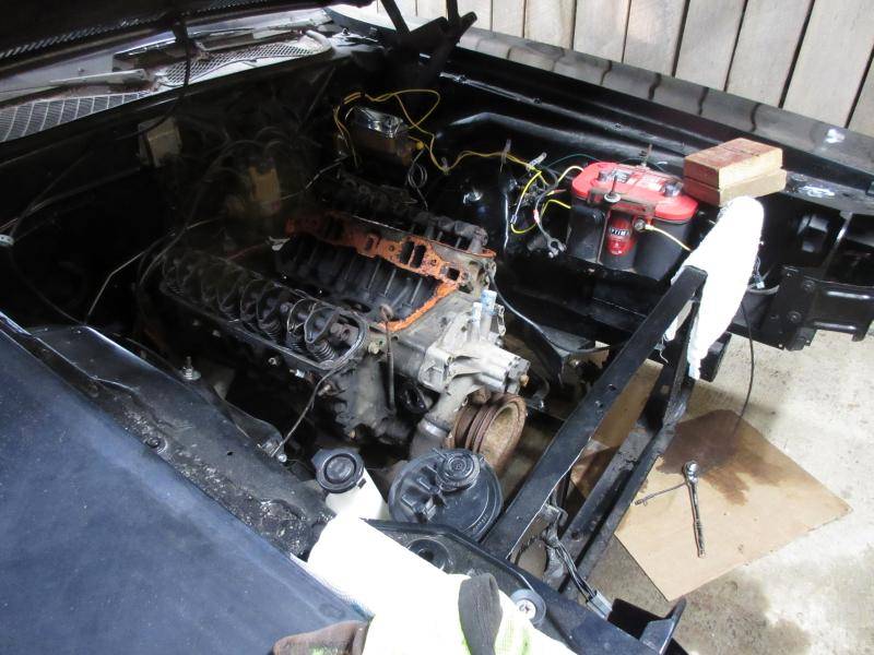

Not run since early 2000's.

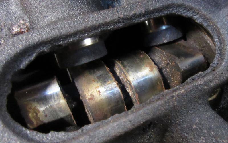

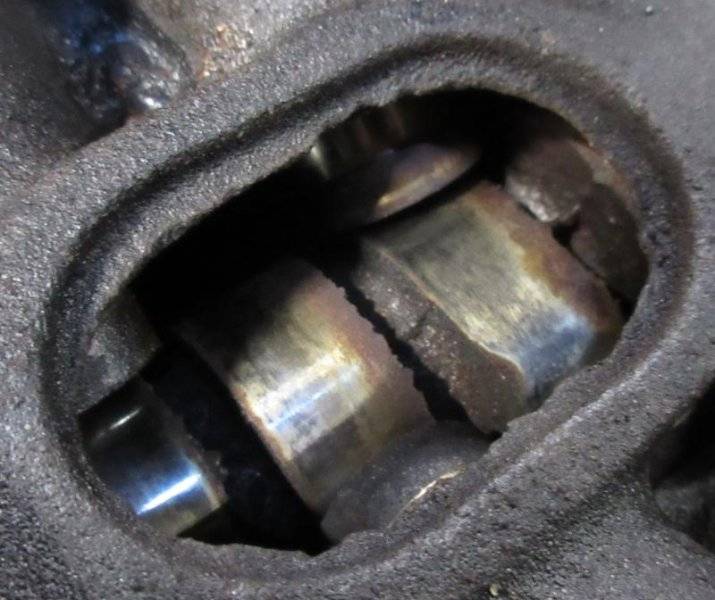

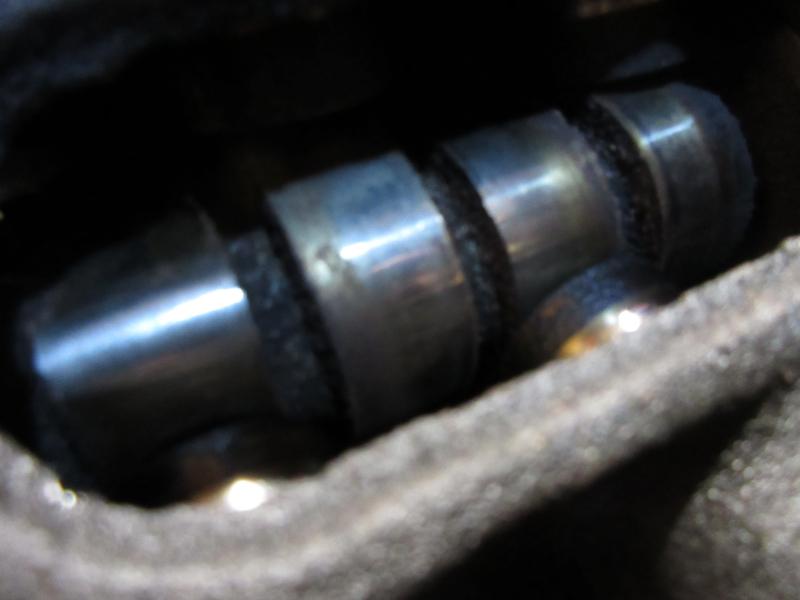

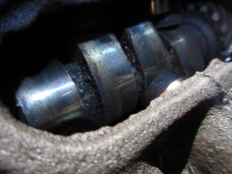

The condition of the camshaft -

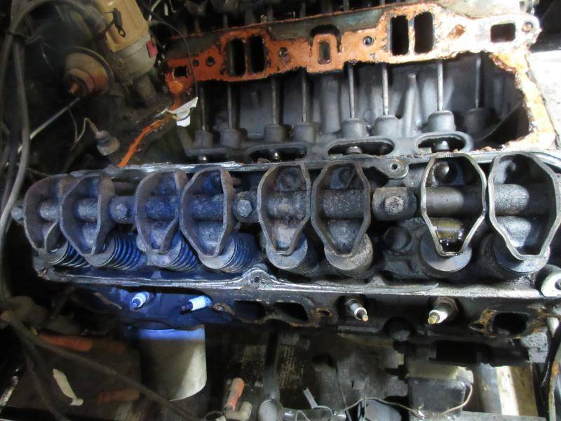

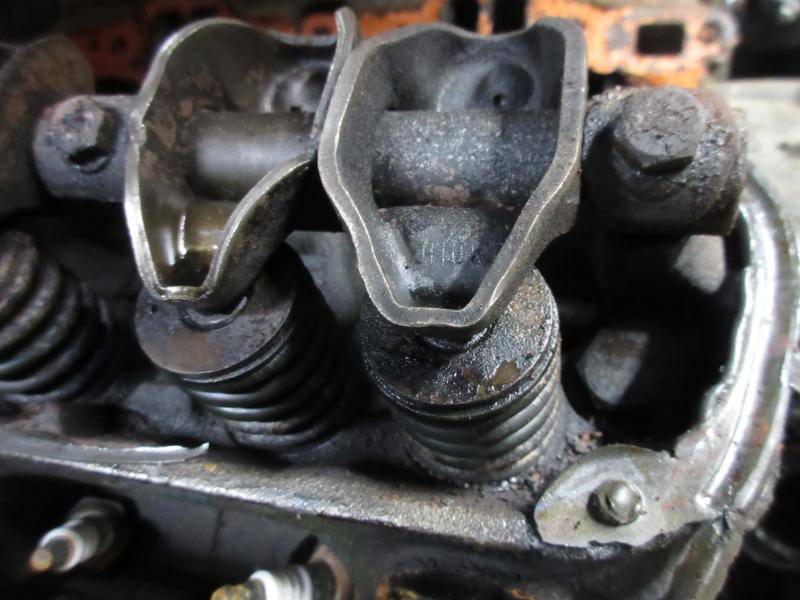

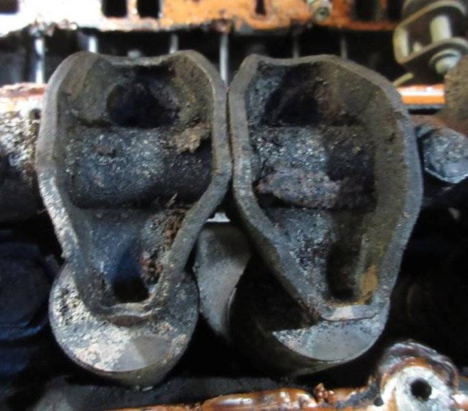

The condition of the valvetrain -

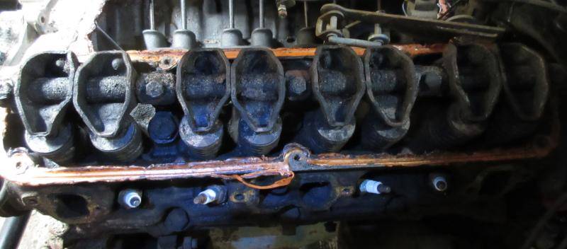

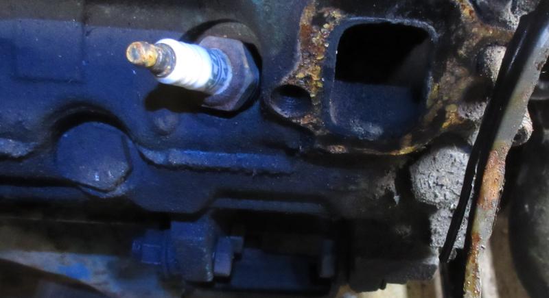

This is as far as I've been in a motor before. It looks like the heads are held on with these bolts along the bottom of the head, and around the valvetrain -
I'll have to look into how to disassemble it from here. I thought the heads would unbolt and lift off, but I believe I've seen the pushrods installed after the head, so they must come out first.
If the pistons and cylinder walls look o.k., my game plan is going to be to mildly upgrade this engine and find another one to build for power later. I feel like I've got enough to sort on the car without the possibility of screwed up engine internals. Porting and polishing the heads seems reasonable. Uncle Tony bought a big grinder off Harbor Freight, but I've seen another guy do it with a Dremel. I picked up a bunch of grinding stones for another job a couple weeks ago, and ended up not needing them on that job, maybe I can use them here. If it turns out the Dremel isn't powerful enough, I'll get the big grinder. I have a feeling this won't be the last port and polish I do.
The only problem with my mild upgrade plan is, this is a great time to do the camshaft; and AFAIK supply chain issues haven't gotten any better. I don't have the experience to spot a bad cam or lifter. I don't know about camshaft bearings either. Looks like that would be hard to do with the block in the car, but after 5 years of restoration, I'd like it to have a little more grunt than it did when I last drove it.
You might as well pull it and rebuild it, or just start thinking about building your dream engine now. It looks like this one may need more than a new set of gaskets and a fresh coat of paint here. It also sounds like you've never done this sort of thing before. This might be a good one to learn on. THere are many books on how to rebuild your small block Mopar. Buy a few and study up. You are already over your head it seems.
You need to start with a fresh/solid base. A 4 barrel and intake, dual exhaust and a nice distributor advance curve is a great start for a 318. Ported heads are way down the line as far as performance. Depending on what year the engine is, compression helps a lot. Hopping up a 8-1 compression ratio engine is like putting lipstick on a pig. The right way to do that is with some good pistons. 318's are easy to over cam. Too big of a cam and you are chasing your tail making it work with a high stall convertor and some different rear gears. Good luck.
At the minimum you need to find some rockers and shafts. And then what Toolmanmike said.
The engine needs to come out.
Not really, I've resurrected some in similar condition...
Change the cam, pull the heads off and wire wheel any rust and debris off the cylinders and head combustion chambers with a 3" or 4" wire wheel on a drill... Use a shop vac to suck out any dirt and debris after wire wheel, then put each cylinder at TDC and blow out them clean with compressed air at 90 psi, then another shop vac at TDC.. Then bring each piston down to BDC and lube the cylinder walls generously with STP or Motor Honey and then start to assemble...
Check the valves by filling the combustion chambers with water with the head upside down and make sure the valves are not leaking... Put the heads back on, and then clean up the rocker arms and shafts... Install another cam in good shape with fresh lifters and put the rocker arms and push rods back on... Install a good double roller timing chain - the stock timing chains are junk and should be **** canned...
Then put the rest of it back together and fire it up...

The rockers and shafts have sludge buildup on them. Does this make them not function and need replaced? Take the shaft assemblies off and clean them
Cam looks fine for a used cam, the wear surface is not all the way across the lobe only about half, like it should be.

I thought that it looked like huge scale rust. If its sludge, send it.
It's sludge.
