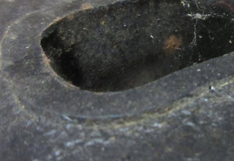

That one looks pretty dry.
Oil is good for an engine.

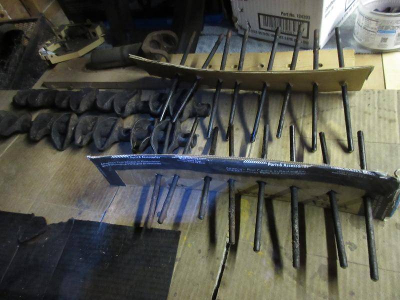

Rocker arms and pushrods removed and organized -

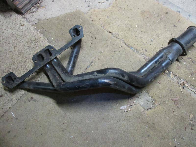

I've got these old Hedman headers from 94 or so. I was going to put TTI on it, but these are here and I suppose they'll be fine until I get drop spindles on the front.
I'm wondering about the lip here where the pipes weld to the mounting plate, will this be able to seal o.k.?

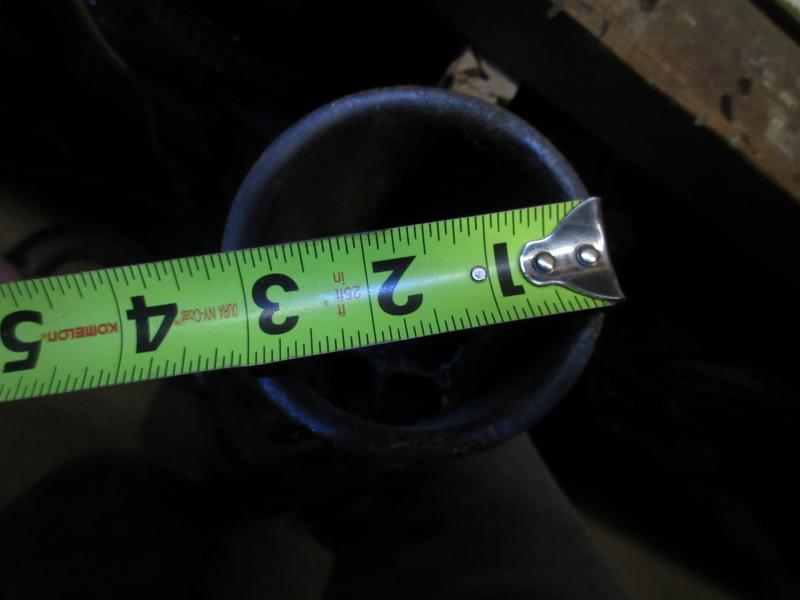

I ordered these and a crossover pipe and mufflers when I was 18 or 19 - didn't know anything about cars or anybody who knew anything about cars. The pipe sizes may not match up. On the headers, it looks like I've got 1 3/4" pipes dumping into a 3" pipe -
I'll have to measure the other stuff later.

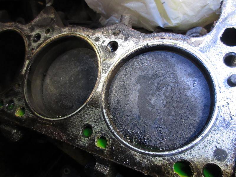

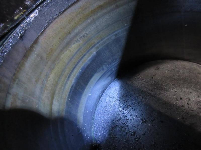

Got a 24" breaker bar. Much nicer to work with but the mail took forever. Anyway, head bolts are out and one head is off. The pistons appear to have plenty of carbon on them - I've never been into an engine this far before, but I'm guessing that's what it is. I was hoping to see some cross hatching on the cylinder walls, but none is apparent.
