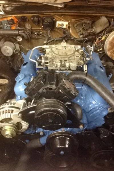

Feb 2018 - mechanic swaps the single plane for a dual plane Edelbrock Performer. Swapped the valve covers from the 318. Paint the engine blue
Feb 2018 - fired up for the first time (pre-oiled, too). Engine runs crappy. Leakdown test shows 25% blowby in all cylinders. Low vacuum. Cam is a mystery, Rick only knows it has a Mopar Purple stripe cam in it

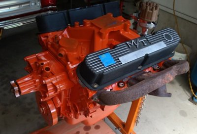

Pic in prior post was the one Rick sent when selling the motor in June 2017

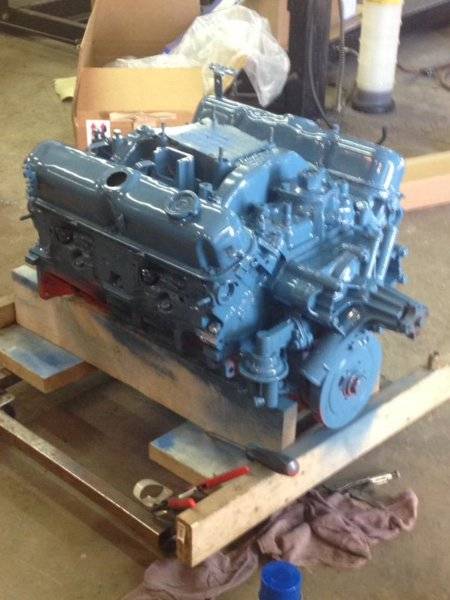

ere's the motor in the mechanics garage in Sept 2017
