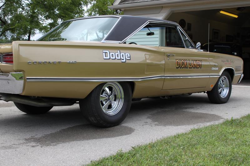

Hey.... I put the full Cal Tracs on my 67 Coronet last year, running a 528 Hemi, in street clothes, still working on setting the car up , but so far I think they work good. I have the car running 11.50 and seems to run consistant . Good Luck with yours. 081012 010.jpg

Hey.... I put the full Cal Tracs on my 67 Coronet last year, running a 528 Hemi, in street clothes, still working on setting the car up , but so far I think they work good. I have the car running 11.50 and seems to run consistant . Good Luck with yours.View attachment 104157

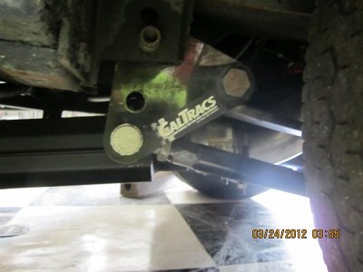

I have a 66 Coronet. Car is minitubbed and springs are moved in. I went with Calvert's whole setup. Bars, monoleaf springs original ride height and 9 way adjustable shocks. Parts were extremely easy to install and took about an afternoon. Yes, right out of the box install, no modification was needed. Left the adjustment in the bottom hole for now and the car was planting the tires hard at the track! I say go for it!

i have a set on my dart and plan on putting a set on my dads 70RR. i ordered mine right from calvert. used their spings and shocks also. the thing that nobody ever mentions is you need to beef up your spring perches, if you have a decent powered car you will bend them, i found out the hard way. calvert sells nice perches. took some playing to get my dart to hook, but its nose heavy.

Real nice job on the install.I'll have to keep an eye on mine.My Cal's are so old the shocks are only 5 way adjustable:confused4:
Yup, we knew about beefing up the spring perches and did it before hand. It's one of of first things we do when running leafs.
