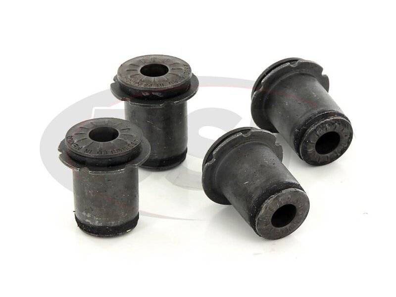

Please verify both of the cup washers are installed on each the new UCA bushing. I've had them fall out when installing. They have a short collar that goes in the rubber and makes contact with the inner steel sleeve. The ridges on the washers also dig into the steel to keep it from sliding. You can raise the front and easily look at them over the tire. If either is missing you'll never tighten it enough to keep it in place without destroying the bushing.
Thanks, When I pulled the UCA out for inspection they are all on.
