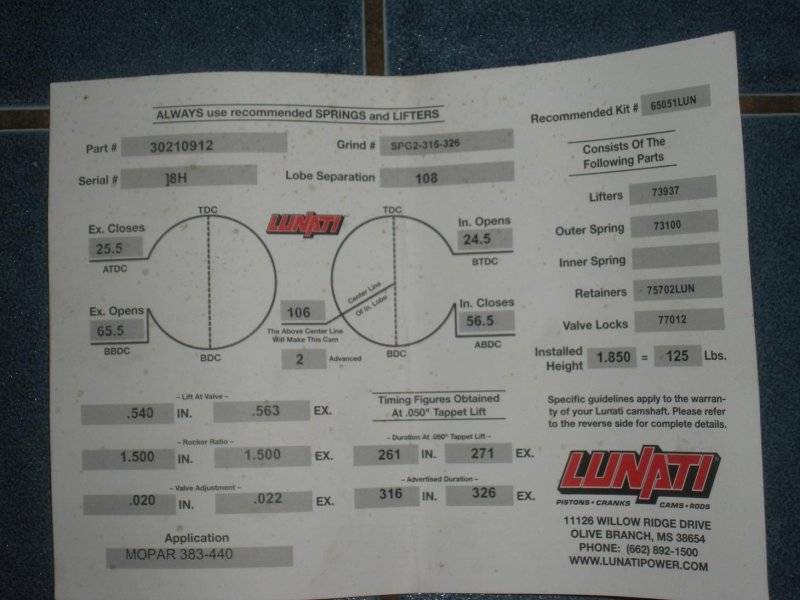

Thanks Kern, yeah your engine is a little different then mineI have a Lunati solid flat tappet cam in my car.
The numbers make it seem pretty wild but it idles with only a slight lope. The car was faster than ever with this cam when I ran it last time. I have Howards EDM direct oiling lifters.
It is too much for a low compression stock stroke 440 but the Lunati name is a good one.
703 was the one recommended to me. I don’t know if it’s too much for little and 440 power brakes. I’d like a little more kick in the pants, but drivability, and fuel economy are a big concern.
