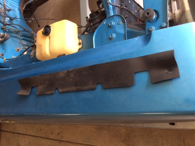

Thanks to all that have commented, here is some additional information: the material is non-metallic and stiff. It almost feels like a thick tar paper used in roofing. It measures 3" X 24" X 3/16" my guess on the material is old hard rubber. The hood to radiator seal is still in place and is soft and very flexible.
I had it stored with the radiator so I thought it mounted close to the radiator. Seal.JPG
wiring guard at the inside of the door sills under the carpet?
That looks to be made of rubber. I'd guess it is supposed to be attached to the hood to direct incoming air to be directed into the radiator instead of between the hood and core support.

I believe this is what this piece is for, but not for a 69 Coronet. Are you sure this is from your car? I have several 69 Coronet models and do not recognize it.

Thanks to all that have commented, the material is non-metallic and stiff. It almost feels like a thick tar paper used in roofing. It measures 3" X 24" X 3/16" my guess on the material is old hard rubber. The hood to radiator seal is still in place and is soft and very flexible.
If you turn it vertically, do any of the slots line up with the radiator mounting bolts? Just guessing here.
I've checked all around the radiator to see if any of the patterns line up with out any luck.

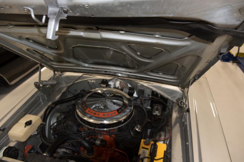

My 68 Coronet R/T has a similar looking piece of hard rubber attached to the inside front of the hood just behind the latch... see the attached photo._KCM1606.jpg
the piece in question does not look long enough to be a hood to core support seal...at least to me

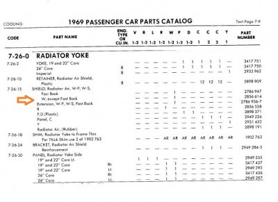

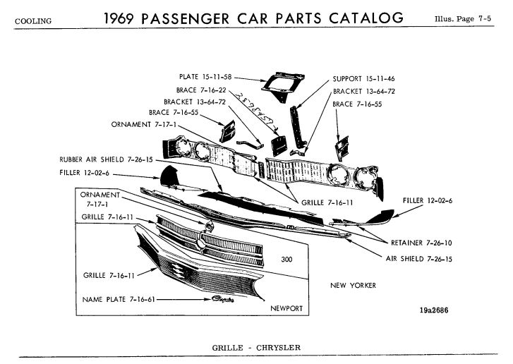

Is it this part? In the 69 parts catalog on illustration page 7-5 item number 7-26-15 rubber air shield?

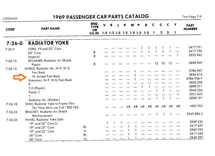

I think Ghostrider is onto it. While the parts manual shows this part under the Coronet with 3 different numbers, the descriptions don't make sense....fast back Coronet? W, except Fast Back, 2856614 seems to be the only logical possiblity.

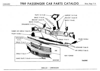

With that said, none of my Coronets have this piece on them. I do not believe this is a Coronet part especially since it is listed under the New Yorker detail. See parts manual sheets below.
D

The radiator is 26" so there is an option that precipitated this. The parts manual sheet above lists the part as "Radiator Air". I suspect this means air conditioning and this is a corresponding sheild? It looks to be cut to clear the lower radiator hose, drain, and automatic transmission lines.
