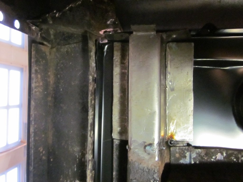

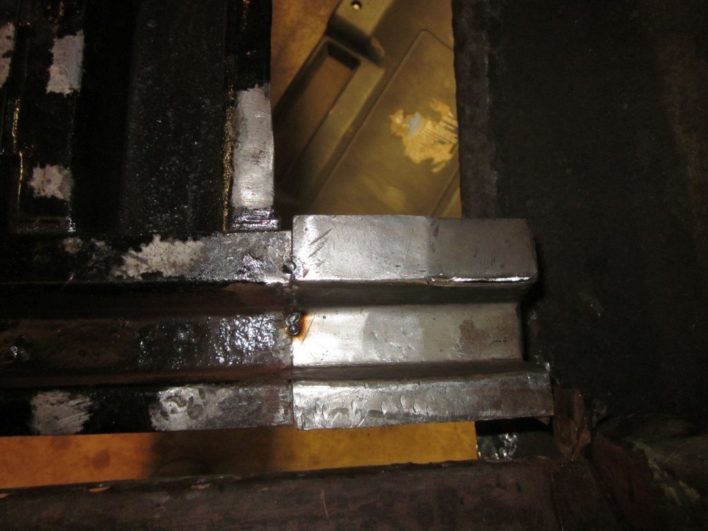

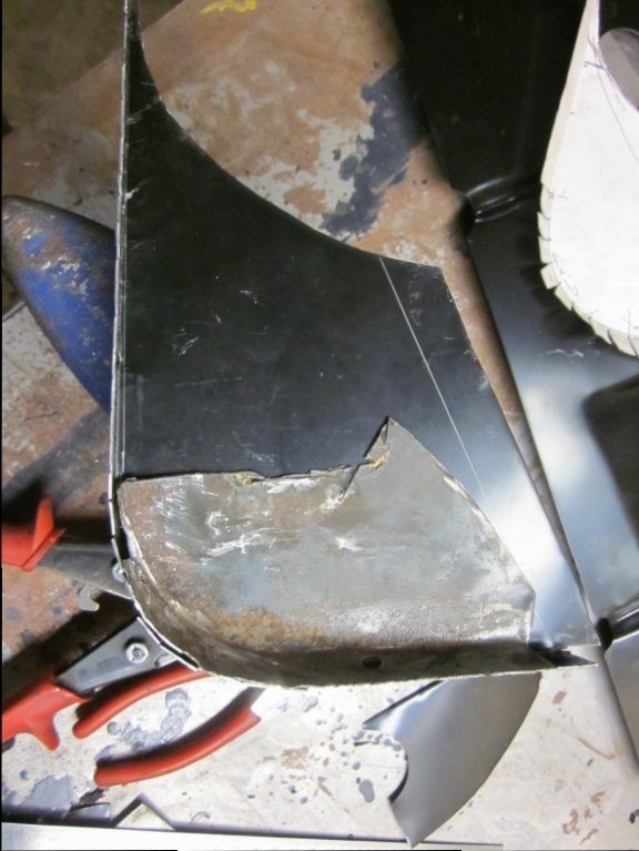

Good, 75/25I think it's called C25 Argon mix.
Check your flow for about 30cfh.
When you get into the rusty stuff, clean is key but the pitting is what gives you trouble. Place a backer where you are welding for a heat sink. Ideal would be a piece of aluminum with a little nozzle dip brushed on it in case you blow through. The dip keeps it from sticking.
