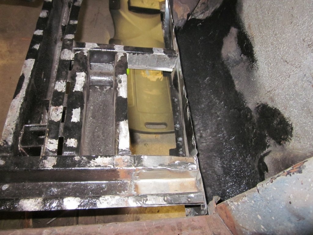

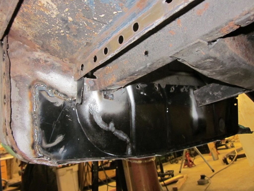

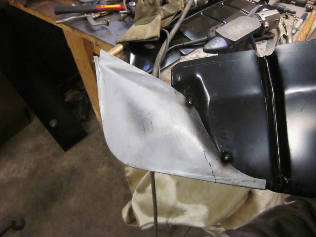

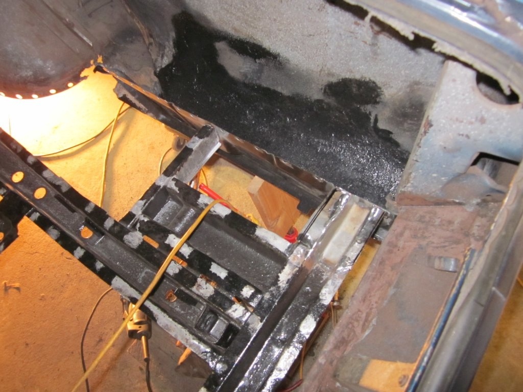

Welded up the curve and cleaned up the welds. It fitted pretty good, but I wasn't sure if I should tack the patch in place or tack it to the extension. I decided to to the latter and make it one solid piece. First I tacked it together to be sure I could get it out and back in as one piece. Worked great.

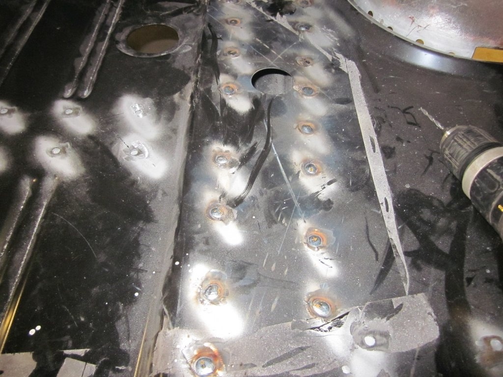

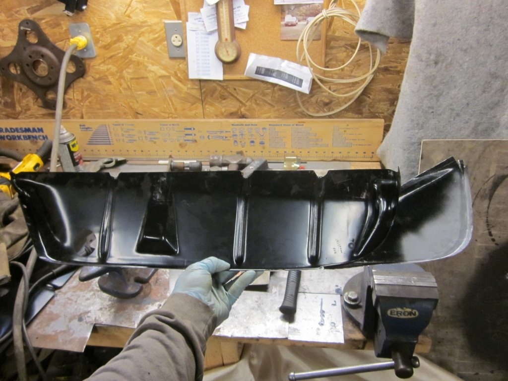

After welding the two together solid and clean up the welds, drilled out holes for plug welds, it is ready to install.

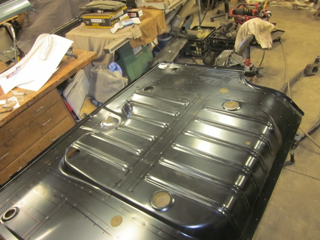

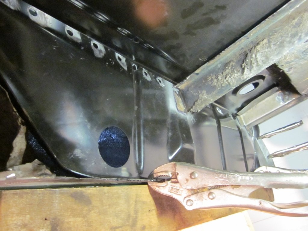

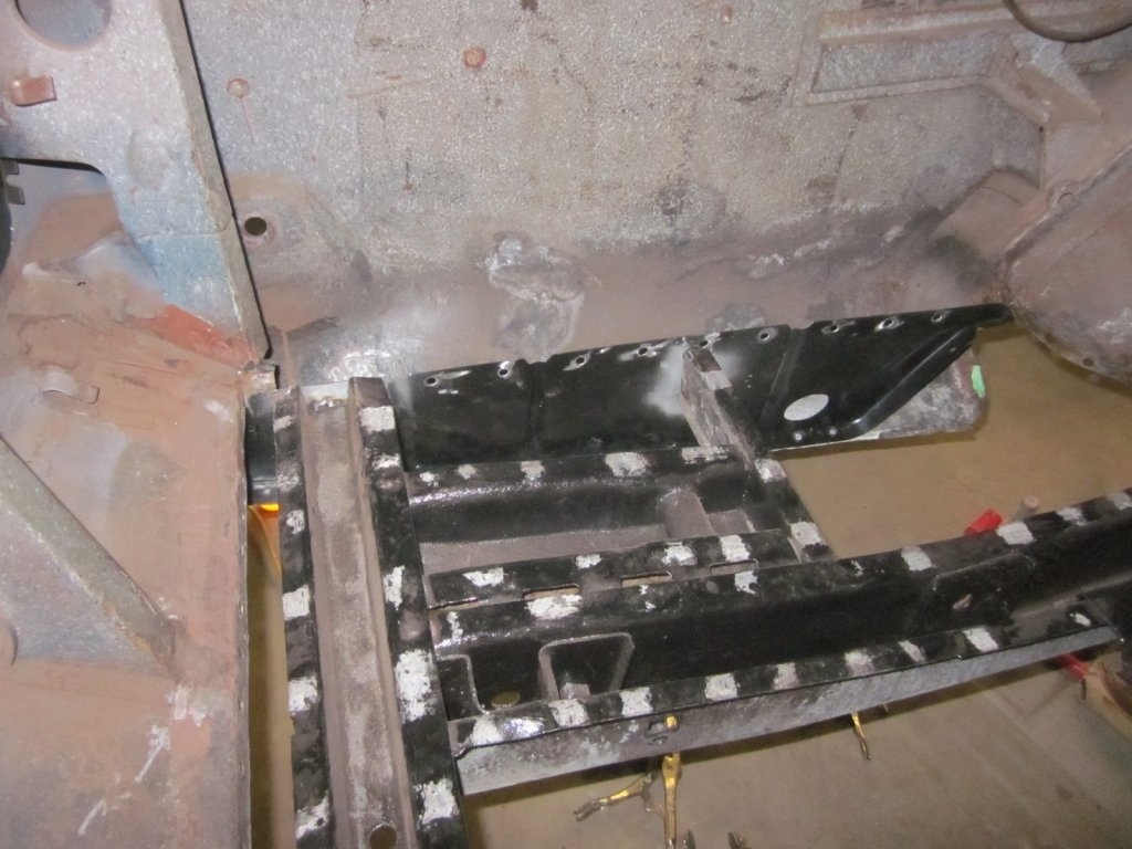

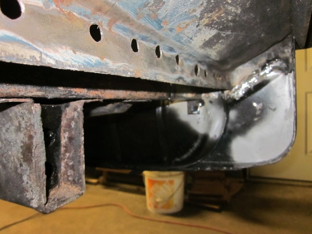

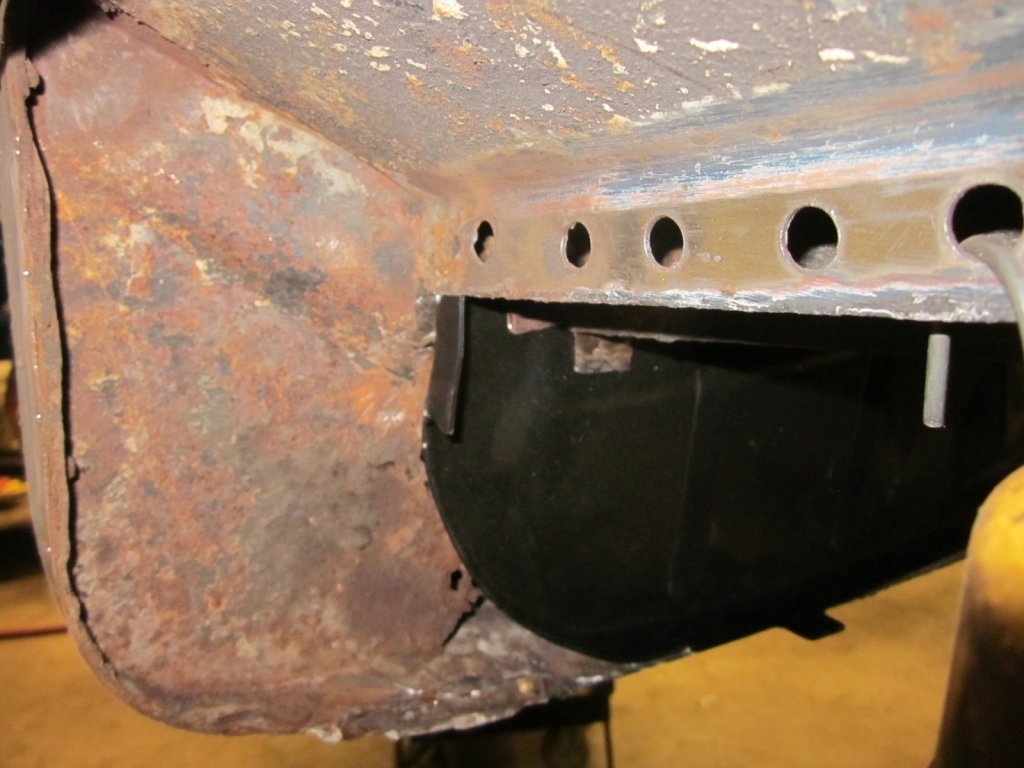

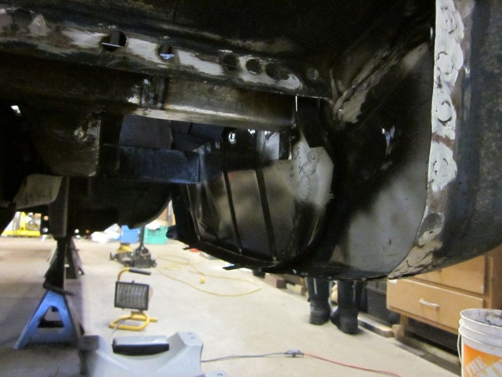

I placed the extension back in and fitted again (5th time!) with the trunk pan and clamped it up.

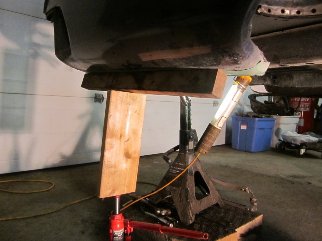

I was concerned about the correct height, which if too low, the pan overlap would not be enough to weld together and if too high, the pan will not sit flush. Lots of measuring and cross measuring, etc. I used a bottle jack to raise it where I wanted it and welded away.
