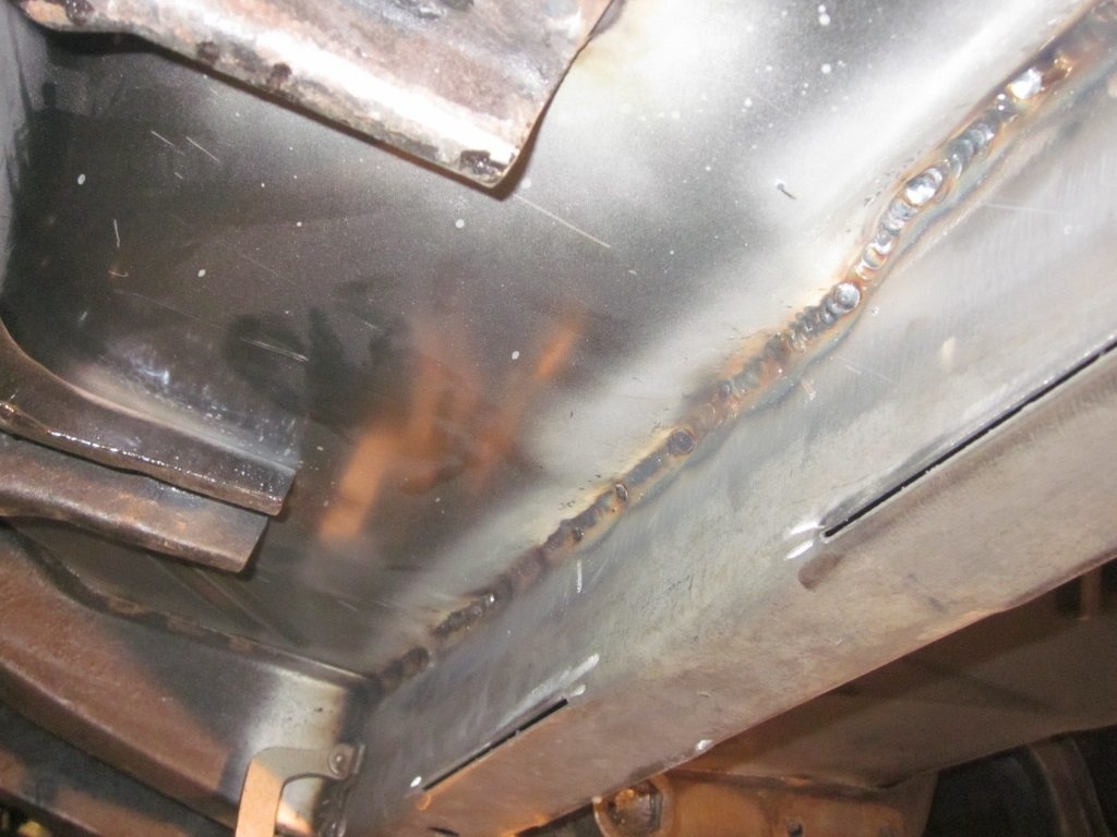

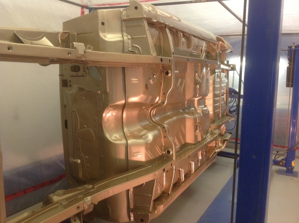

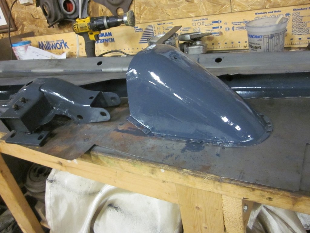

With both sides ready to go, I decided to coat them with epoxy after I cleaned off the zinc coating with a wirewheel and degreased.
Good time to blast the filler tunnel and epoxy as well. It had a lot of surface rust and took an hour to blast.
Good day's work done!
