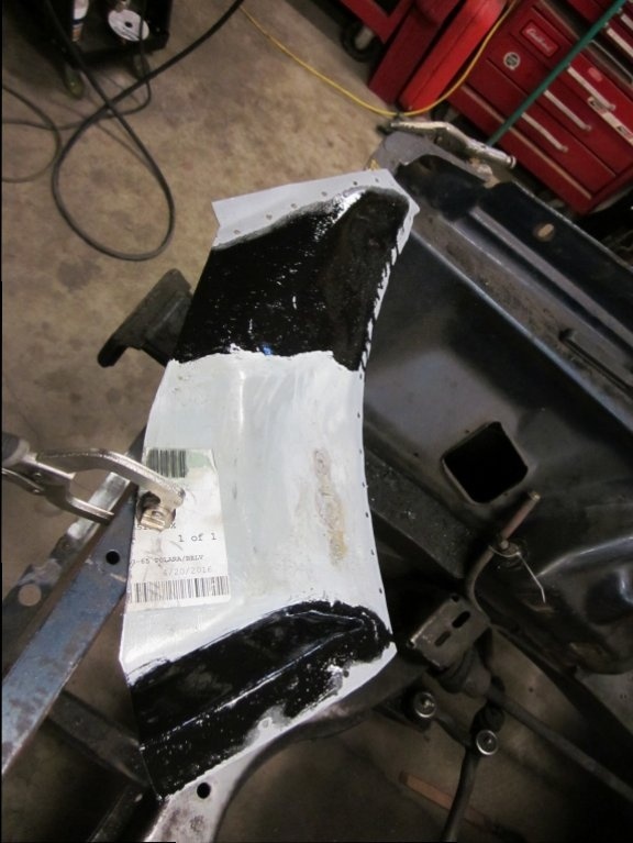

			Thanks GTX! The sherman parts don't fit well but I wasn't expecting them to. I imagine the high cost to produce accurate stampings for this small market part is hard to justify. I'm just happy to have something availble to work with.Good progress! I always heard if you have a choice choose AMD over Sherman parts. But if that's all that's available then you have to make due. Looks like you have the skills to "Get R Done".

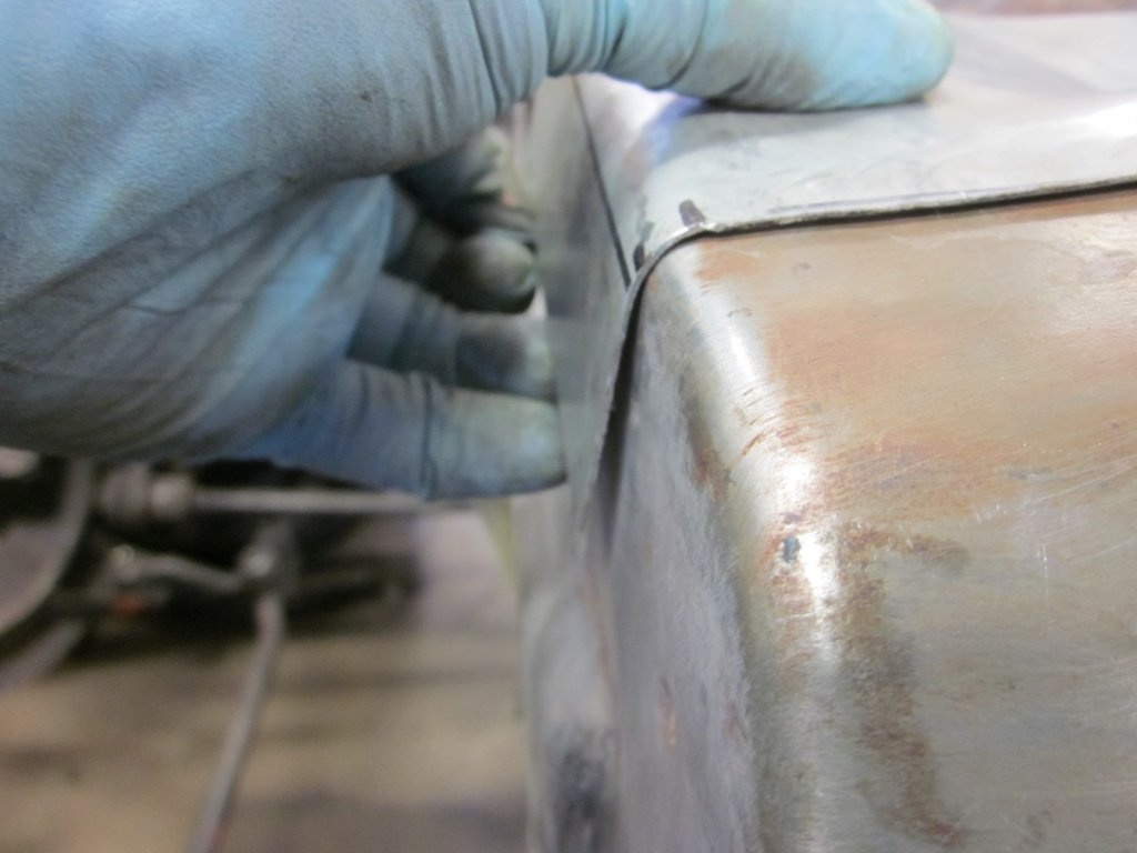

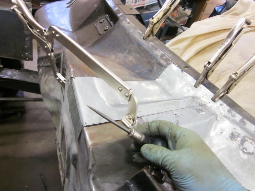

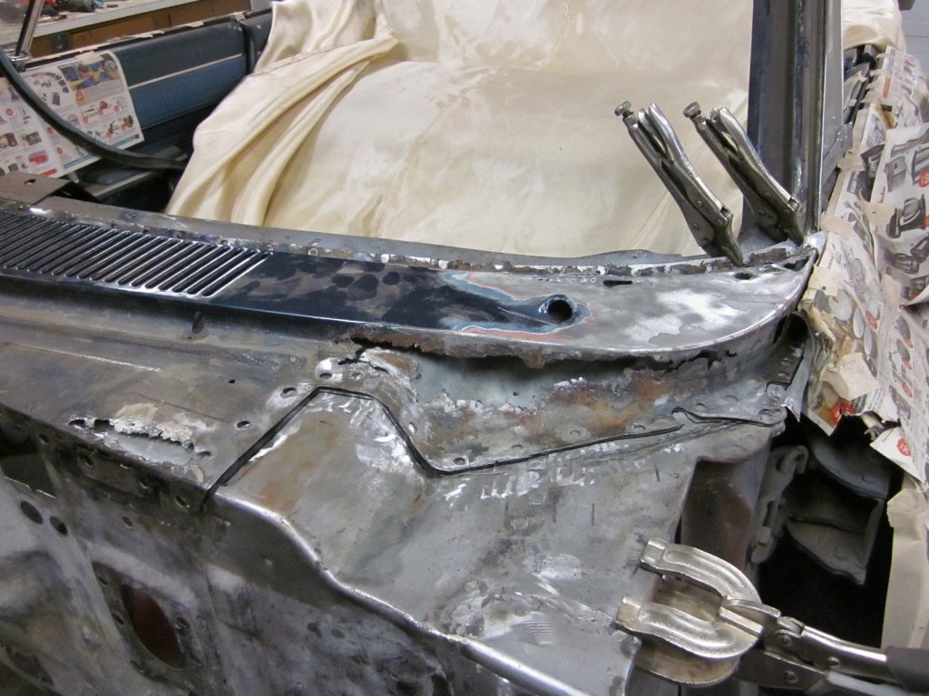

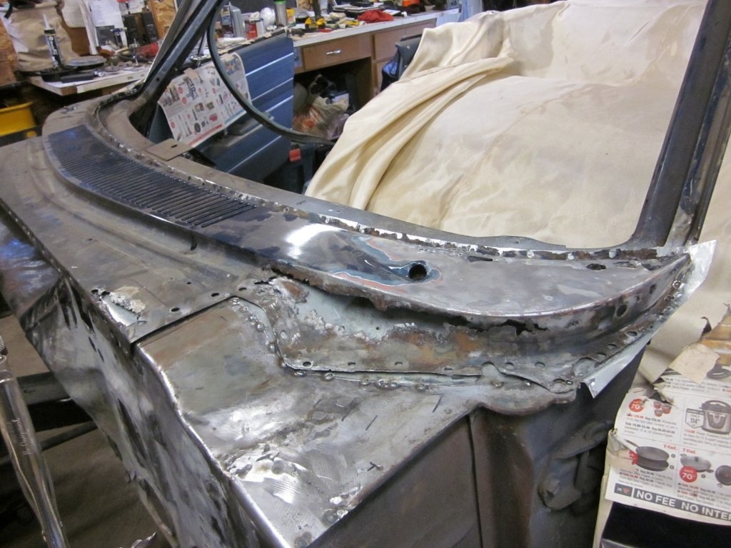

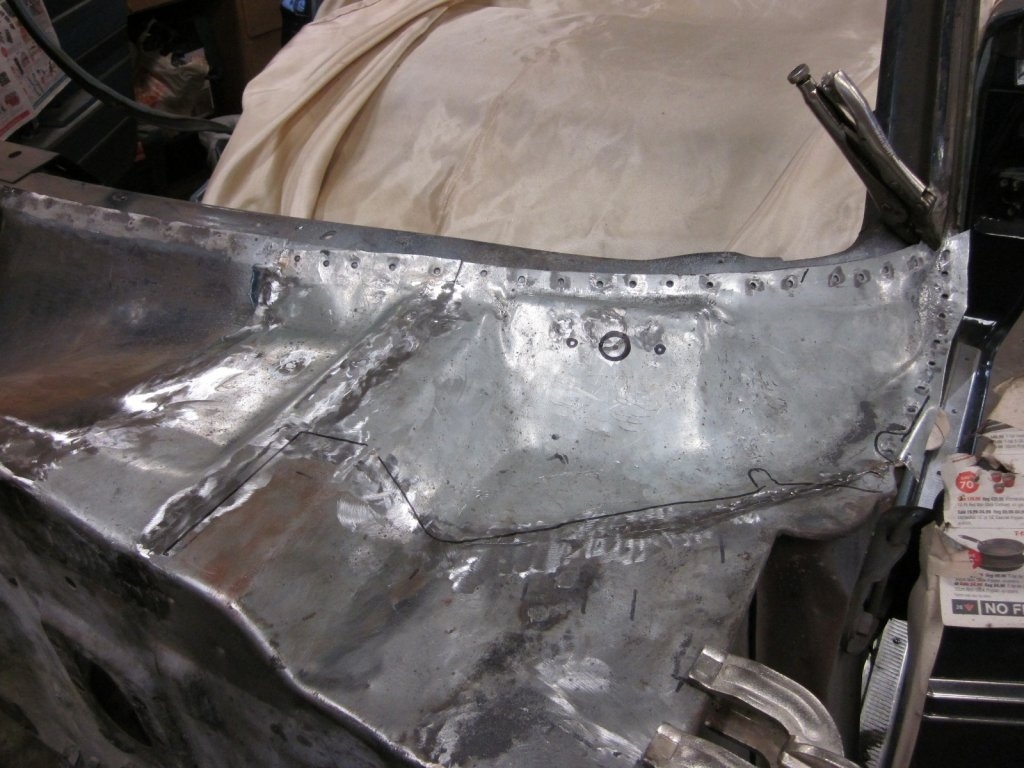

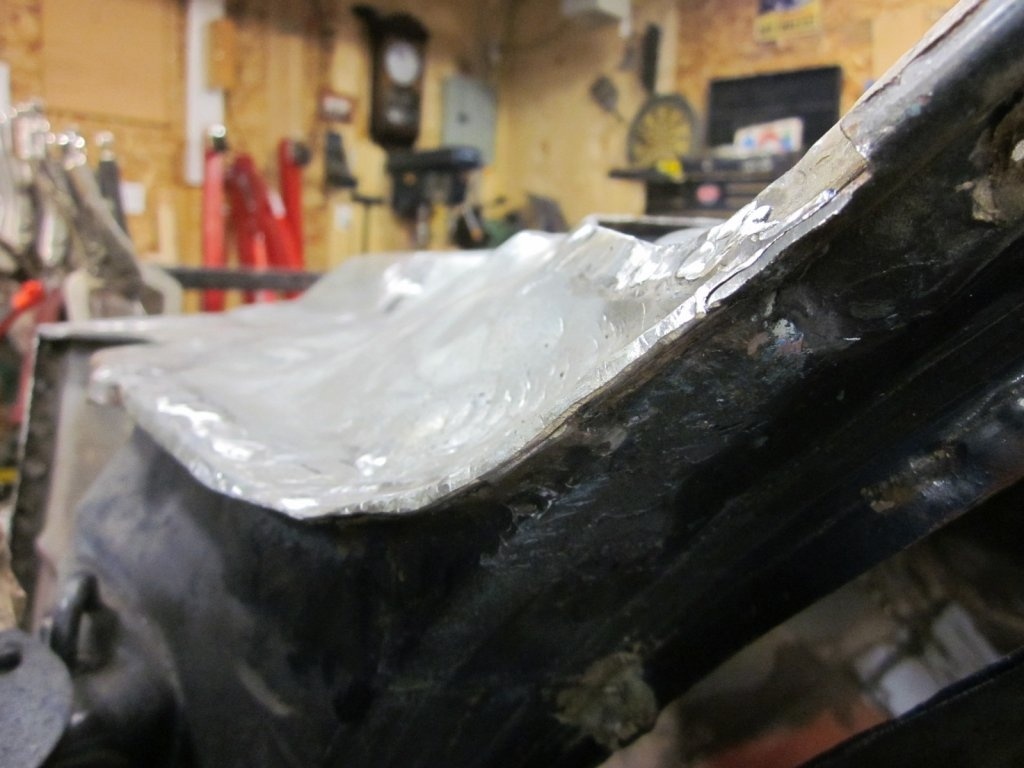

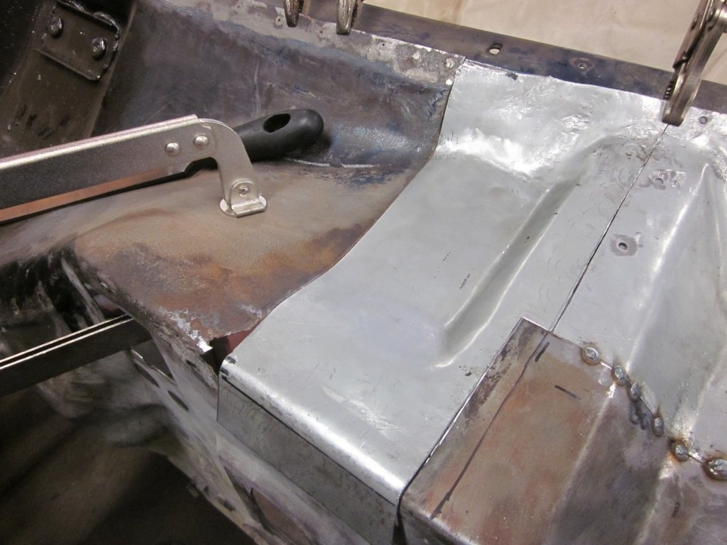

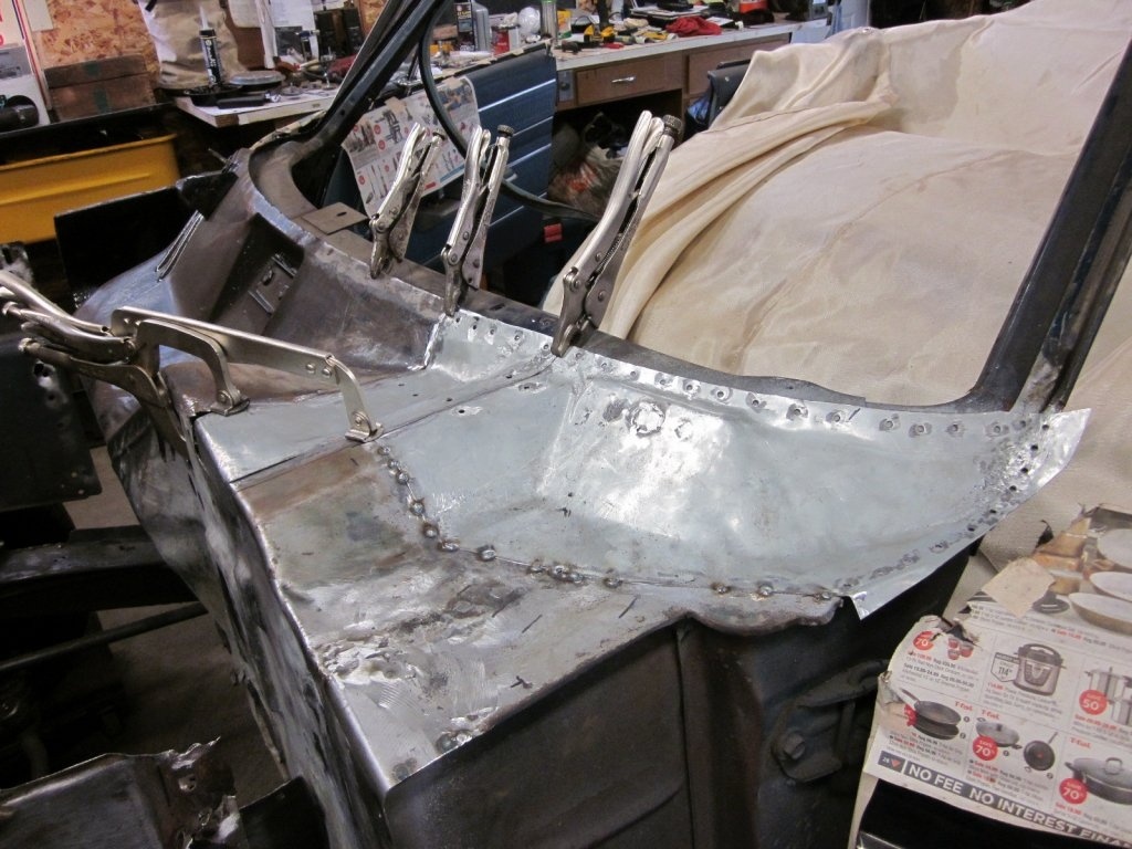

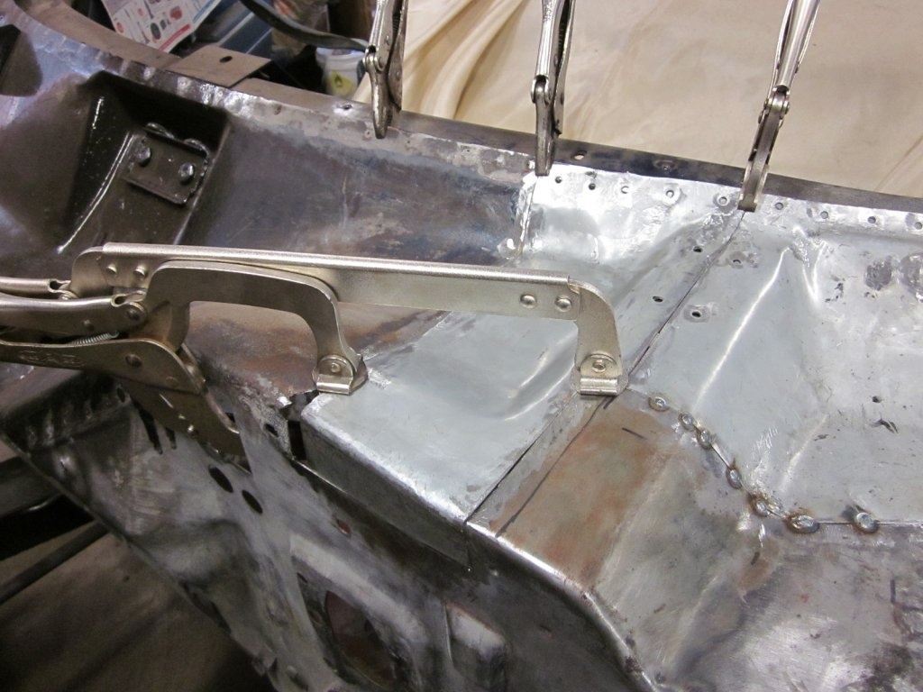

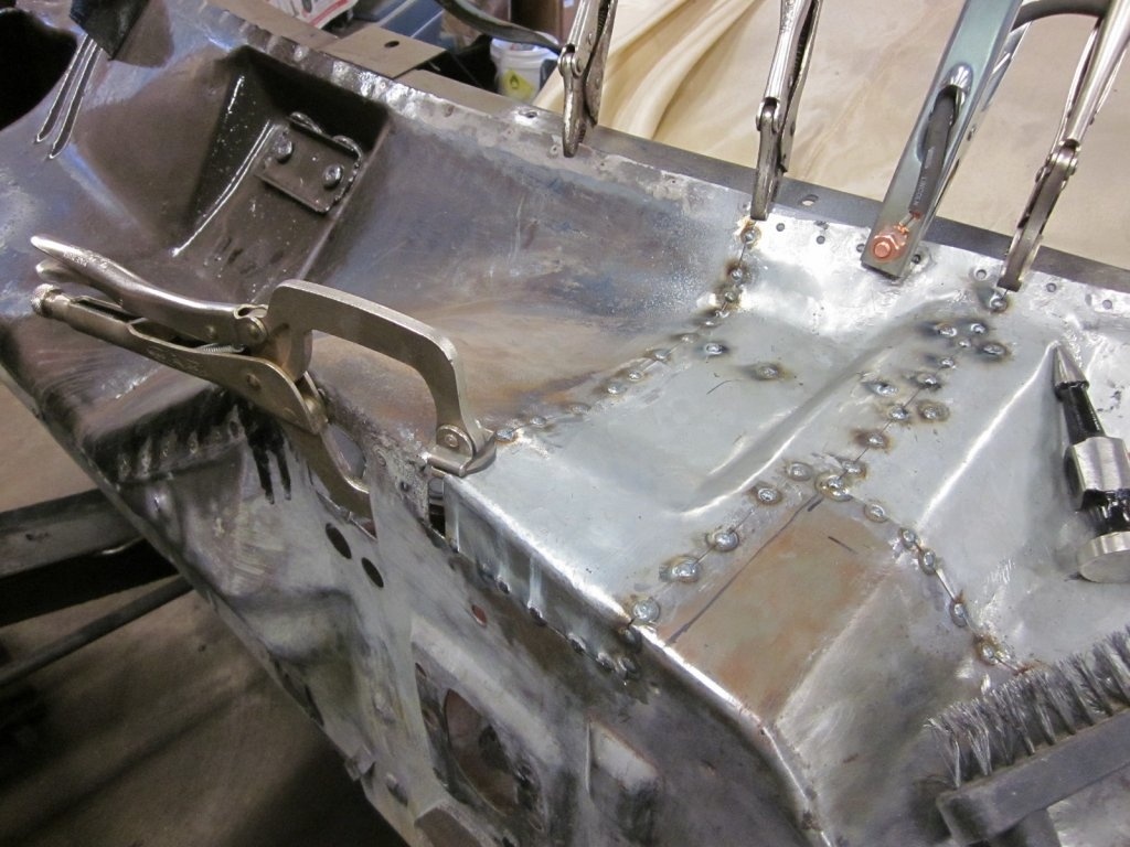

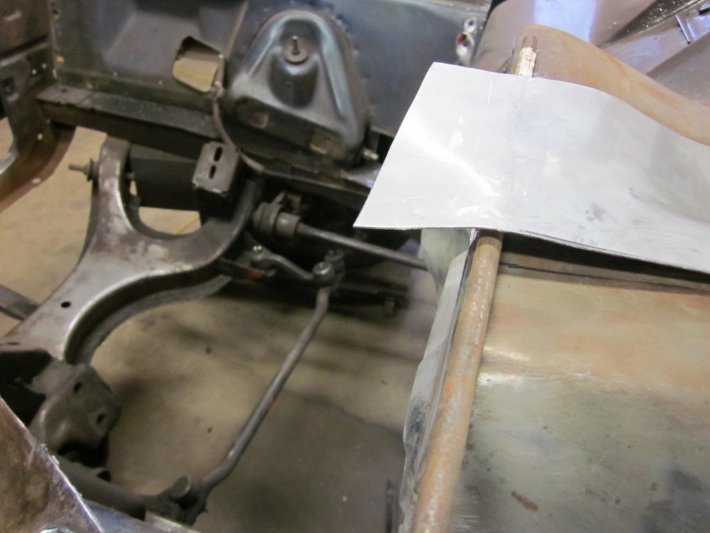

Tightening up the gaps for some final fitting.

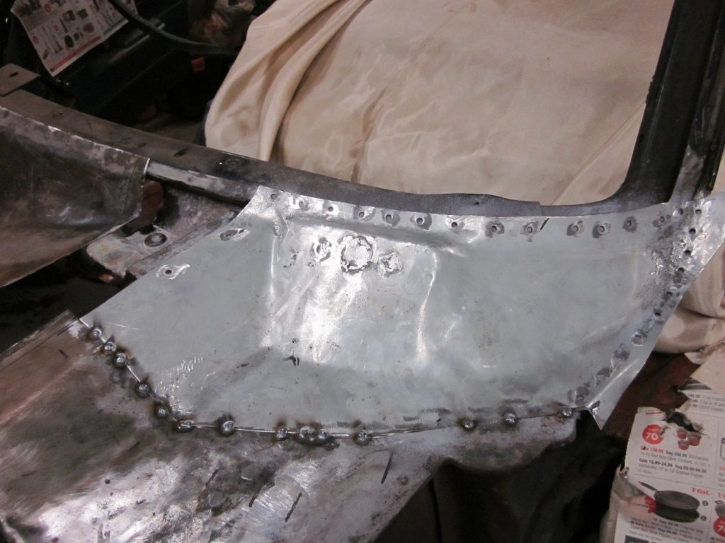

Fits pretty good making it easy to tack it up.

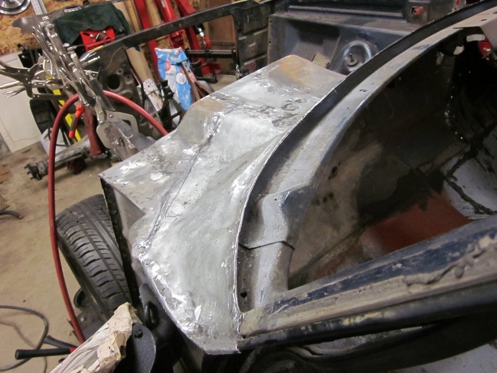

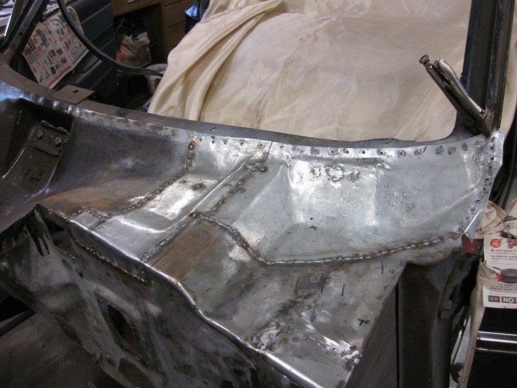

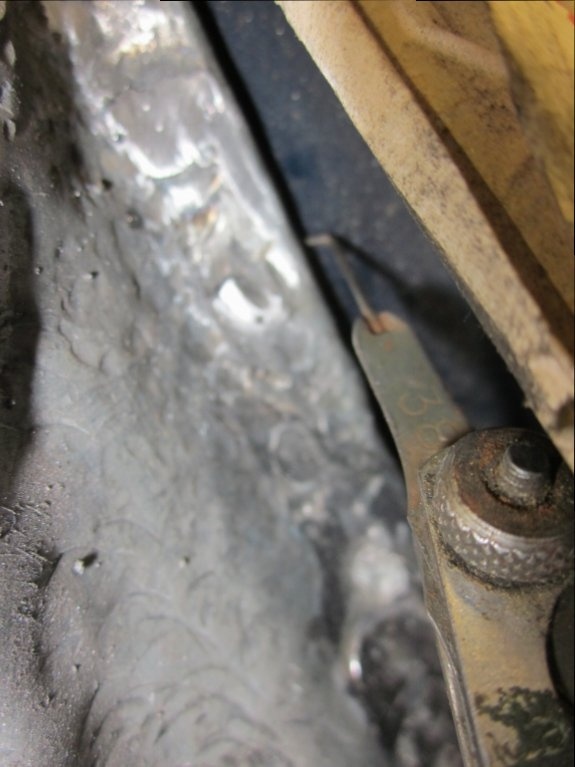

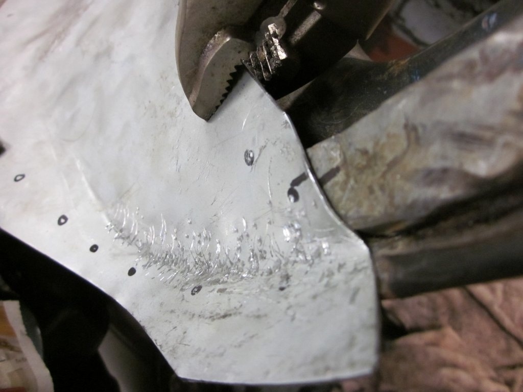

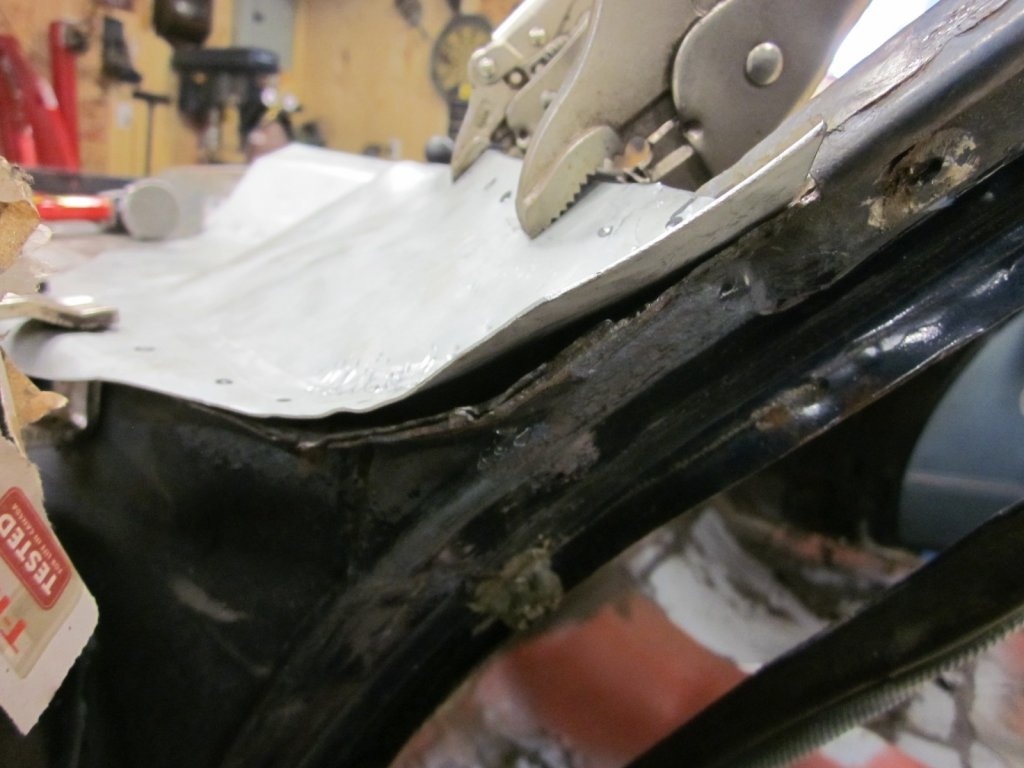

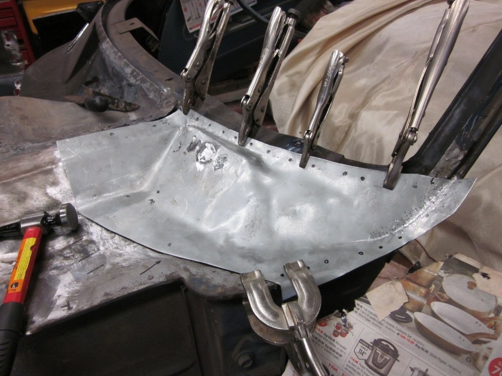

Looking for potential fit problems with the old cowl. The only contact point inside is between the top of the wiper pivot and the cowl. This will need some massaging. Otherwise, looks like it fits ok for now. I haven't welded to the windshield lip yet as I may need to tap it down a bit.
