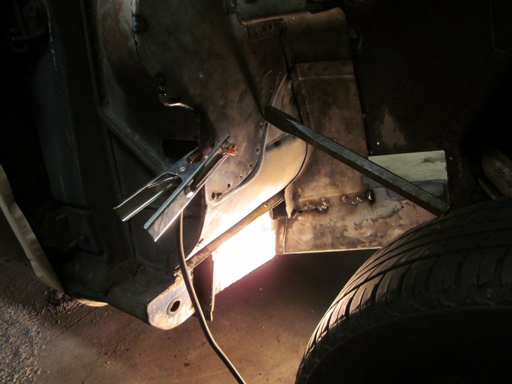

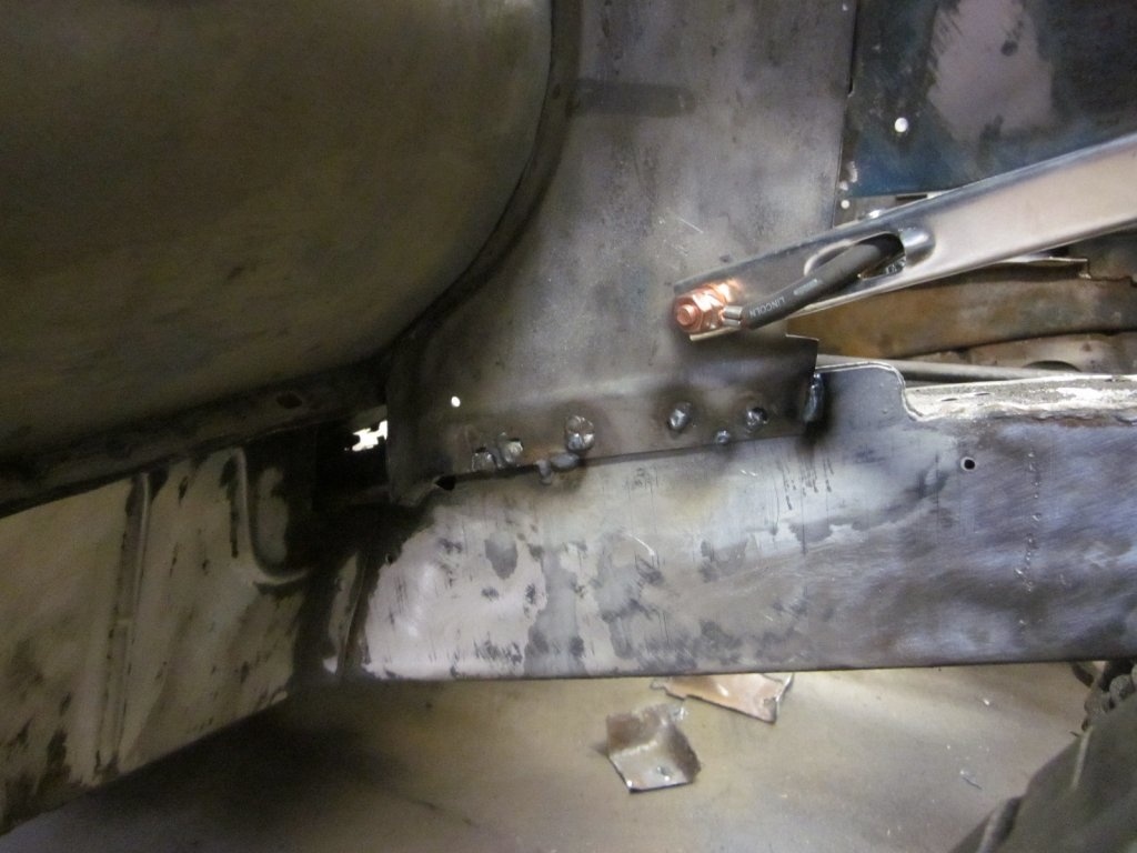

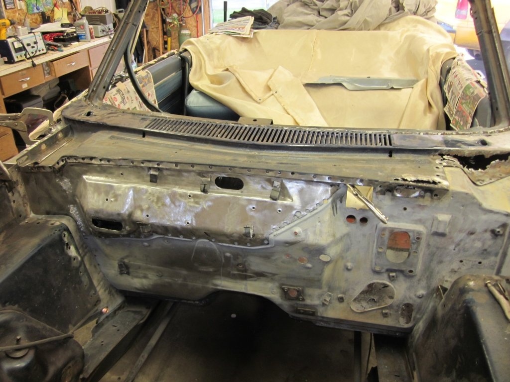

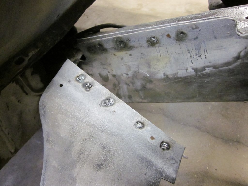

Welded the bracket between the frame and the floor. I thought it was 16ga and it pulled right off! oops I checked the thickness again and it was between 12 & 14ga. Adjusted the welder, drilled out the welds and started over. Much better this time.

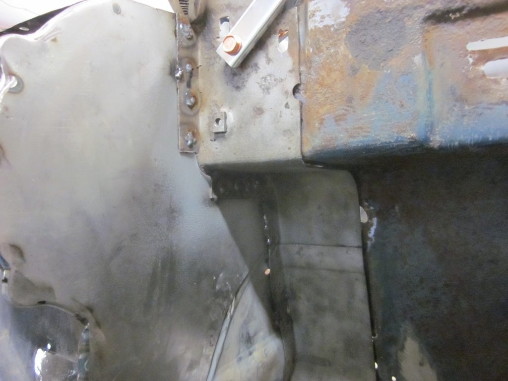

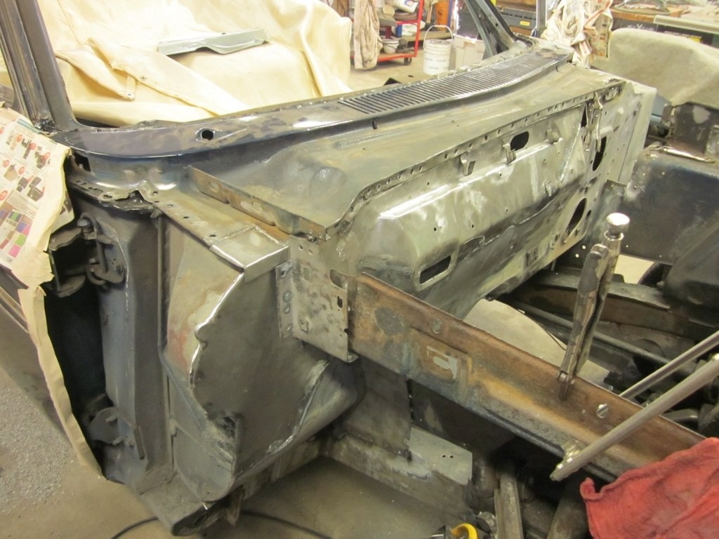

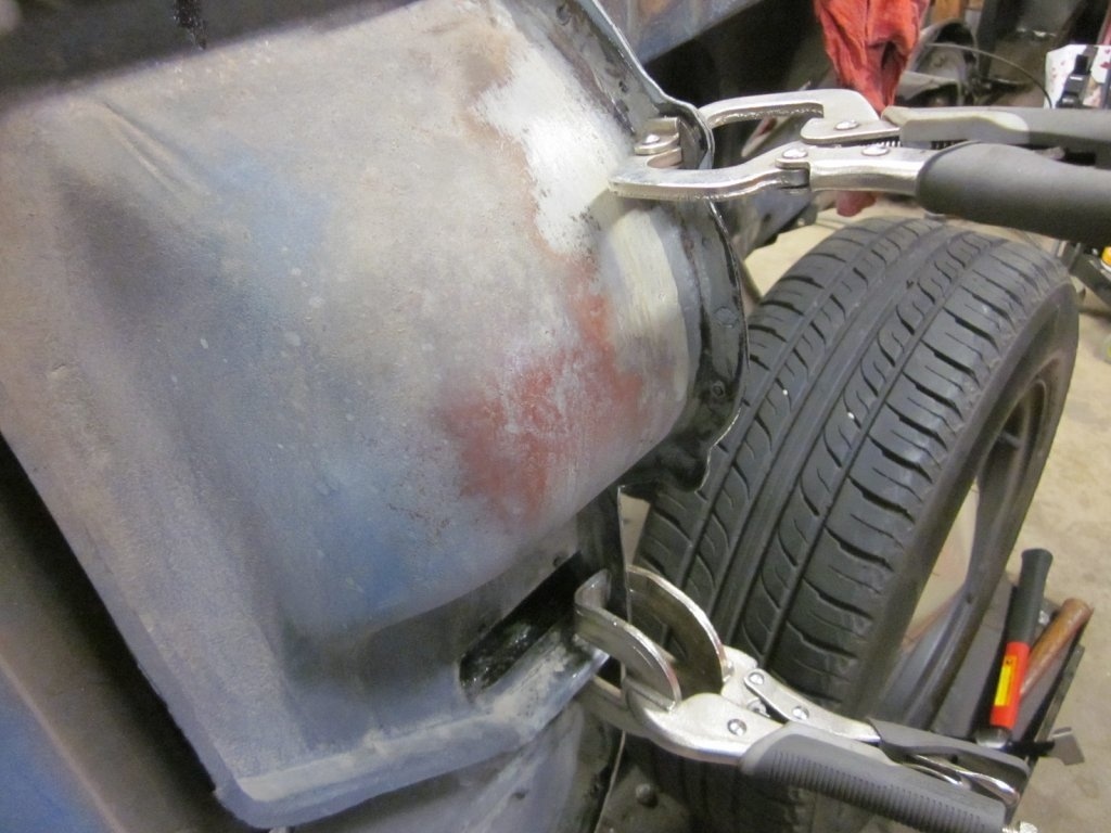

Checking the fit with the upper cowl before I start welding.

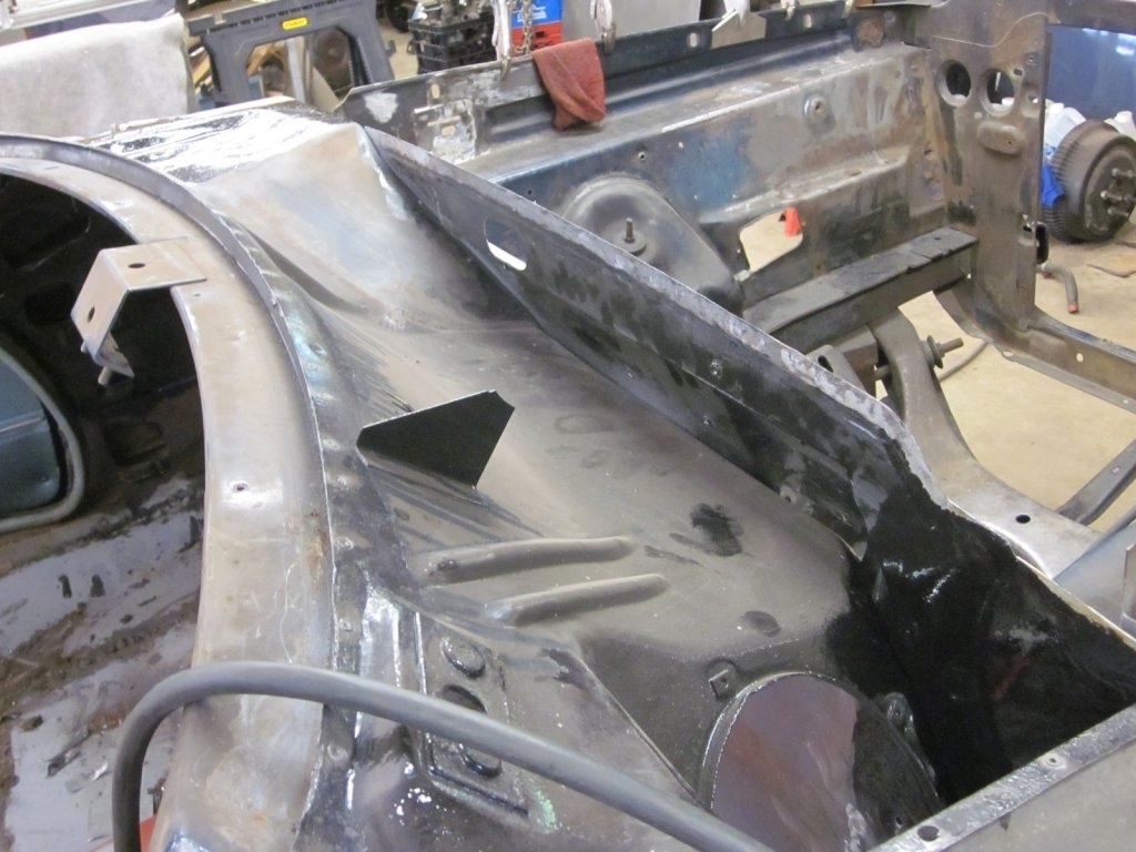

Starting to look like a car again...sort of. Holiday tomorrow, so I hope to finish this up.

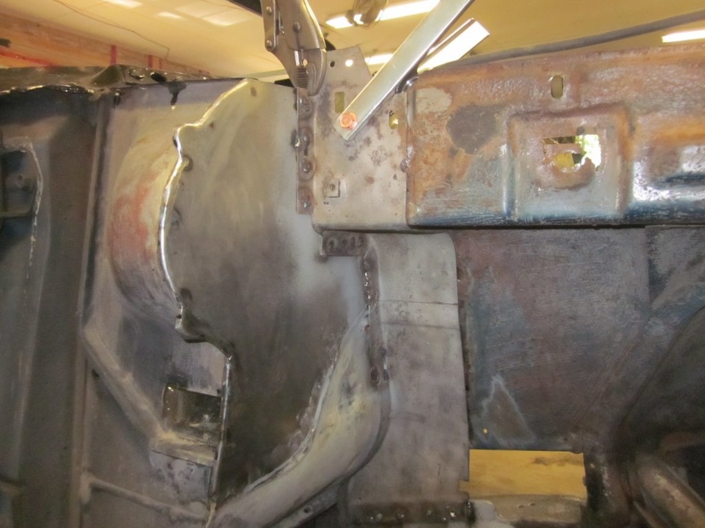

Still managed some time to sew this 64 back together, one more step forward.

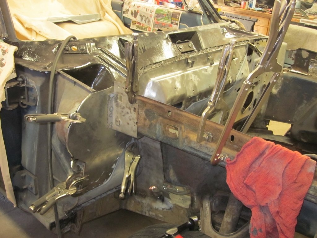

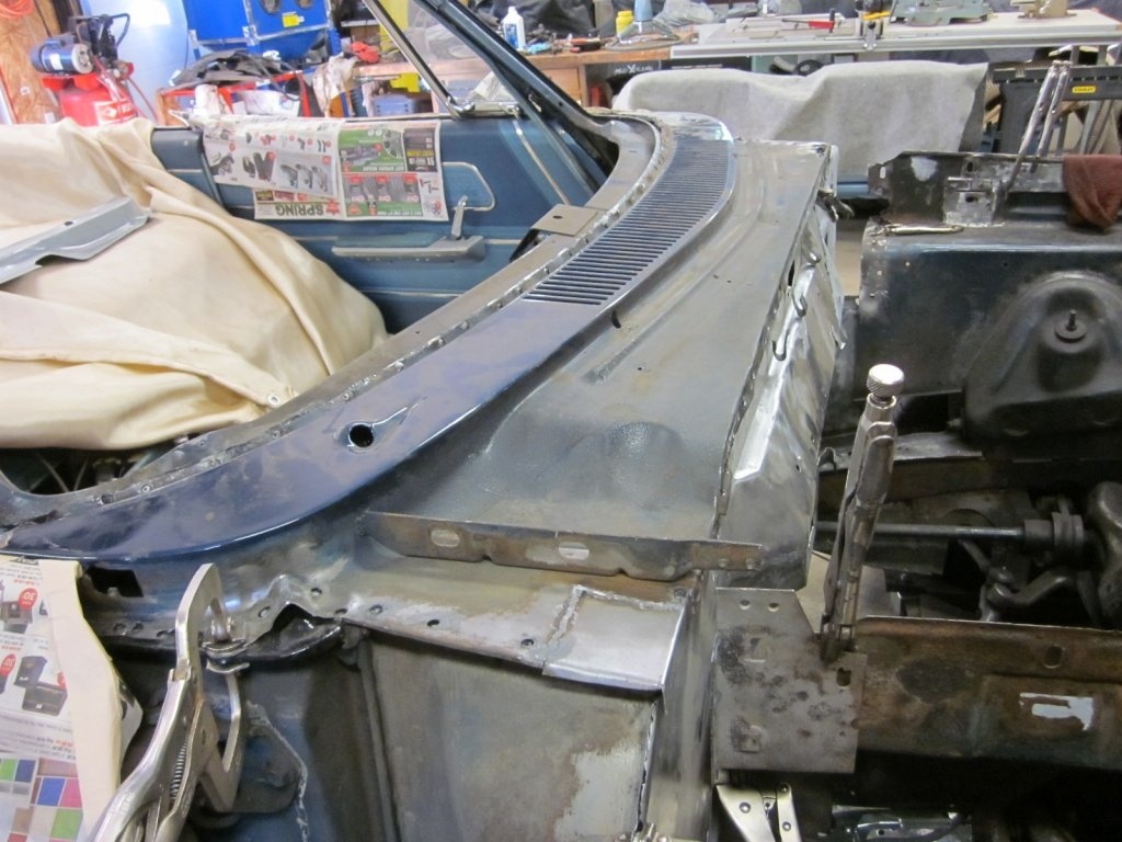

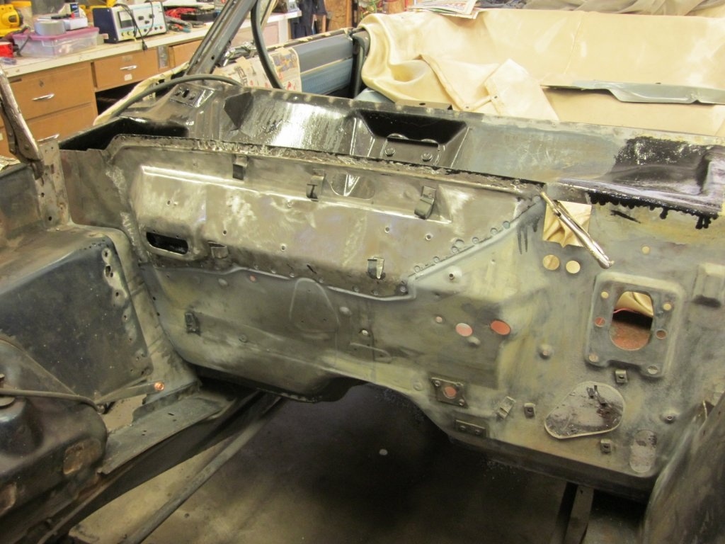

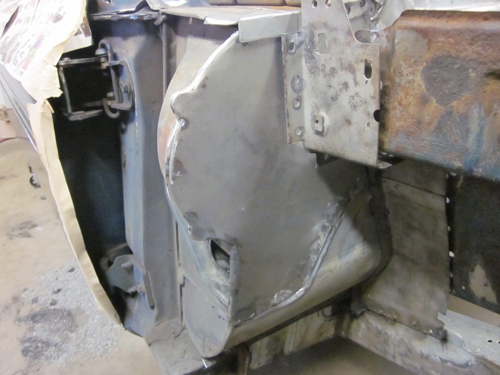

Put the cowl on to line up the air box before welding.

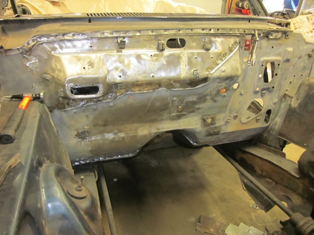

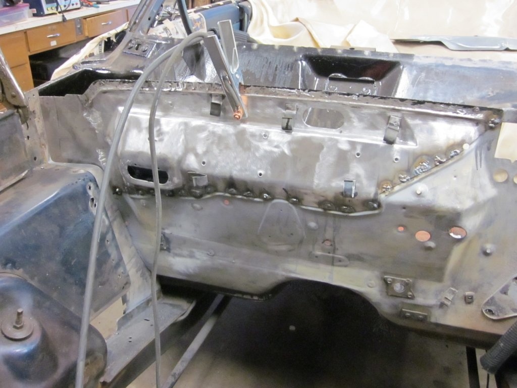

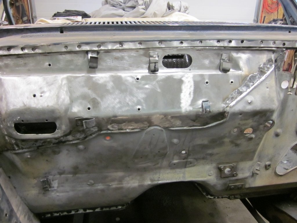

Cleaned up the welds.
Firewall and air box are one again. Turned out pretty good I think. Not too bad for an amateur.

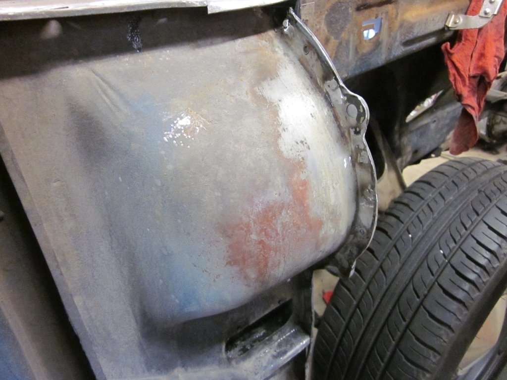

The new splash guard from AMD looks a little better that the original! Can't figure out how it fits though. The holes don't seem to line up. I hope I don't have to fill these in too.
Looks great! The cowl/firewall areas are so complicated with how they are designed and assembled. Keep up the great work!!!
I'm inspired ! Will tackle my cowl when the time comes ! Thanks for the photos and all

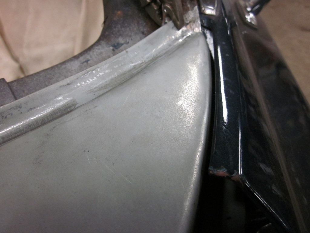

Before you fire up the electric glue gun on the cowl, make sure your windshield fits properly. And maybe check the fit of the hood and fenders too before you pull the trigger.

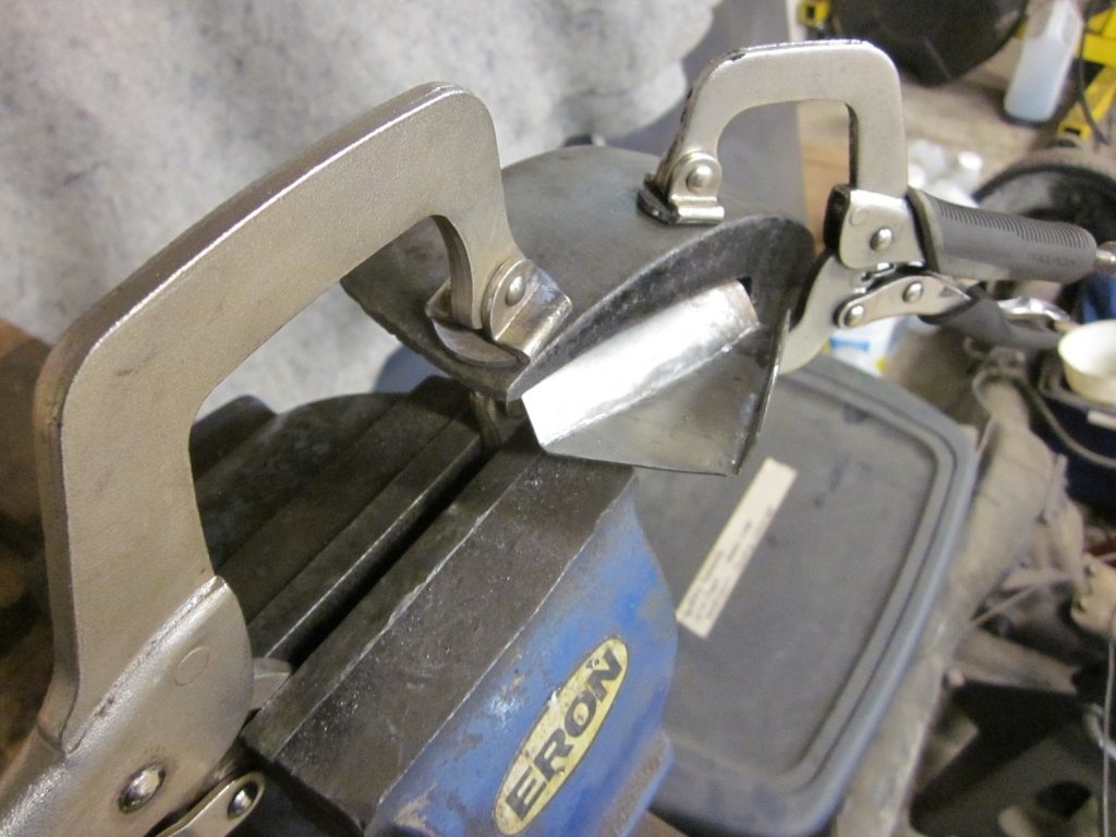

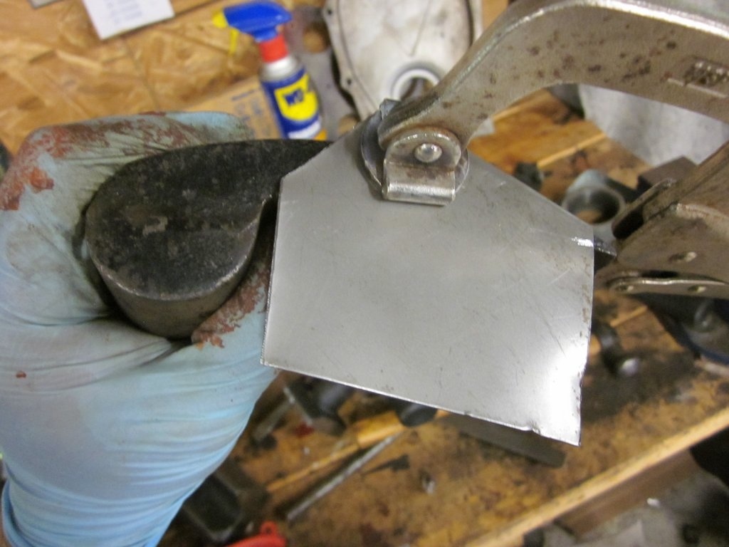

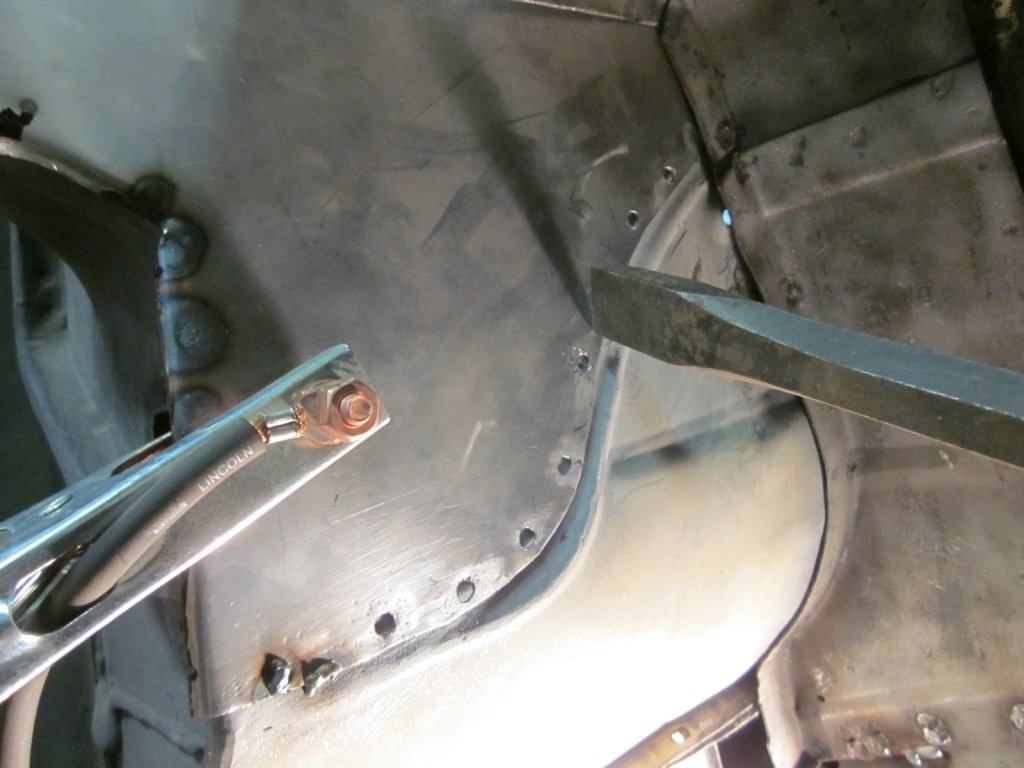

Tacked the bracket in place, then welded it up.

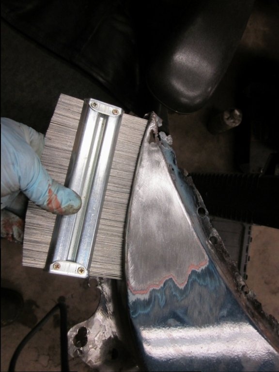

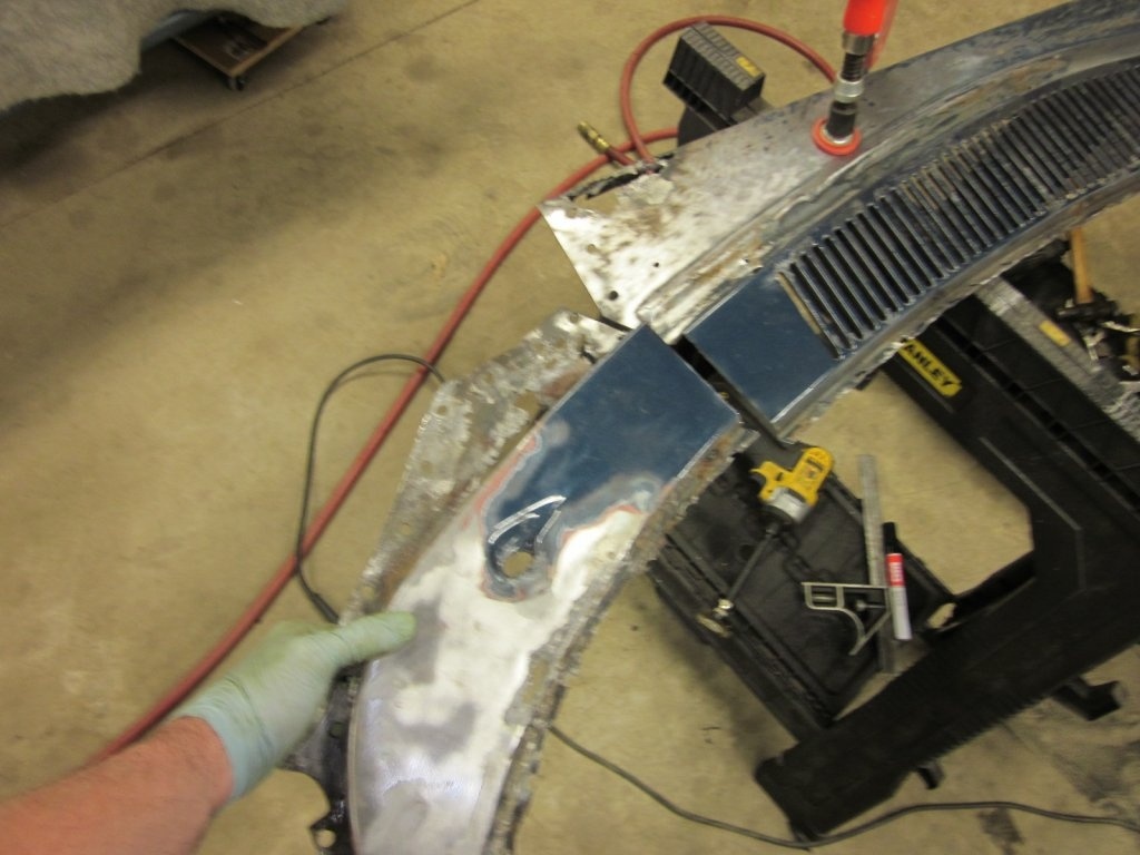

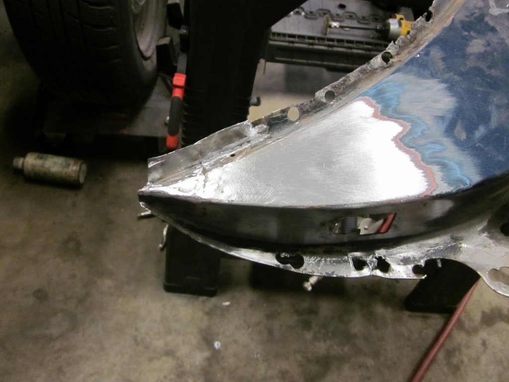

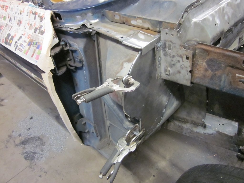

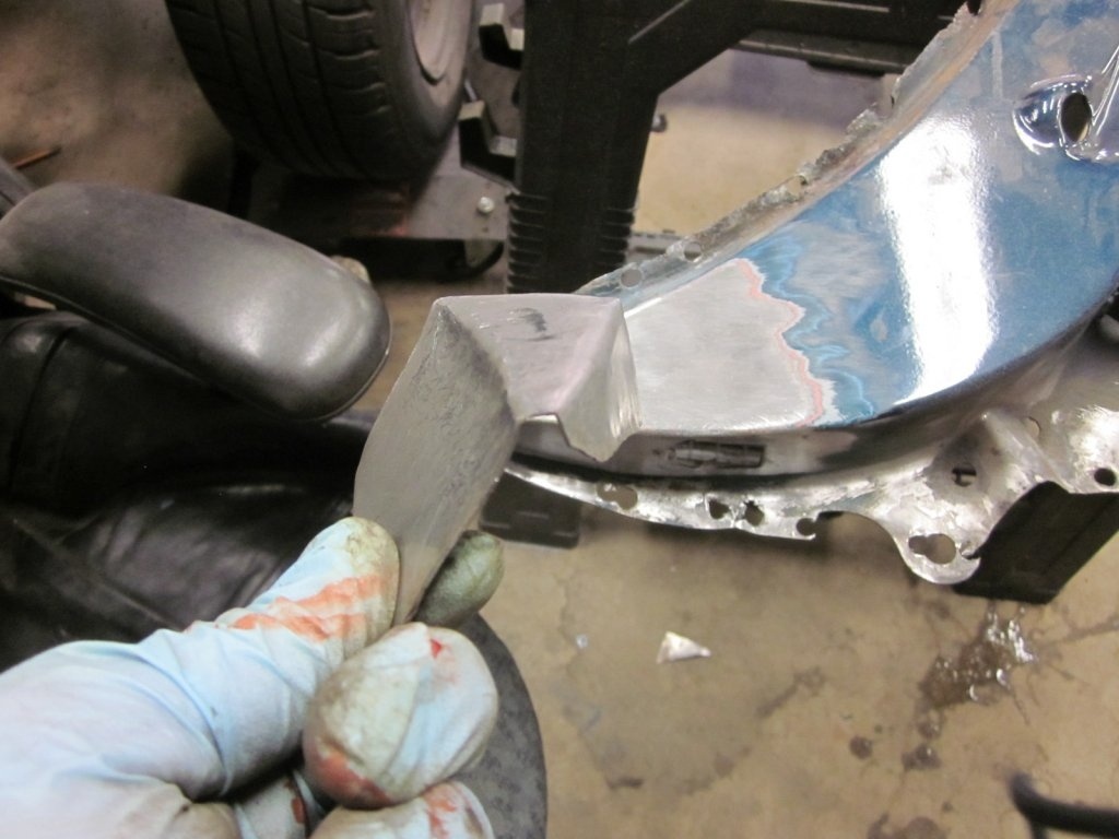

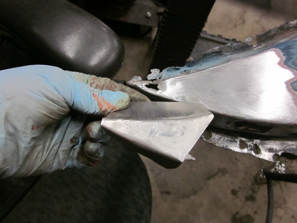

checking the curve on the cowl. No patch available for the right side, so i'll have to try to fab one.

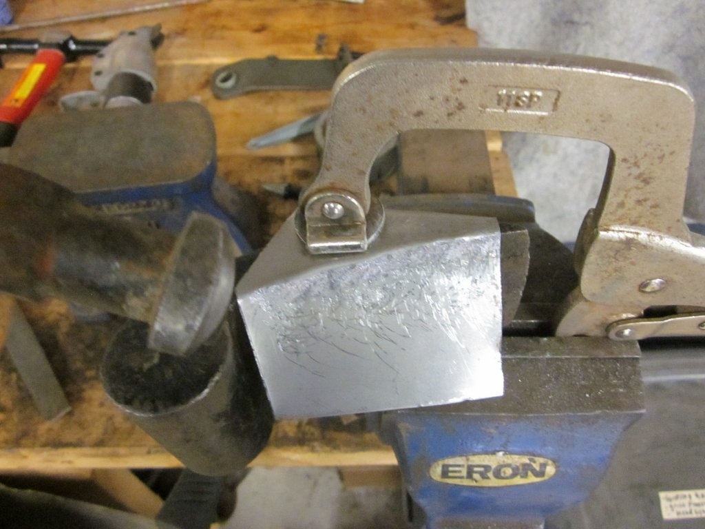

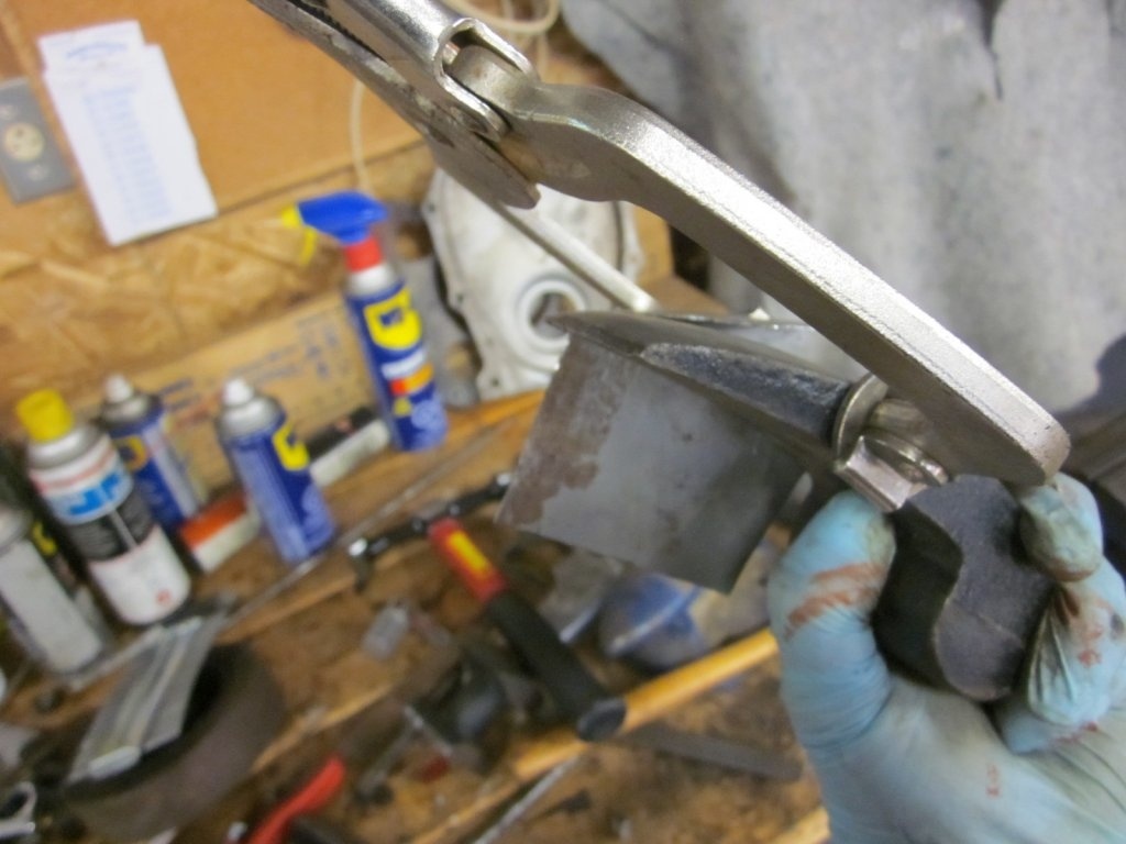

using 20ga, a little easier to work with than 18ga.
this dolly's curve is pretty close to what I need.

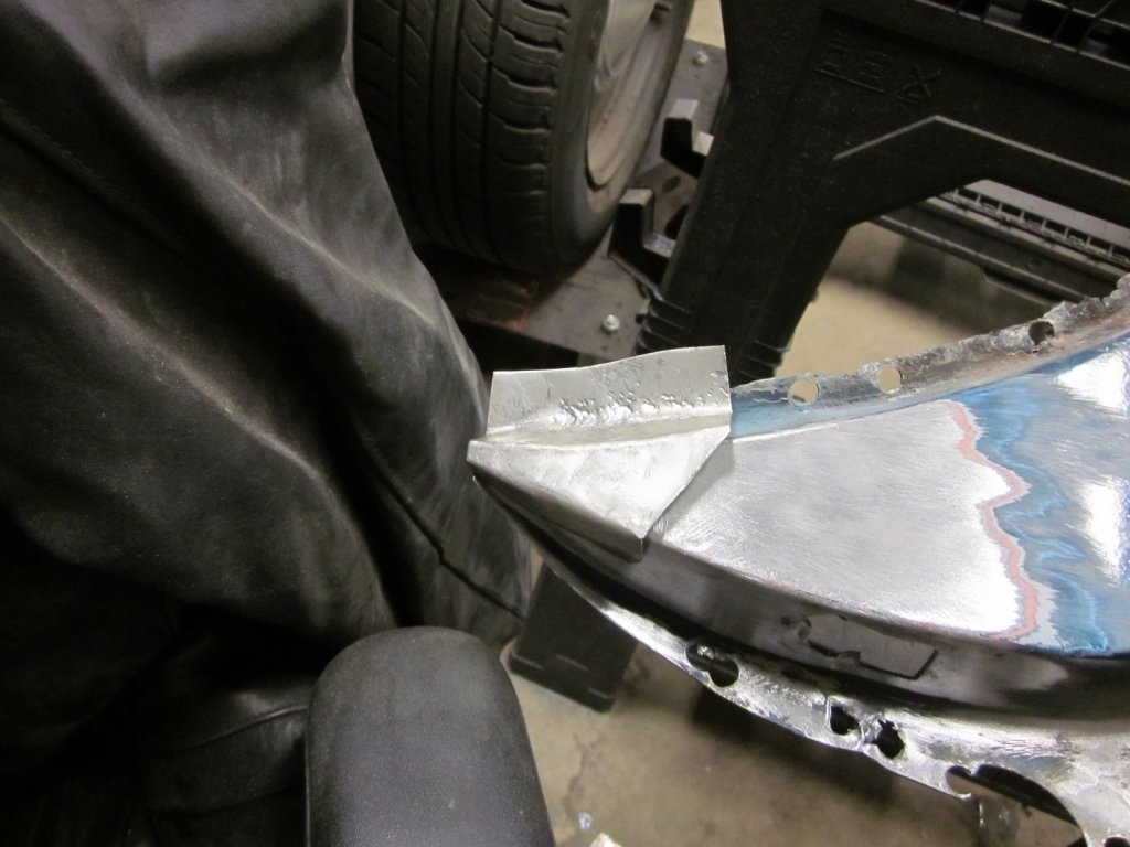

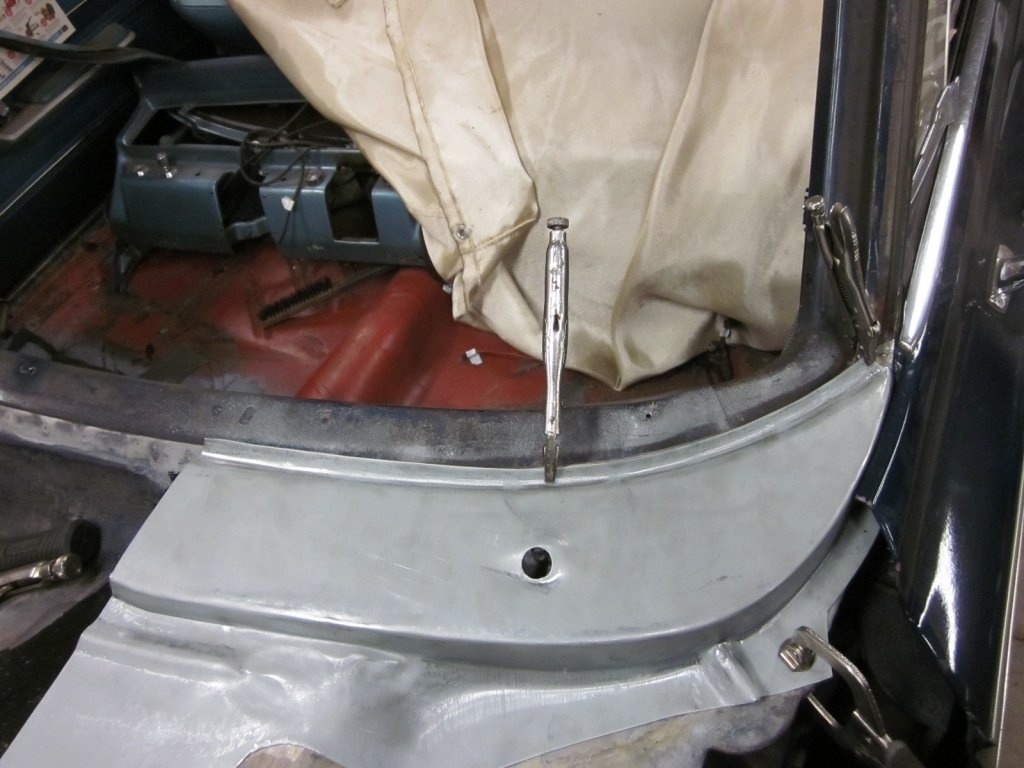

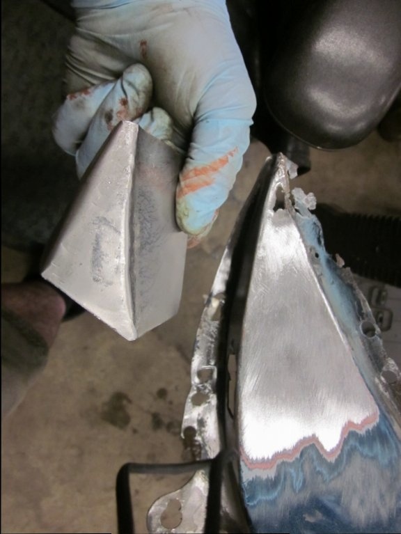

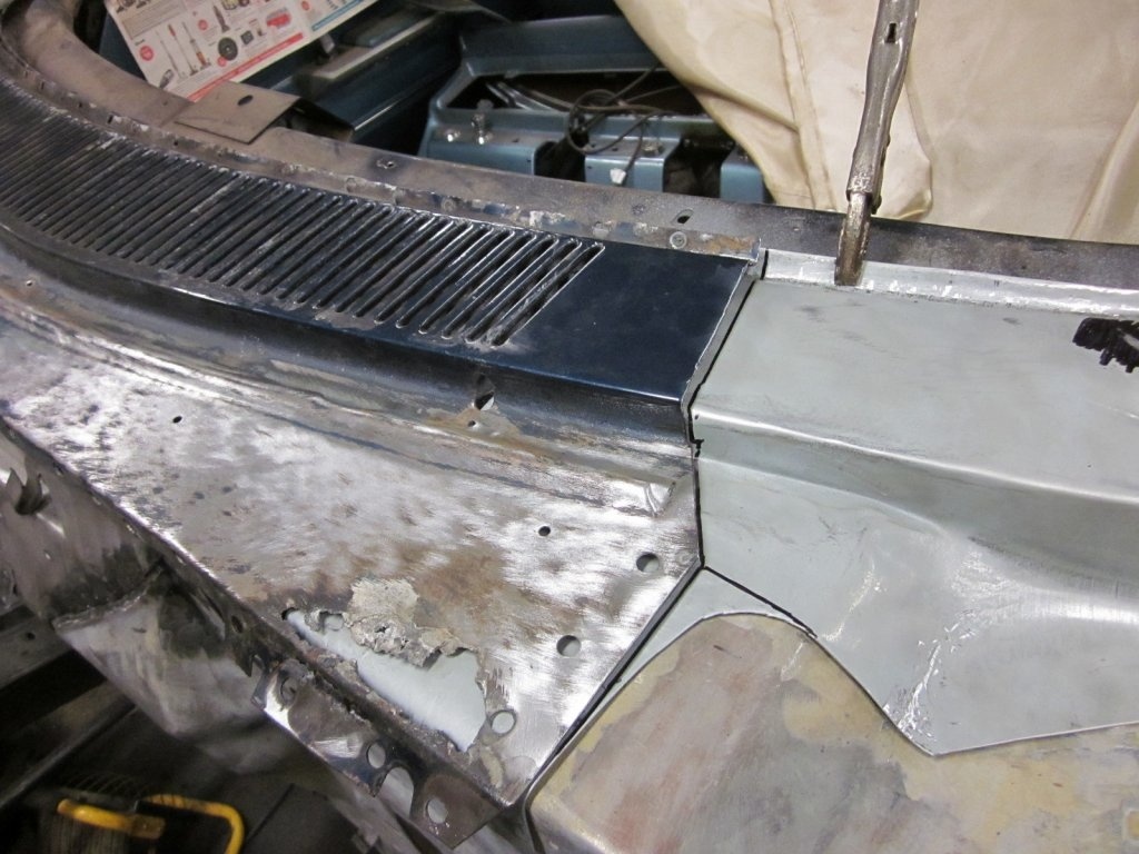

Decided to try patching the right side instead of cutting the whole corner out.

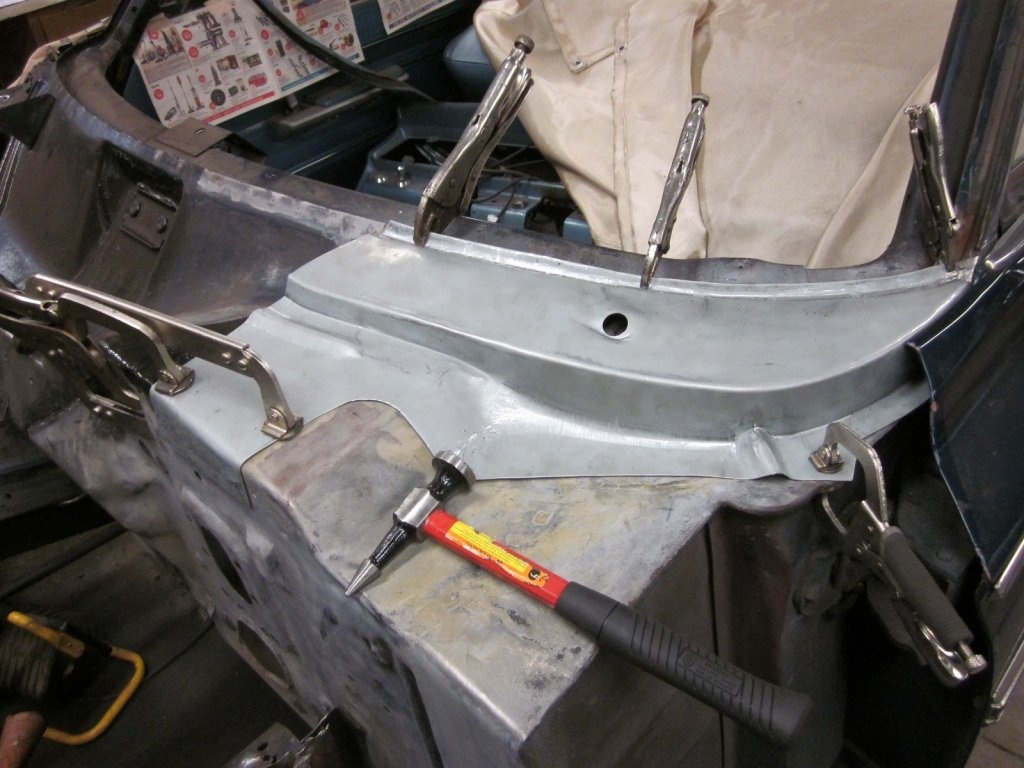

Now for the left side...the sherman patch is rough but trying to fit it anyway.

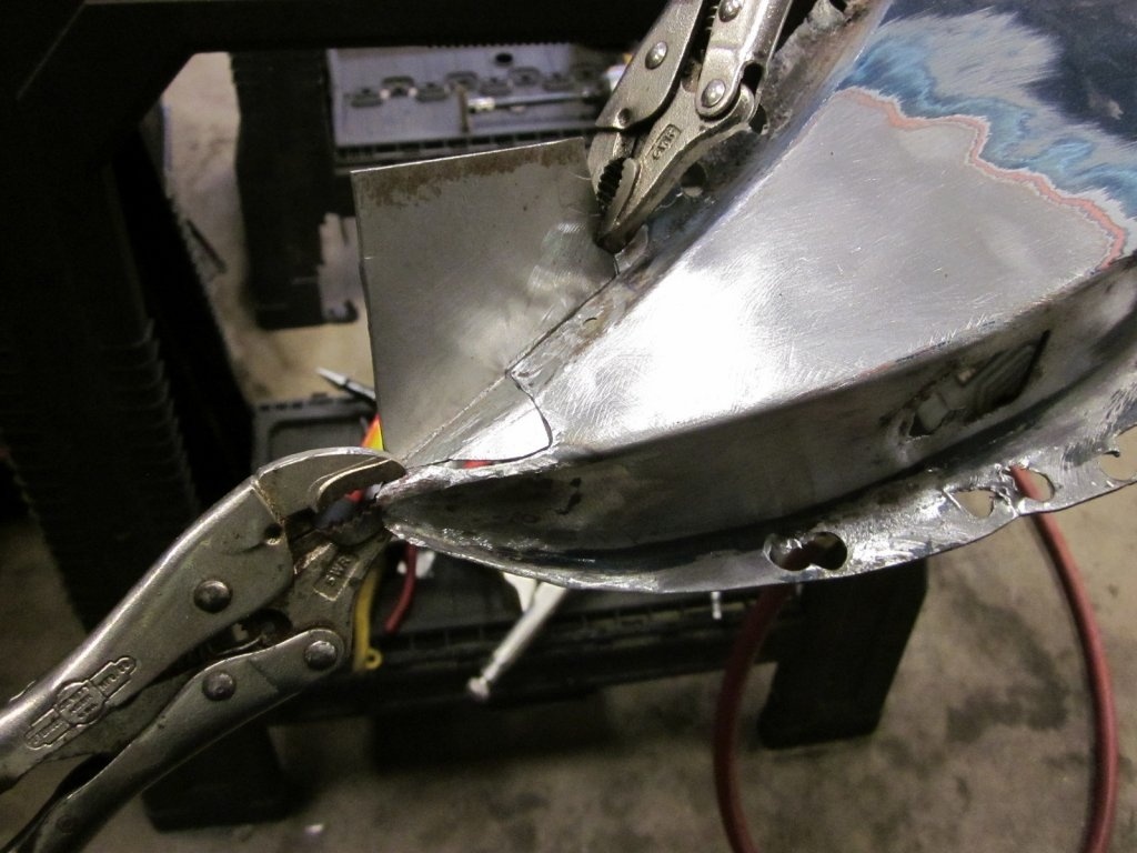

Checking the gaps.

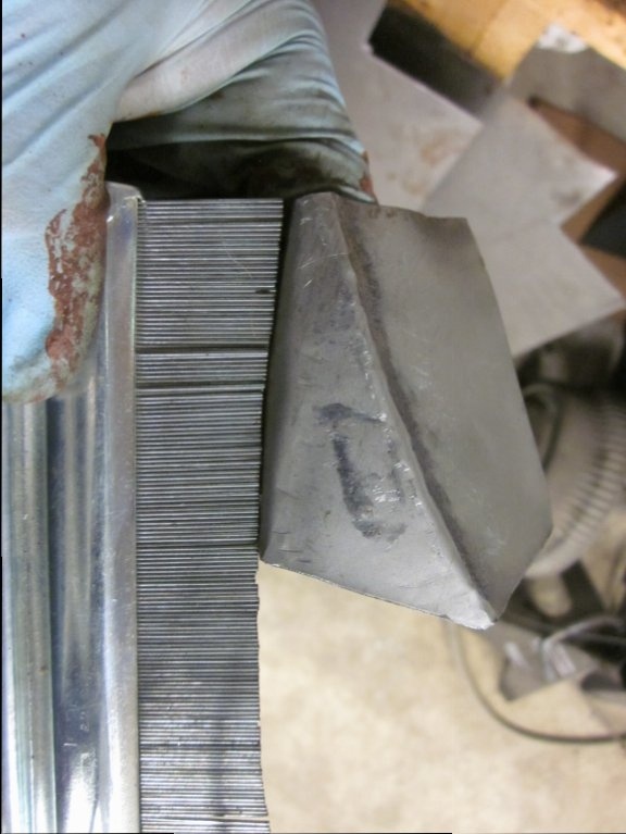

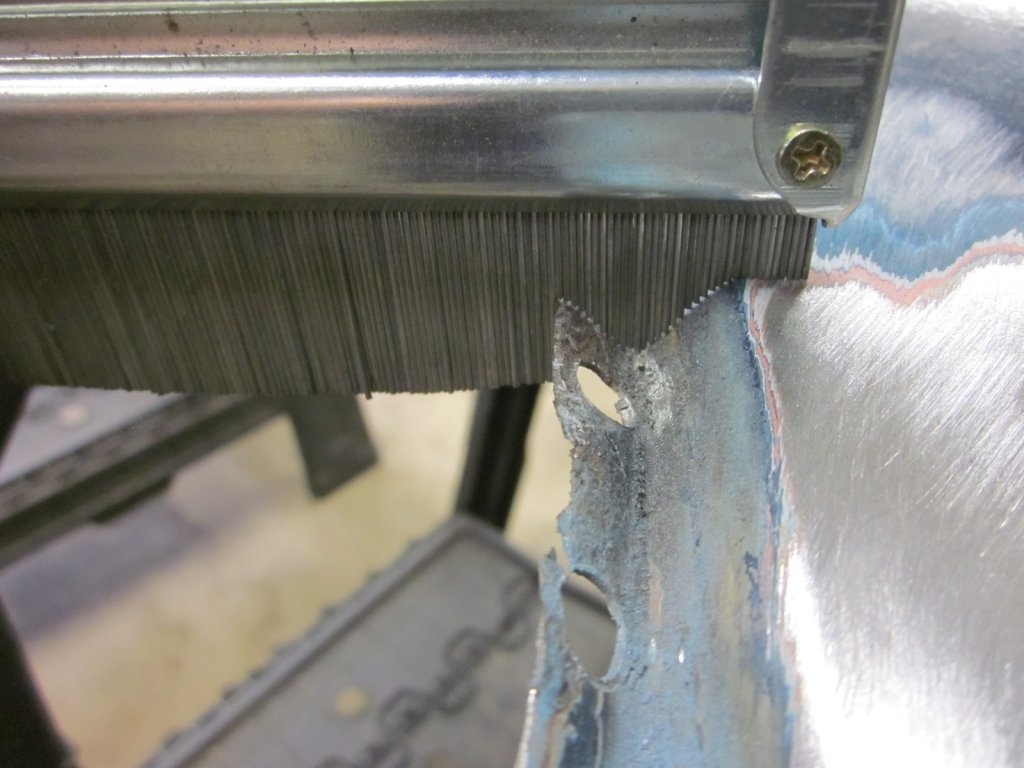

Stealing an idea from Crumley...looking for high spots with a magic marker and file. Pretty rough pressing from Sherman but still better than the rusty one I have. Some hammer and dolly work might help here.

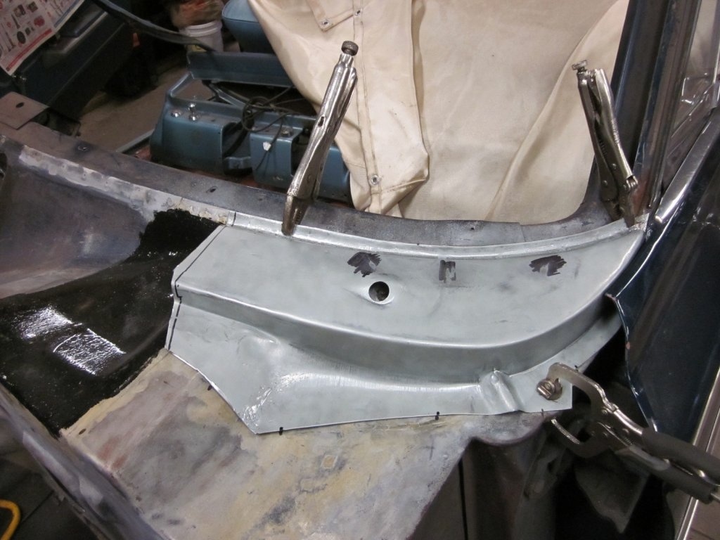

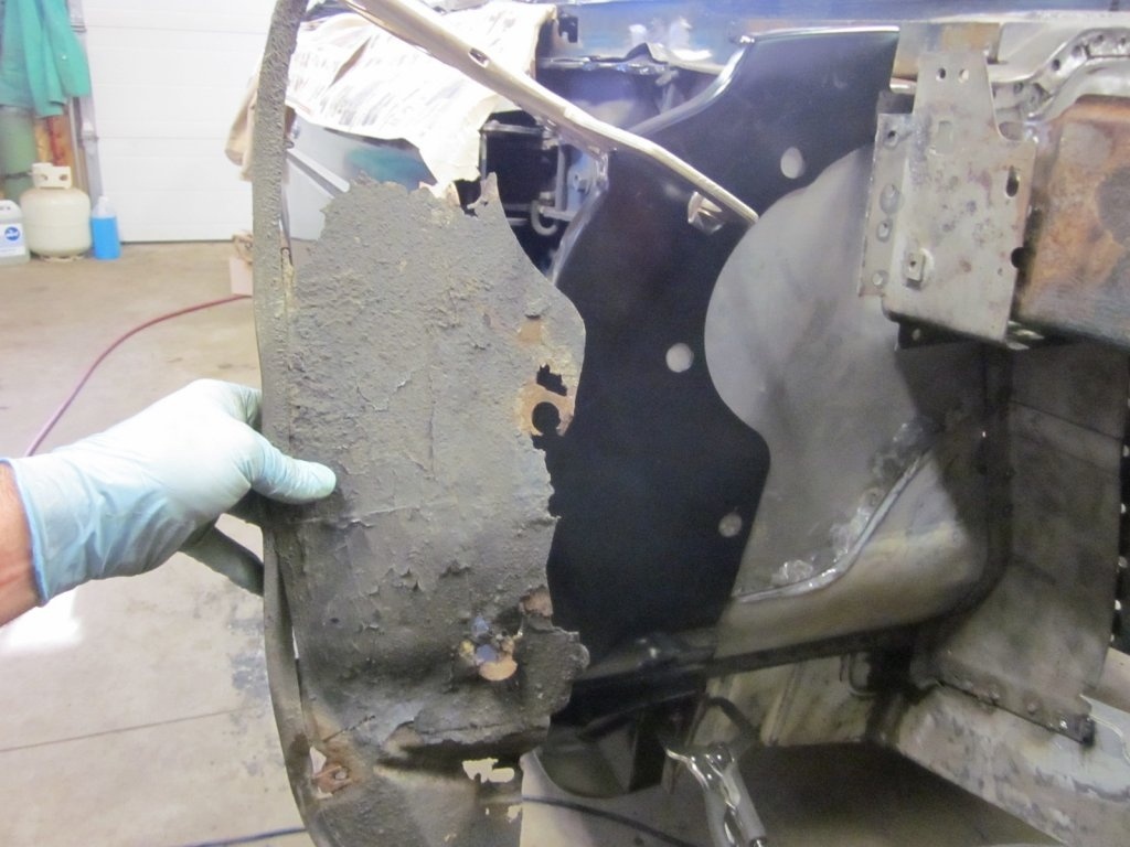

Kills me to have to do it...but here goes nothing. Time to cut out the cancer.
Marking out a line to cut. I've learned to cut it wide and cut again and again, fine tuning to a tight fit. I find it welds better.
