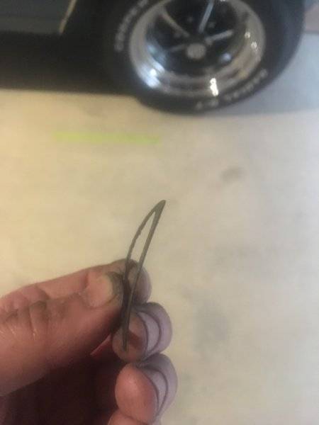

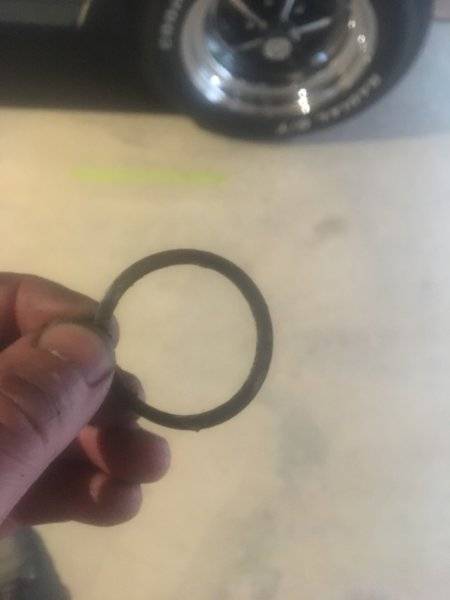

I took my column apart for paint. There’s a large bent/pressure washer of some kind that’s inside the shift housing on an automatic on the column. It was just laying loose inside when I dissembled everything. Can someone post a parts diagram please ?
How about YOU post a picture of the washer.
As you can see, it has a bend to it. It’s a pressure washer of some kind. I know it goes in the housing with the gear shifter attached. I just don’t know where or how ? Roughly 2 to 2-1/2 inches.
65E58EBC-DA15-4A3A-AA35-FA60D61FA6F4.jpeg 07AB4DB2-88C9-408F-A5CB-2A9EAA786F63.jpeg
Yes, thank you my friend. I believe it’s purpose is to keep tension on the housing closest to the dash. But, that’s only a guess.

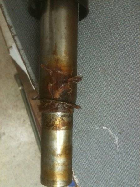

That photo of mine is from a 69 b body floor shift column
Yeah, probably serves same purpose. Floor shift models still have the 2 separate housings I believe. I think it creates tension between the two where they meet. To keep those ends from slipping around too much. But, I’m not a column expert.

Page 19-4 of the 70-71 Parts manual illustrations, shows a good assembly picture. It sits on the support bracket of the Jacket and covered by the first housing.

Thank you, sir. Very kind of you. I just now started putting it back together. That’s infact what I did. Thank you, for reassuring me. Cause, I still wasn’t 100% sure. I am now though.
Your welcome, I just took one apart from a 70B body last week, and the wave washer fell out. So I went through what your asking. :lol: Luckily the parts manual which is on line for free use has a good diagram to help with all parts of the reassembly.
